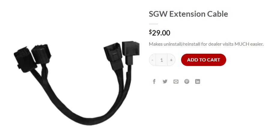

I should have bought those extension cables. My knuckles hate me every time I take it out when headed to the dealership.
What cables are we talking about?
40,491
53,988
https://www.zautomotive.com/product/z_sgw_ext/
That one - so if you access the security gateway cables to put in a bypass or a tazer, those cables extend the SGW connections down to within easy reach.
If you use a tazer or even if you use the bypass cable to use JSCAN or AlfaOBD to monitor the truck or make changes to settings, get that cable set. It's worth every penny.
