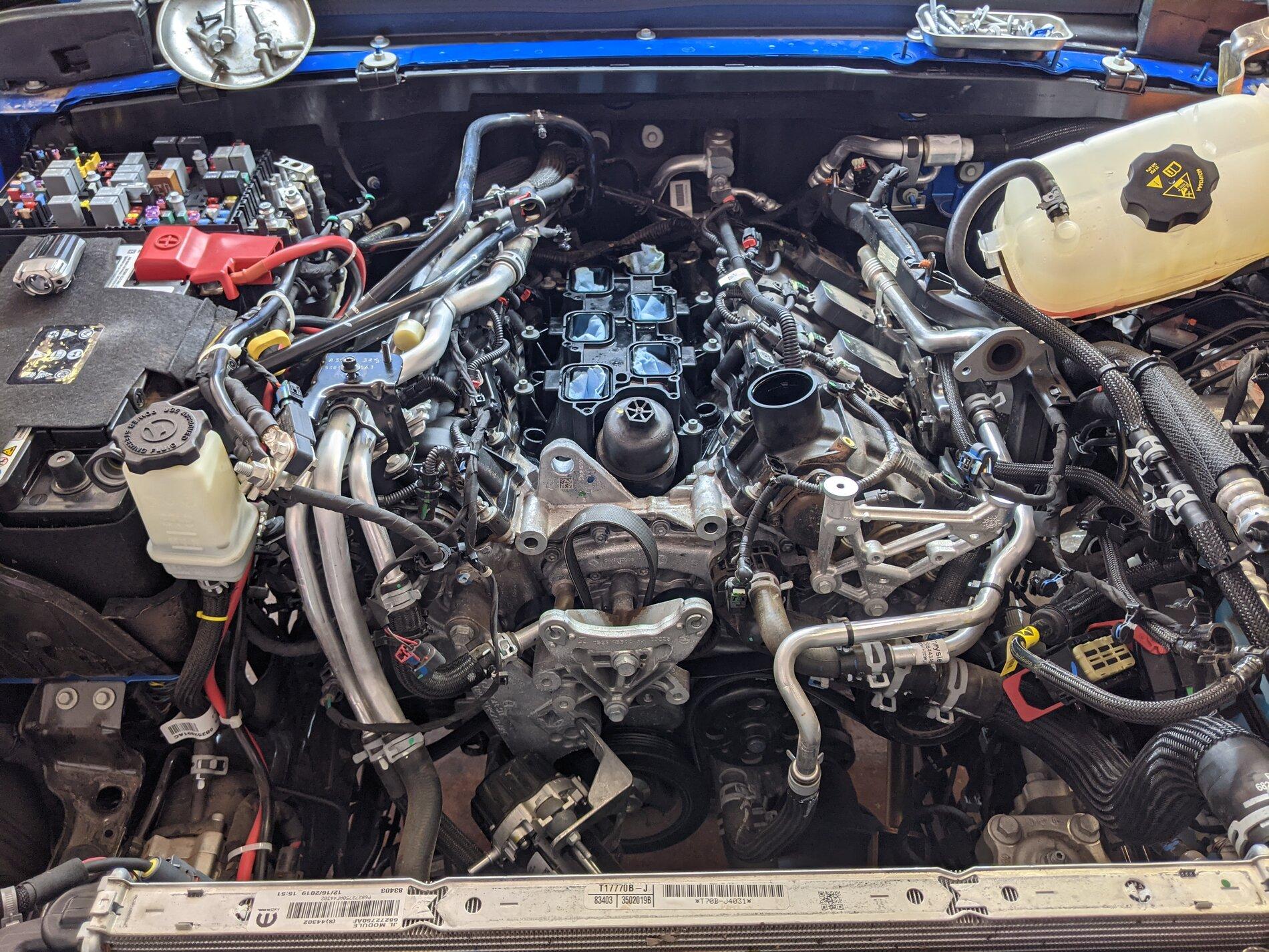

Is getting real now
Jeep Gladiator ΚΑΣΣΑΝΔΡΑ (Kassandra) -  Hydro Blue and Supercharged PXL_20210112_181248613
Jeep Gladiator ΚΑΣΣΑΝΔΡΑ (Kassandra) -  Hydro Blue and Supercharged PXL_20210112_212830738

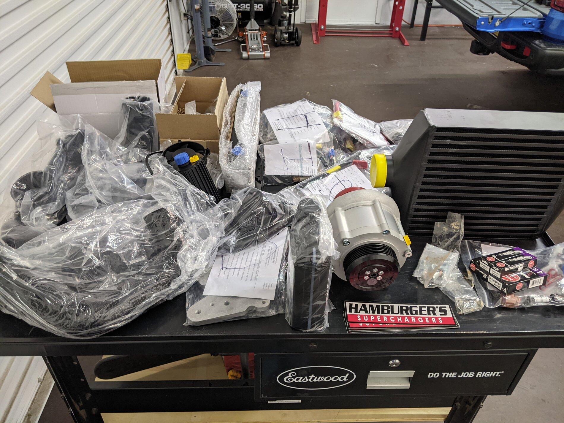

The intake must come off to access the fuel rail for bigger injectors and colder plugs. A few other components like intake o rings have to be upgraded to deal with intake pressure

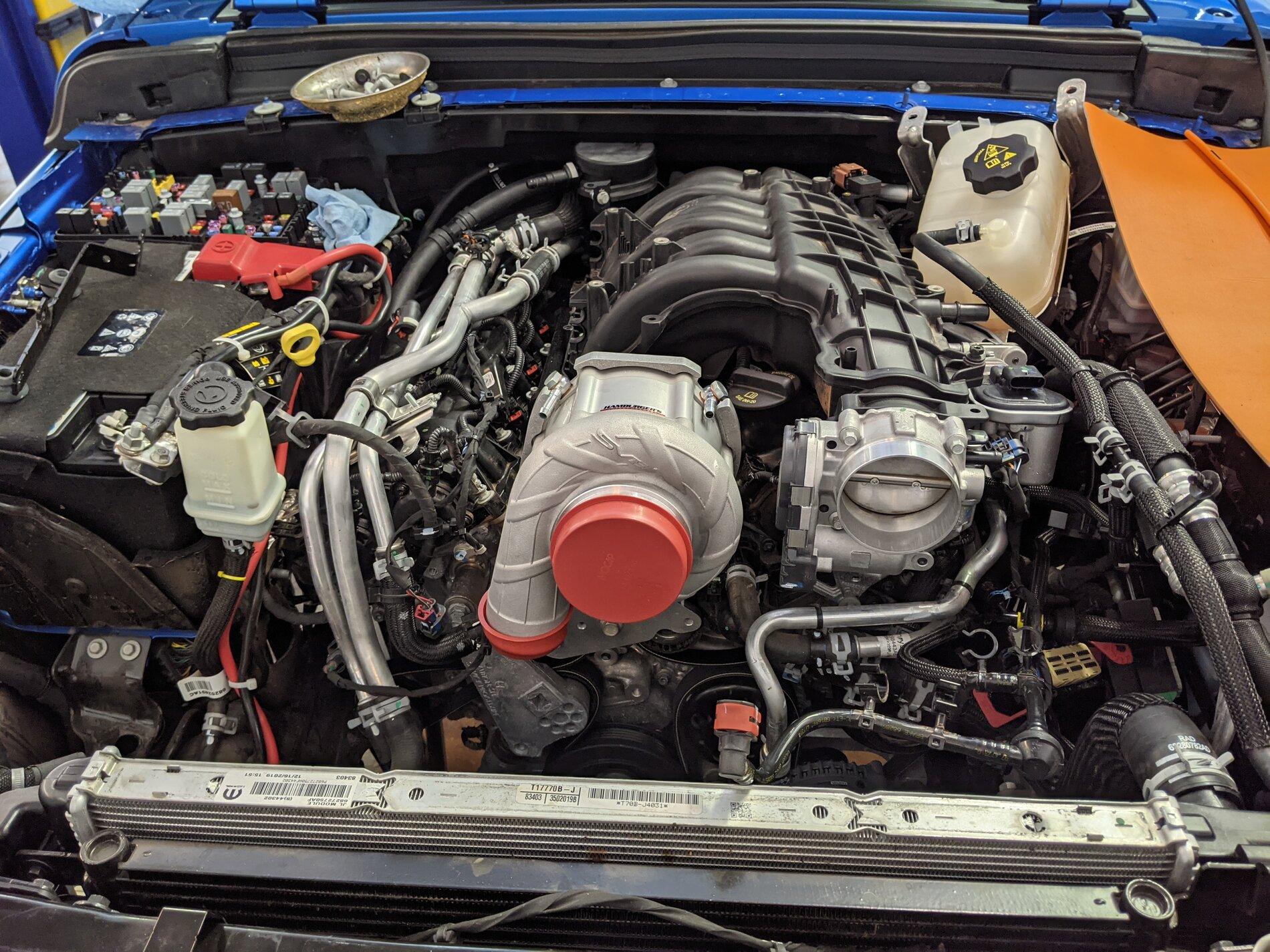

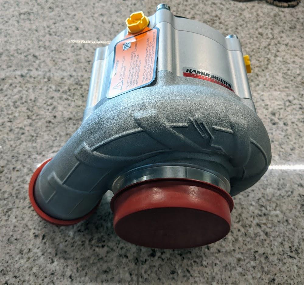

It's starting to come back together. The alternator gets mounted lower, just above the drive side upper control arm. A machined aluminum bracket hold the supercharger and alternator in place. The guys at Hamburgers really did their work well... some of the tolerances between moving components are tight! It looks factory.

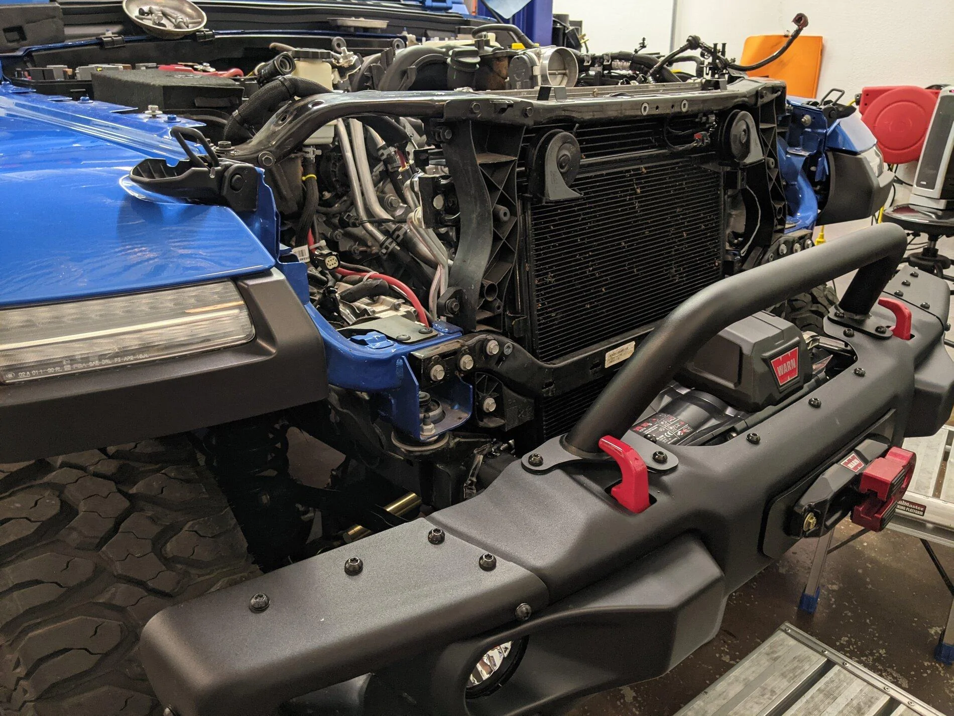

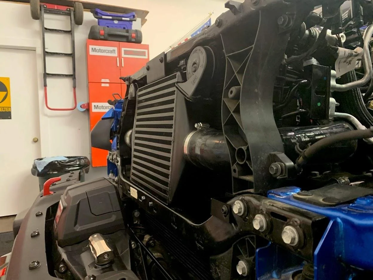

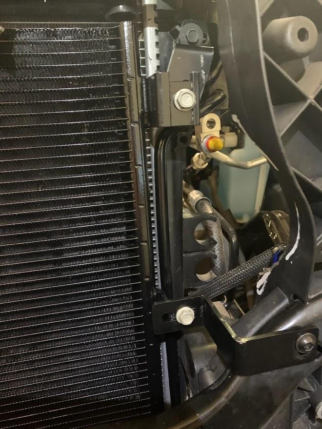

Things are coming along nicely. This is the second one of these we have installed and there have been changes. The AC condenser now gets moved back about an inch closer to the radiator, freeing up a ton of room for the charge tubes. The directions say you can trim the condenser mounting tabs with it in the truck, but we opted to capture the R1234YF and trim the condenser on the bench. It got dressed and touched up with some paint and looks perfect.
Jeep Gladiator ΚΑΣΣΑΝΔΡΑ (Kassandra) -  Hydro Blue and Supercharged IMG_20210116_152756
The intercooler...
Jeep Gladiator ΚΑΣΣΑΝΔΡΑ (Kassandra) -  Hydro Blue and Supercharged IMG_20210116_153307
mocking up all of the tubes.

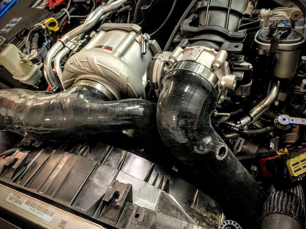

The Install is complete and the finishing touches have been applied. The Jeep drives great. It is smooth and fast. The SC is silent except for a slight whine you can hear driving next to walls and parked cars, but even then you have to listen for it. Acceleration is now effortless, shifting is smooth and tight. The best way to describe the experience is like driving a high-end luxury car, like a Mercedes or BMW, there is enough power that it never feels like the engine is struggling. And when you stomp on it, there is a whooosh, the front end of the truck surges up and it just goes. Very pleased
