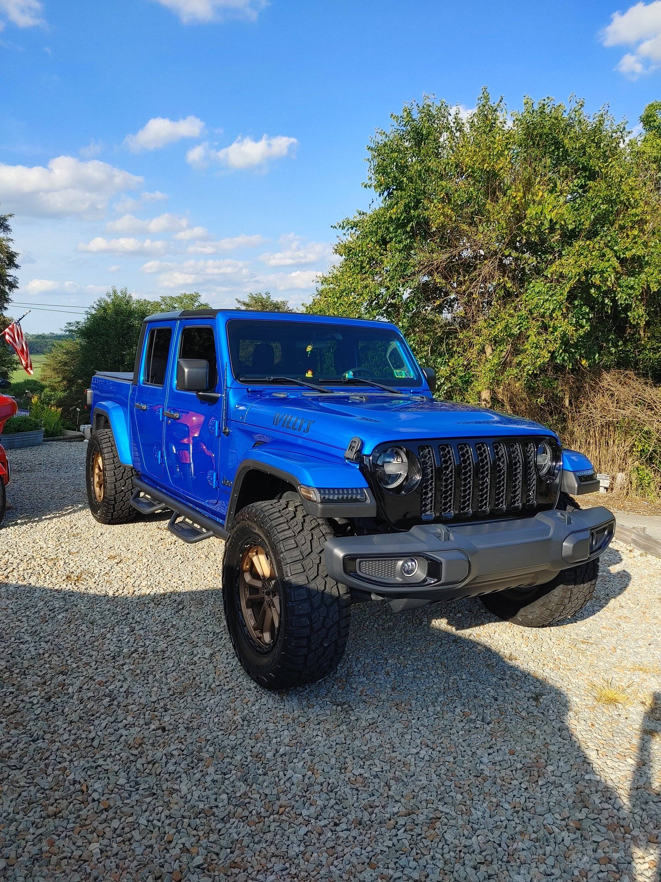

Just chatted with RC. I was right, it would sit 1" higher level than it does now. Not worth it in my opinion for the $1,300 it would be for the kit plus install and I'd also be wasting the 350 for the level kit and install of that. Guess this is as good as it gets.

Actually they said front 3.5 rear 1.5. I actually think this level has my front a little bit higher than the rear but it's not really noticeable. So that 3.5 would potentiality level it perfectly bit I still can't justify 1500ish for just another inch in height.
Thanks for the compliments. I love how it looks. Just thought if I could get a few more inches for little cash I'd do it. 1" isn't enough and I think 6 is too much for these, at least for me who doesn't leave pavement.
