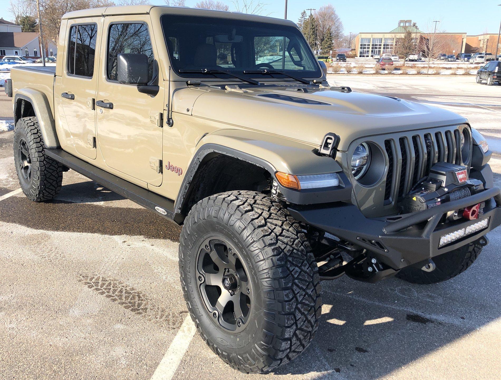

I know this is not the specific size you are asking about but thought it would give you a little bit of a reference of what a tall/thin set up looks like. I went with the Nitto Ridge Grapler 37x11:50 on a -1 offset 18" wheel (actual size is 36" x 11.2" at 30psi) Almost every time I have someone approach me about my truck they mention they like the look of the taller/skinny tire. I would think this group could post pics of both options for you and hopefully that helps make your decision. Good luck with your decision making.

Jeep Gladiator 10.5 vs. 12.5 wide tire IMG_2823
I have those in 35 12.5 on my Cummins great tire
