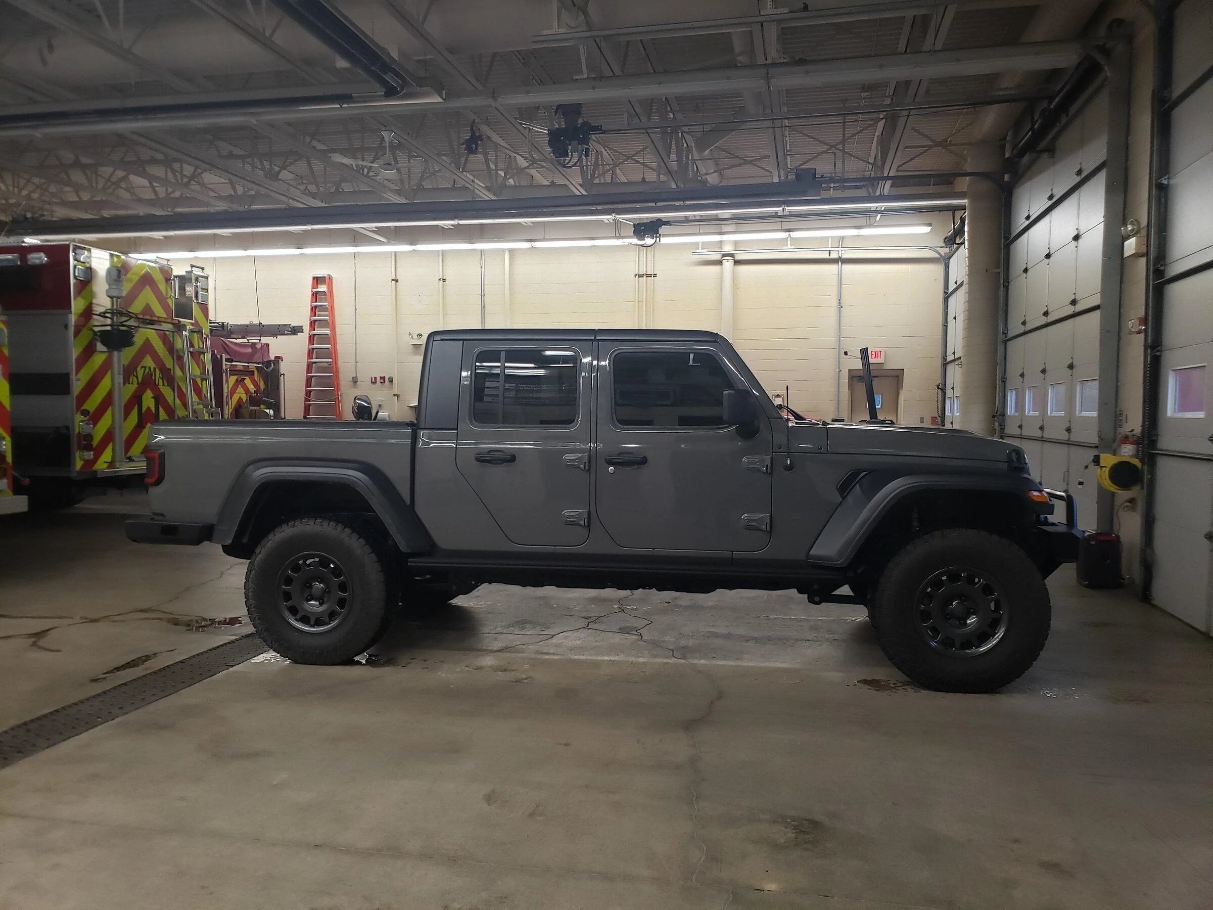

nuke

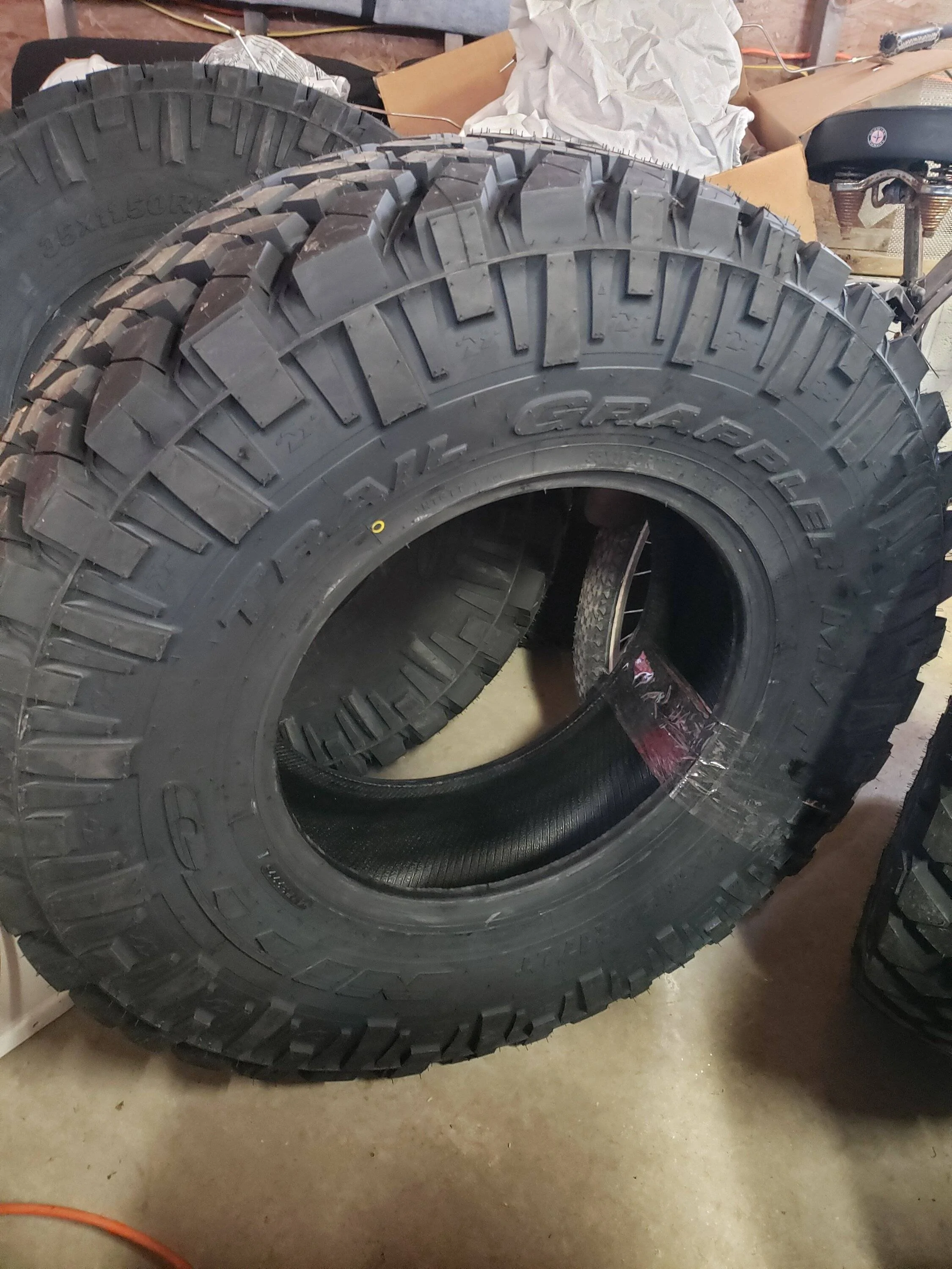

just ordered Nitto MT's in 35x11.5/17, C load, like 67# or so. Will fit my Willys wheels perfect, barely poked, plenty of performance. Adding 2"lift

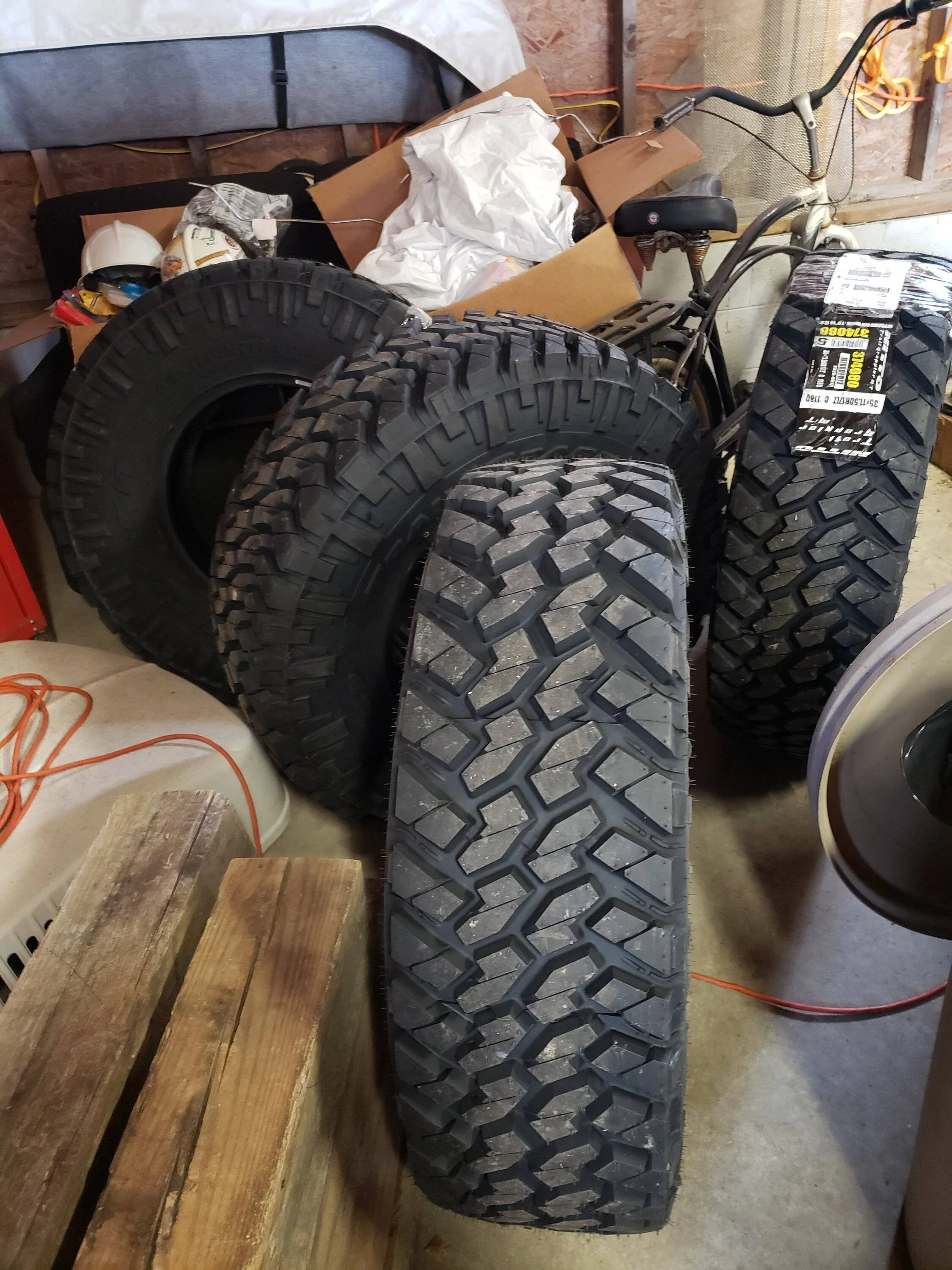

nuke
Got rhe tires today, they are gon a be excellent. Look about 1.5" wider than stock, of course thats unmounted. Lift kit shud be here in another day or so, pics to come

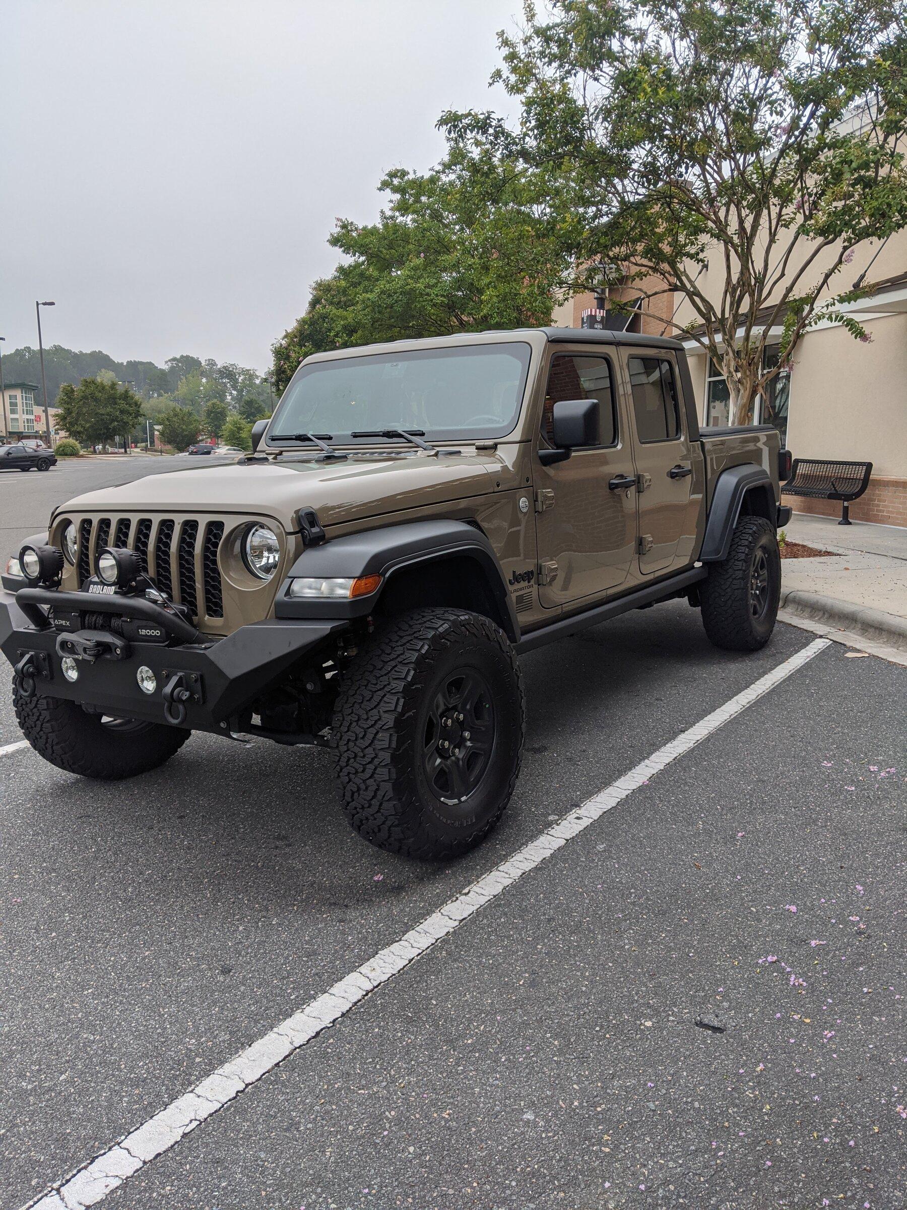

I'm running 37 12.5 17 Kanati Trail hogs on mine with stock wheels and they did great the last two weeks in the snow we got here. Did great on ice as well and in the rain. I ran 315 70 17 BFG KO2s before I ran the 37's and had no issue with those either. I like bigger beefier tire personally and love the stock wheels, but I will probably be switching them out soon.
37 12.5 17
315 70 17

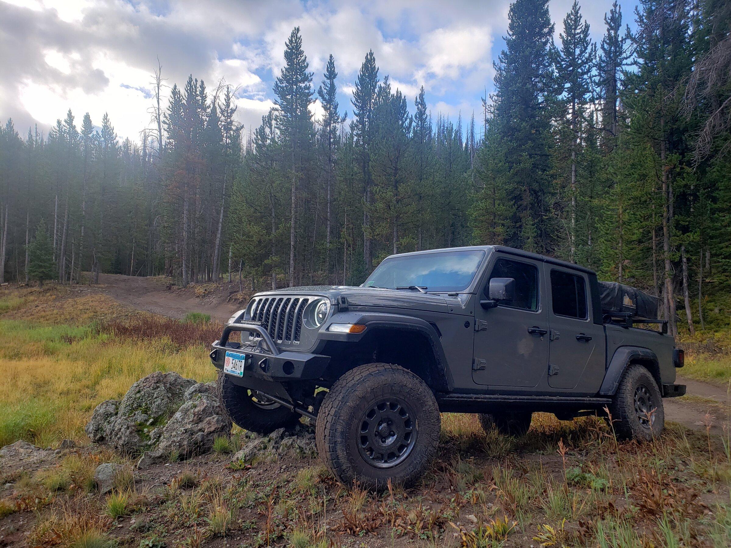

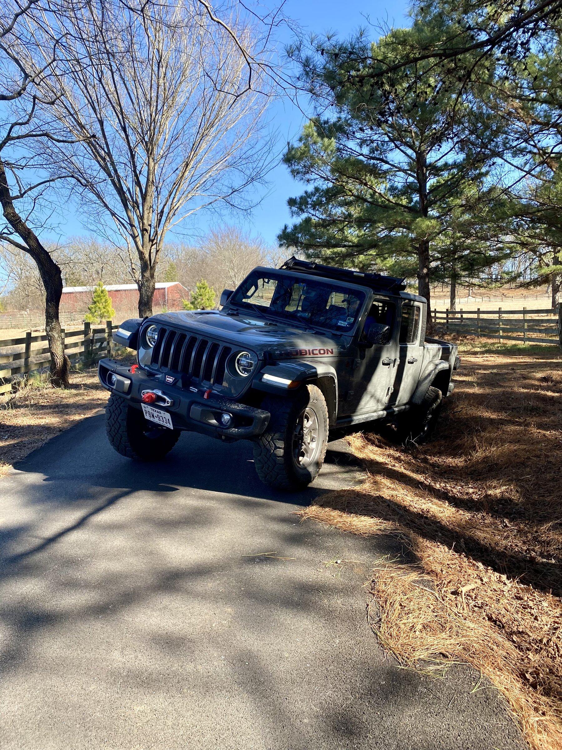

You will have ZERO problems with 12.5” wide on stock rims on the Mojave.
there will be a handful of naysayers that will jump in this thread and tell you that you will explode and die. Ignore them.
35x12.5 on stock wheels:

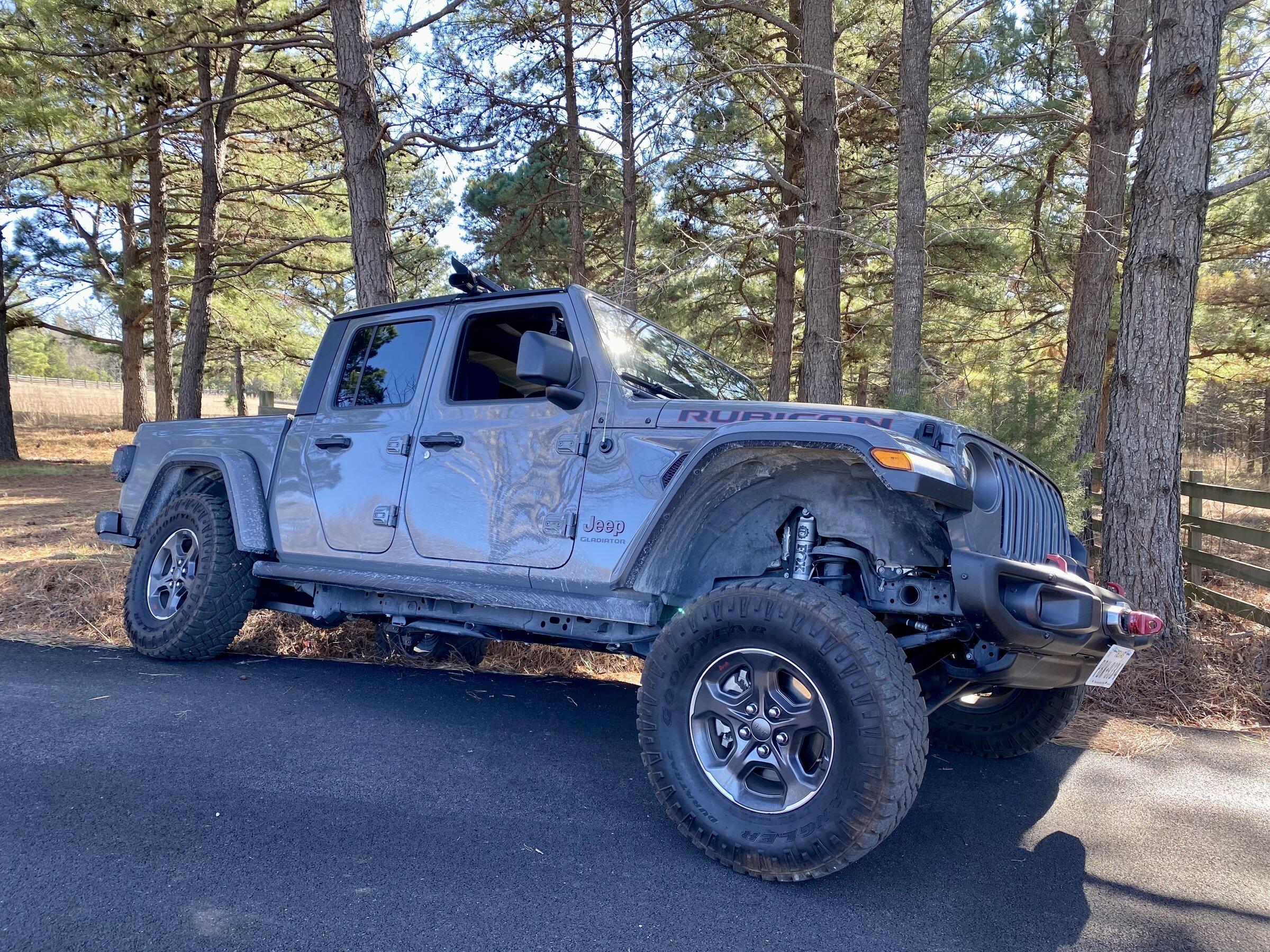

Correct. I ran 37x12.5 on my factory rubicon wheels for a year and a half. Here are the trails I successfully completed without issue. I did have 1.75” spidertrax spacers, but factory wheels. I put them through a lot. And aired down as low as 13psi without losing a bead.
