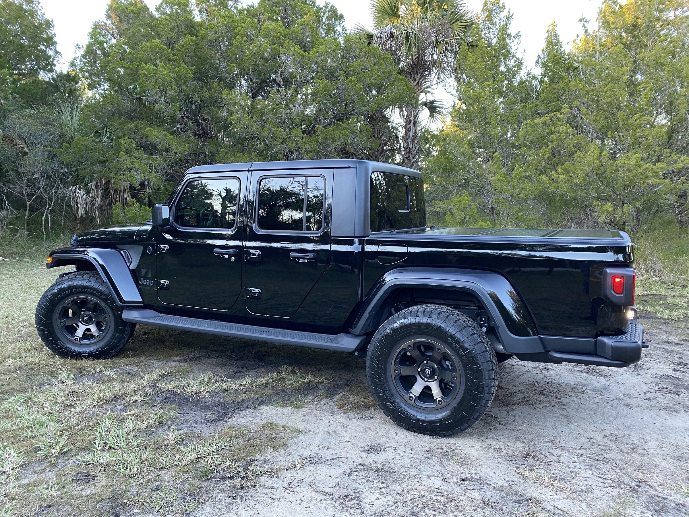

You will have ZERO problems with 12.5” wide on stock rims on the Mojave.
there will be a handful of naysayers that will jump in this thread and tell you that you will explode and die. Ignore them.
35x12.5 on stock wheels:

On the Mojave and Rubicon, you don’t need wheel spacers. The tires stay inside the flares as these trims have wider fender flares.
You will not rub.
No modifications are needed.
Shop around, find the best price, then find your closest discount tire and they will price match, mount ‘em up and enjoy!
1” wider isn’t that much more when comparing an 11.5 to 12.5.
Aired down, the contact patch will be just a bit bigger.
I haven’t experienced any unusual hydroplaning vs stock tires. There is going to be some, I’m sure, but no big deal.
