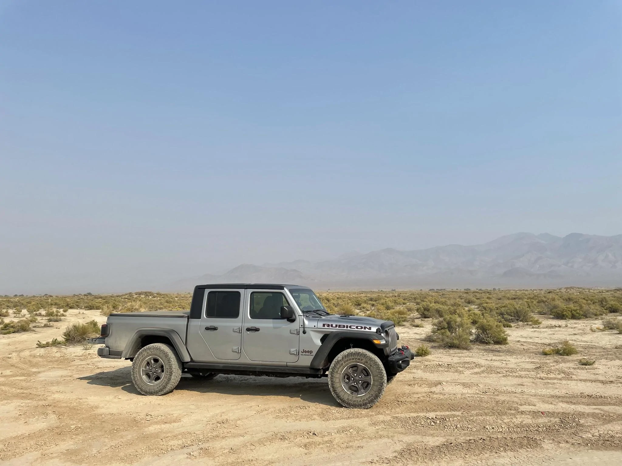

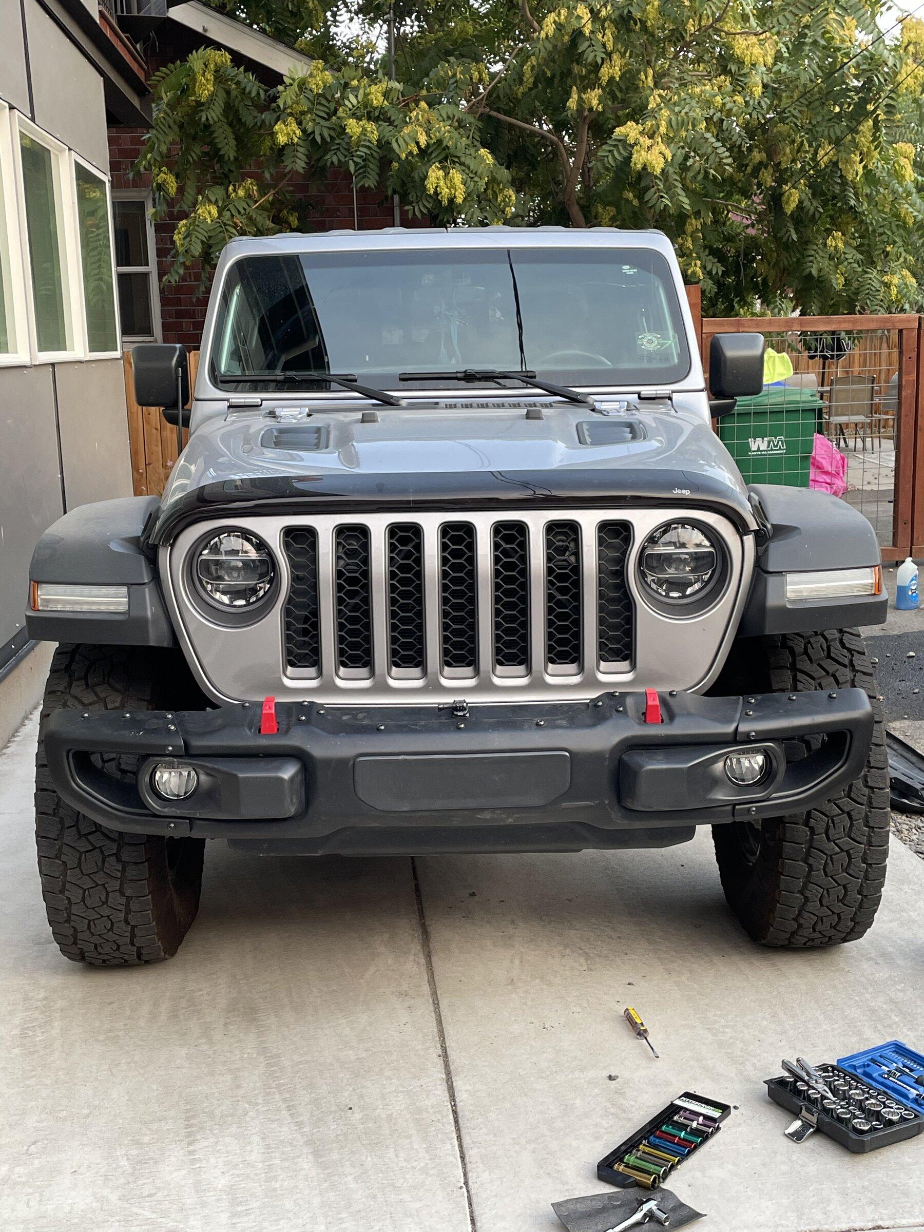

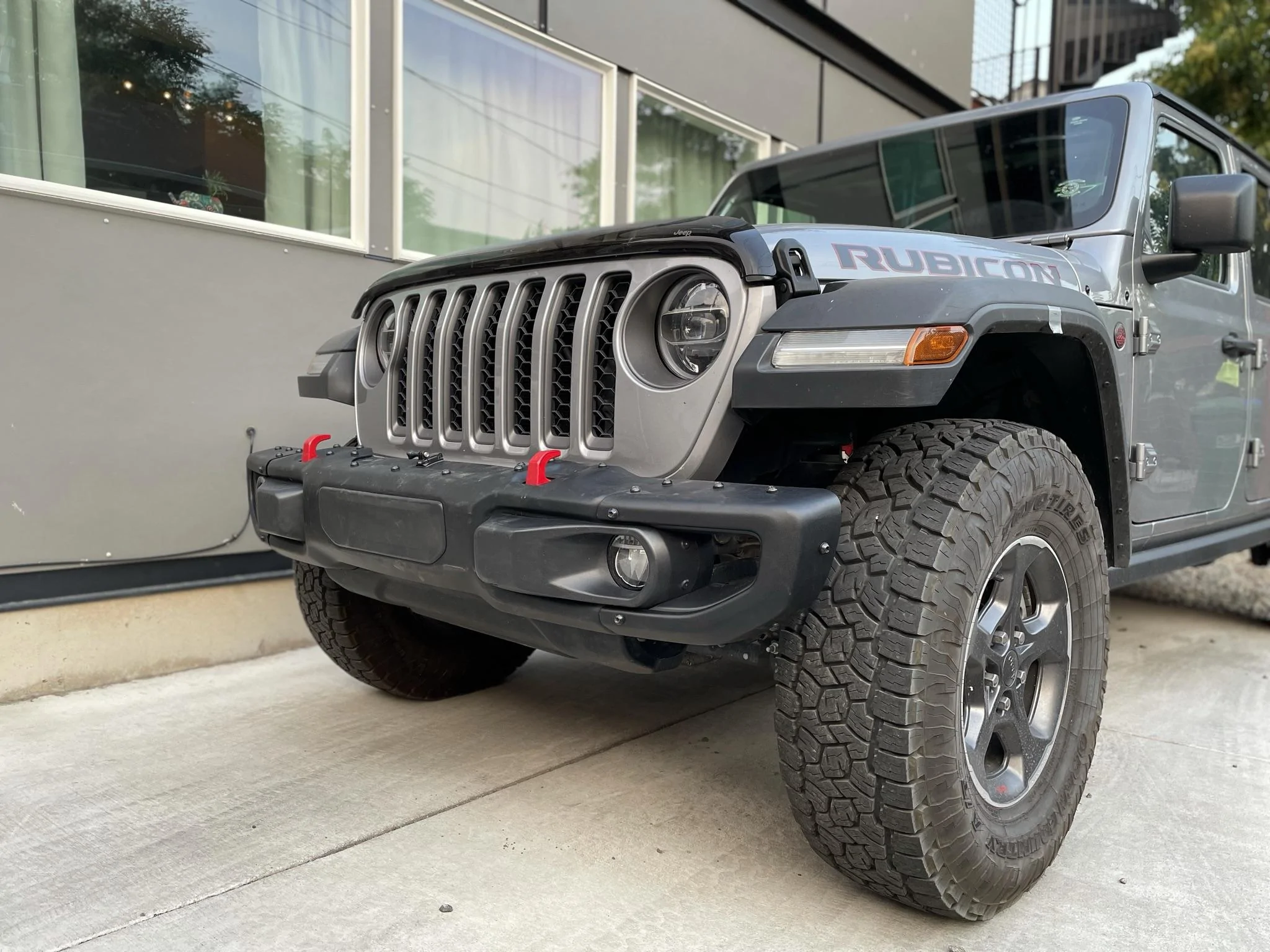

Went with the 11.5 AT3’s and never looked back. Lighter tire, less chance of rubbing, less “poke” and rock-slinging as a result, better snow performance in the Sierra.
Plus you get more of the classic Jeep look. I prefer it vs the wider tire which seems to be the trend as of late, but that’s a matter of personal preference. Pizza cutters FTW!

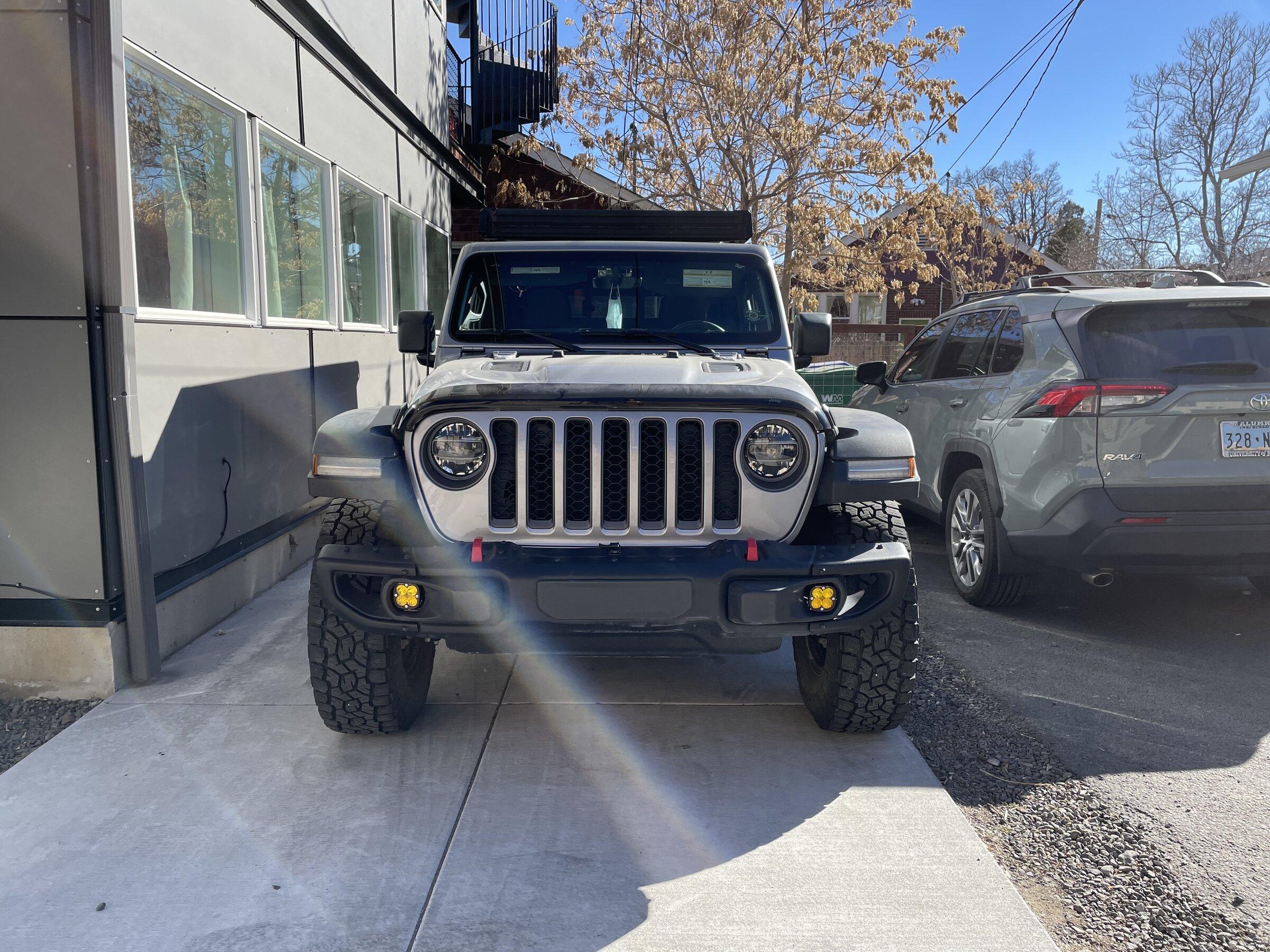

Assuming those are the 11.5's in your profile pic? Nice rig and I like the look of the tires, do you have any other pics you wouldn't mind sharing?
