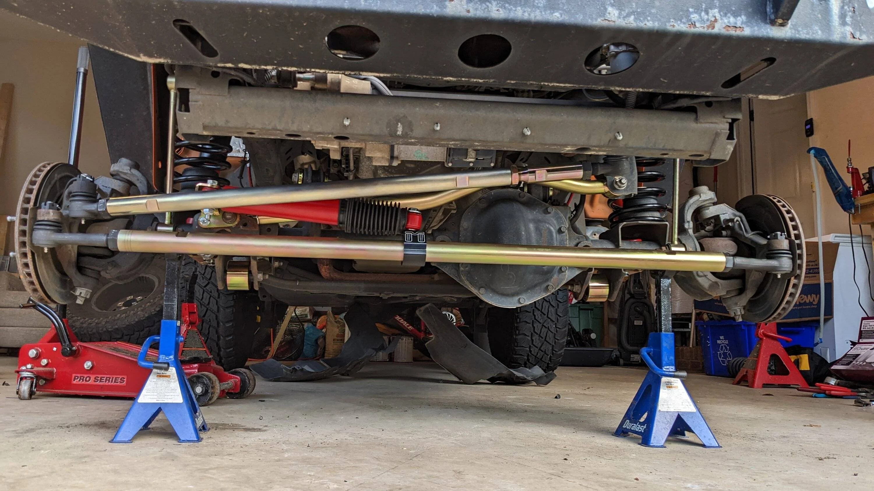

ball joints! No way are those factory ball joints good at 36000 miles, they are toast at 20k. The ball joints they put in are trash! If you take that knuckle off youll see those things will wiggle like a noodle.
And you have seen them all, in all Jeeps? Every one of them at low miles to prove this?
And yet there's many thousands of Wranglers and Gladiators out there with a lot more than 30,000 miles on them doing just fine.
Sure, it's something to look at, check - but I'd bet money that the ball joints on my 2020 were fine when I traded it at 27,000 miles.

Ball joints on my 2012 JKR are still OEM. That thing has been lifted on 35's since 2013 and wheeled a lot. I just redid the suspension on it, those joints are still good. Was for sure thinking they'd be ragged by now. Nope. Almost 140k on that thing too.

Get the Synergy Sector shaft brace and call it done. I did and now enjoy my gladi wobble free. Best upgrade I've made so far

You can feel a worn ball joint by lifting the wheel off the ground by the axle an inch or two and putting a pry bar under the tire and prying up. If there is play upward the joints are toast. Can also push and pull on the top and bottom of the tire to feel for play.
Not my first rodeo building Jeeps or doing suspension. This vehicle being so new I just didn't feel like dealing with it when the dealer had "fixed" it in the past. I'm still not happy with their solution. So I'm most likely getting rid of this truck since I have no desire to pump money in to a 2 year old vehicle that is a daily driver for my wife.
When I say I've done suspension this is my most recent October of last year. Full MetalCloak game changer suspension and HD steering on my JKR done in my garage on the floor. It had a full Rock Krawler suspension on it prior that I installed in 2013. Before this I had a 2010 JKUR that I did a 4.5" full BDS suspension on. Before that 2006 TJU, 1994 YJ.

I've seen numerous accounts of ball joints, track bars, pitman arm nuts, sway bar links, and more not being properly torqued on delivery.
I think if you win the ball joint lottery and get one that's properly torqued from the start you'll get good service life from it. If you get one that wasn't, then obviously you're going to get premature wear and it'll come to light as bad handling when it's too late to fix with just a torque wrench.
Remember too, Jeep issued a TSB increasing the torque on the lower ball joints by about 20 foot pounds.
People who got good ones argue that they're all good. People who didn't will argue the opposite.

The Gladiator is good now that I put a Bilstein stabilizer on it. Drives better than new. The steering has been squirrely in the Gladiator since the day we bought it new. I always thought something was wrong. Very twitchy and zero resistance. Now it's nice and firm. I can actually take my hands off the wheel and it tracks straight. Before it would go all over the road.
