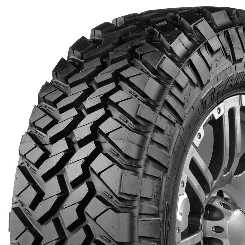

Nitto trail Grappler M/T's 315/70R17 ie. 35x11.5 mounted on stock wheels, 10.25" tread width, kind of-the side lugs will come in and add 1/4" every other alternating lug.-if that makes sense. If you count both side's side lugs then 10.75".
From that 10.25" measurement, there is 1 inch sidewall bulge /side. So, stock wheel ≈37 psi, overall width 12.25" bulge to bulge.
Jeep Gladiator 11.5" tire width, call for a measurement please (tread width!) 1623092485050
(Stock photo)

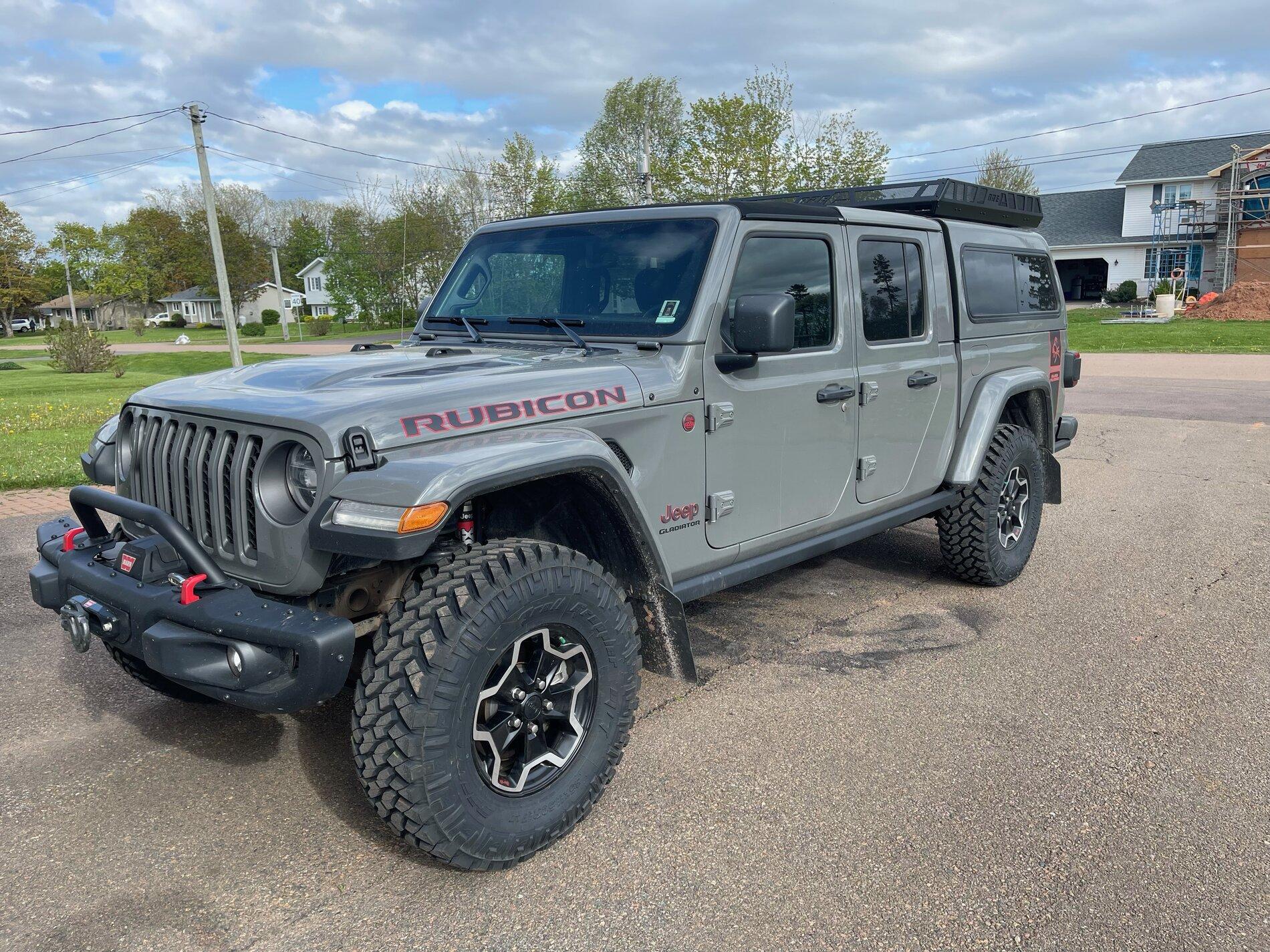

Running trail grappler 35x11.50 on stock Rubicon wheels
10 1/4 tread width 11 5/8 sidewall to sidewall
NO WAY 315/70R17 IS EVEN CLOSE TO 11.5
THAT SIZE WOULD BE 34X12.50
