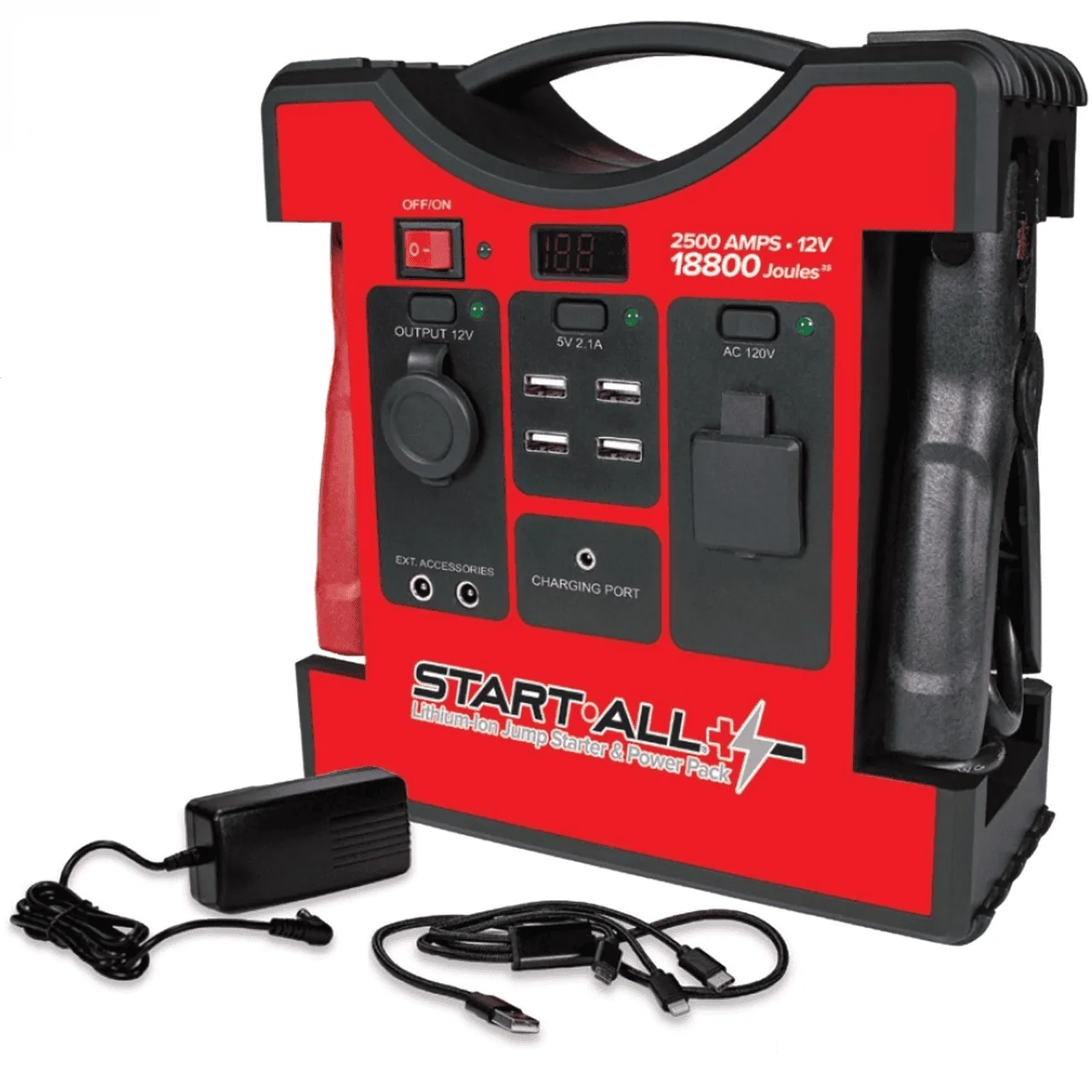

Bought this instead of messing around with a bed socket. I figured that I would smash the socket in the bed. Have started a few vehicles with it already. I like the idea of backup starting when off road or camping.

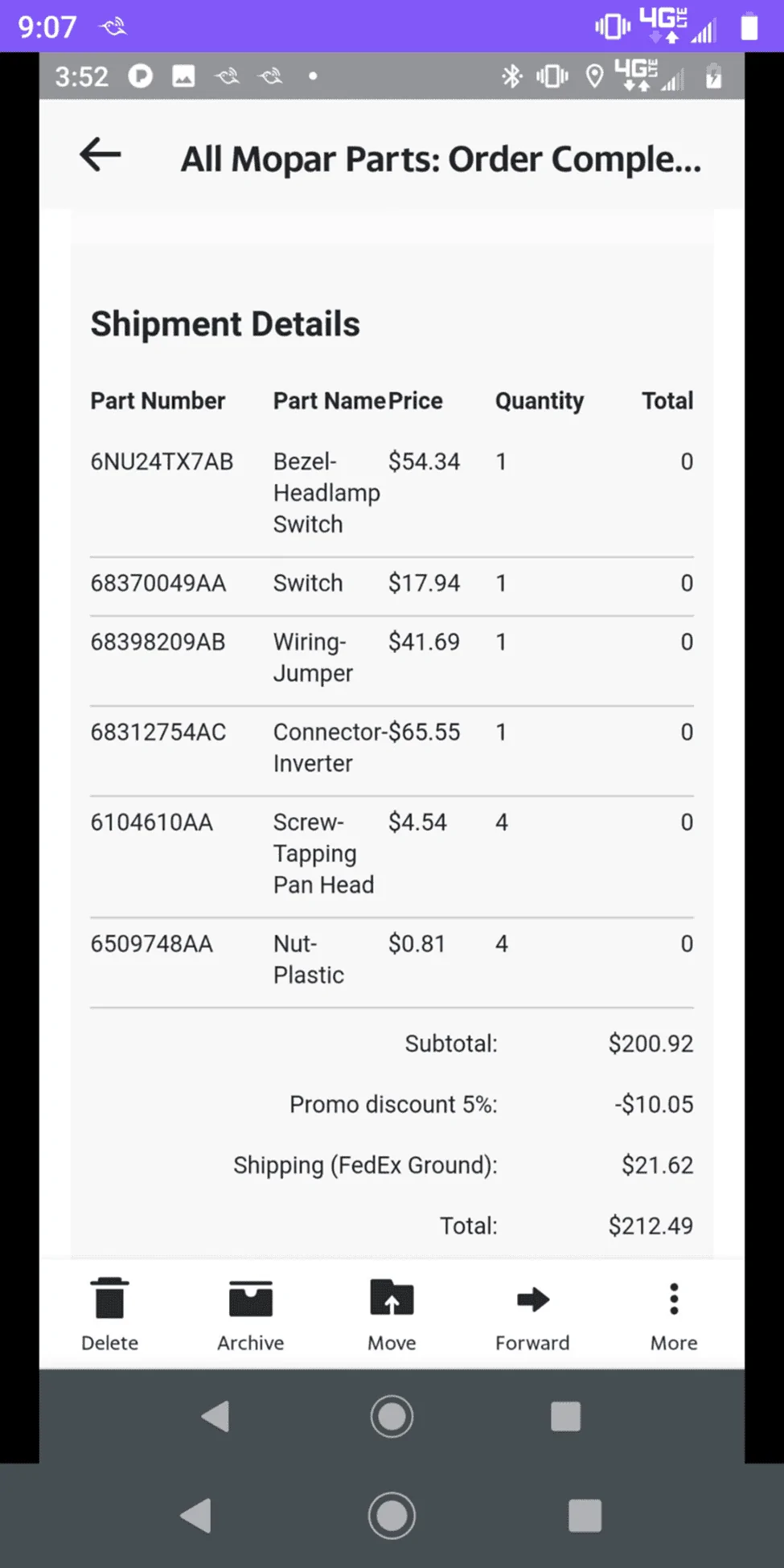

I was planning on installing the oem power outlet in the bed. The only parts that I have been able to find are the plastic nut plates and the screws that mount the outlet. Anyone else having luck ordering the parts needed?
I've been searching as well. I found everything except for the dash bezel and jumper harness.
Deleted member 28696
Jeep Gladiator 115v bed outlet 1646204935517
Someone had this parts list in the forum. I ordered all the parts from moparoneonline.com it was a little more expensive than this list. You have to replace the cable harness at the back of the truck with a Y-harness that goes up to the plug. This will work if you have an existing inverter with a plug in the back seat area. You also have to activate the plug with a Tazer JL mini I don't think any other brand can activate it. The plug works but I doubt I'll use it anyway since it will power a table lamp or a radio but won't power a vacuum or anything real useful. It will power a Traeger grill. I suppose possibly a griddle or crockpot those types of things but nothing with a motor load.
