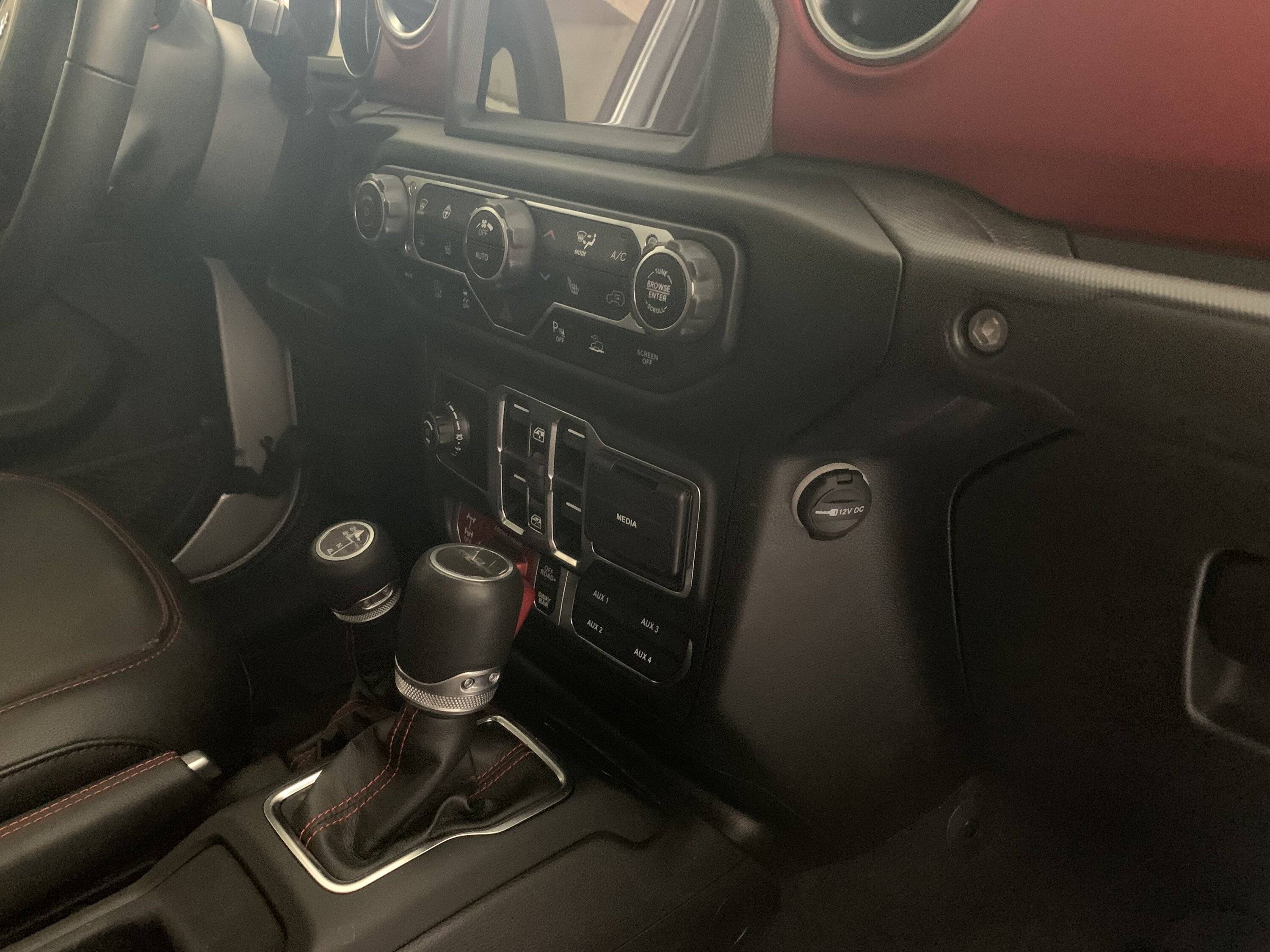

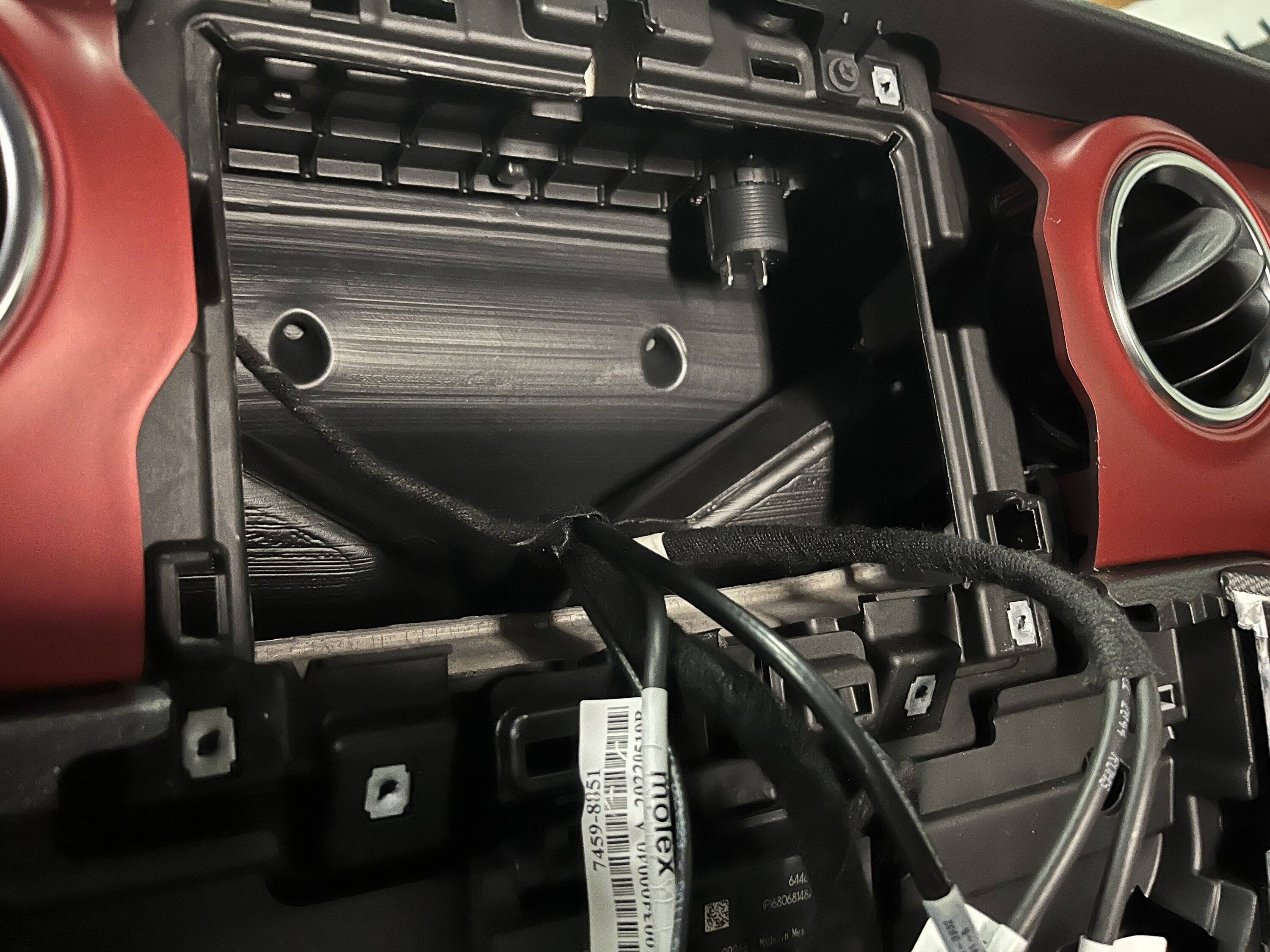

That is one impressive install, thank you! From the pics it appears you also trimmed the internal plastic bits that the climate control clip back into, is this correct? Any issues with the climate control rattling or being loose after this install? That was actually my second choice location just thought it would T work because of where those clips attach to the plastic.
Turnswrench
Bowman
Mar 10, 2023
422
1,067
Palmer, AK 99645, USA
2021 80th Anniversary, 2023 Rubicon
Start Up Strategist
I didn't need to trim a single thing inside the dash setup. Just drilled the hole and routed the wires. The climate control all snaps in just like factory, so no rattles at all. You got this!

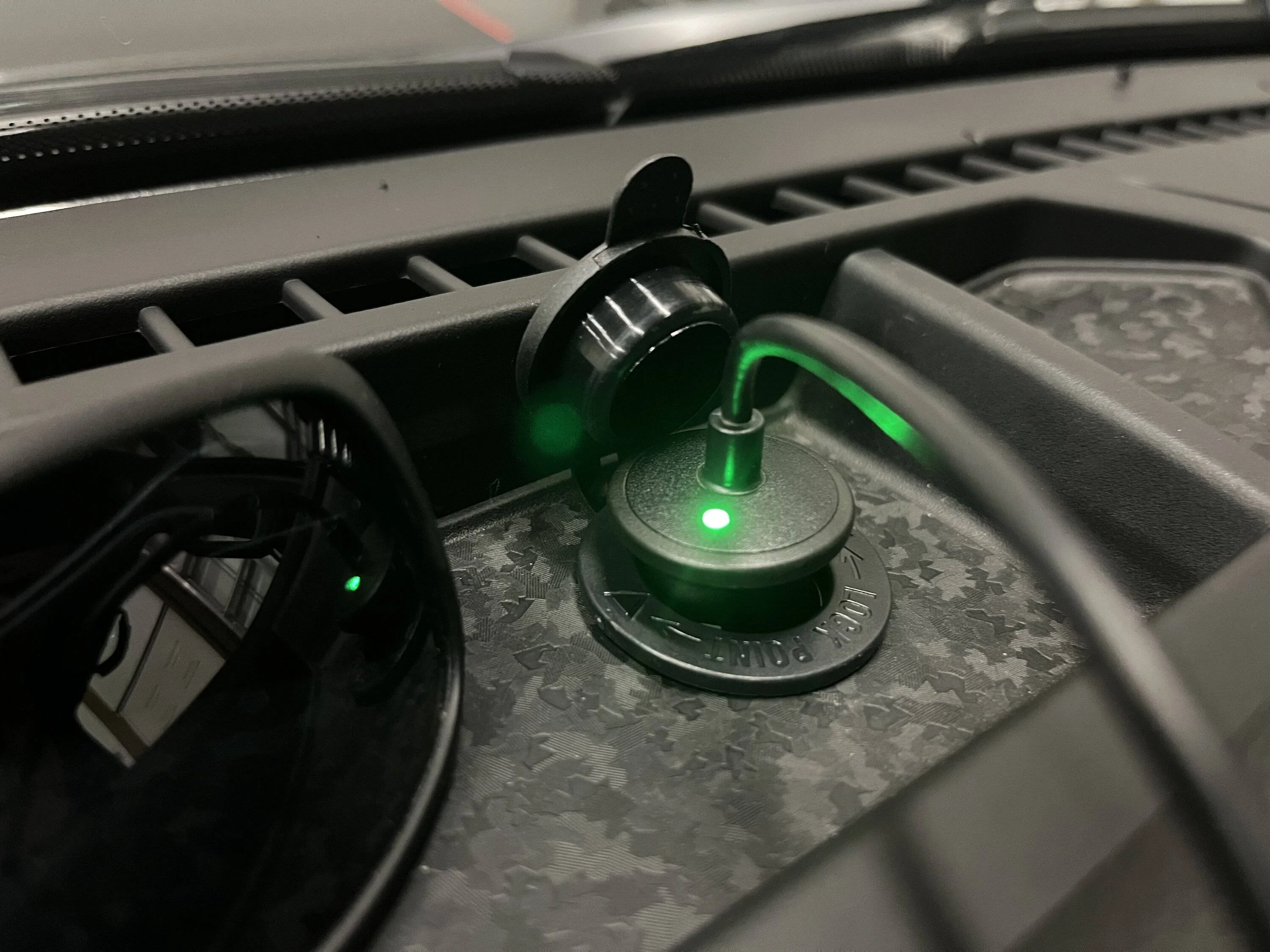

I relocated mine to the top of the dash using one of these 12v receptacles from Amazon:

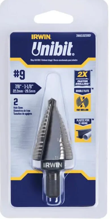

That 12v relocation took me all of 10 minutes with the right tools (cardboard, compass, drill, file) all thanks to members like you…keep the upgrades going. Next on my plate: Front Trail Cam.

I am out to perform the 12v relocation as well… can you share the size of hole saw? I’m measuring that a 1-1/16” will be needed???
how much room for error would you say that you have in terms of the hole location… knowing my luck I’ll be a quarter inch off and the whole thing will be toast.

Yes, 1”-1/16. Make a cardboard cutout of the exact shape and put a small hole through the center of the cardboard cutout. Then tape the cutout where you want it on the dash. Take a small drill bit first and drill a pilot hole in the dash. If you screw it up then it’s not a big deal with only a pilot hole. If your happy with it then use the drill bit like below to get it to 1”-1/16. Then file the tab out and your done.
