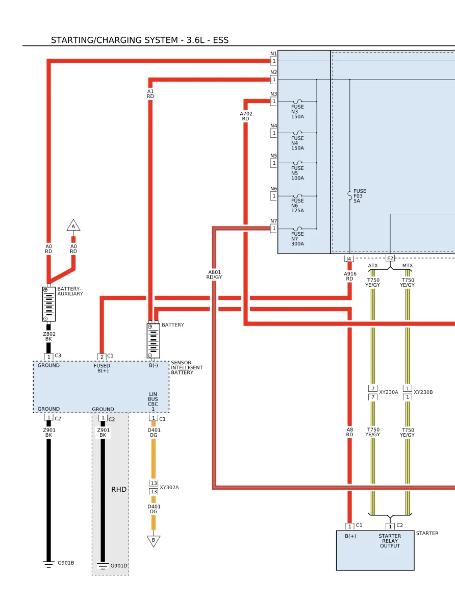

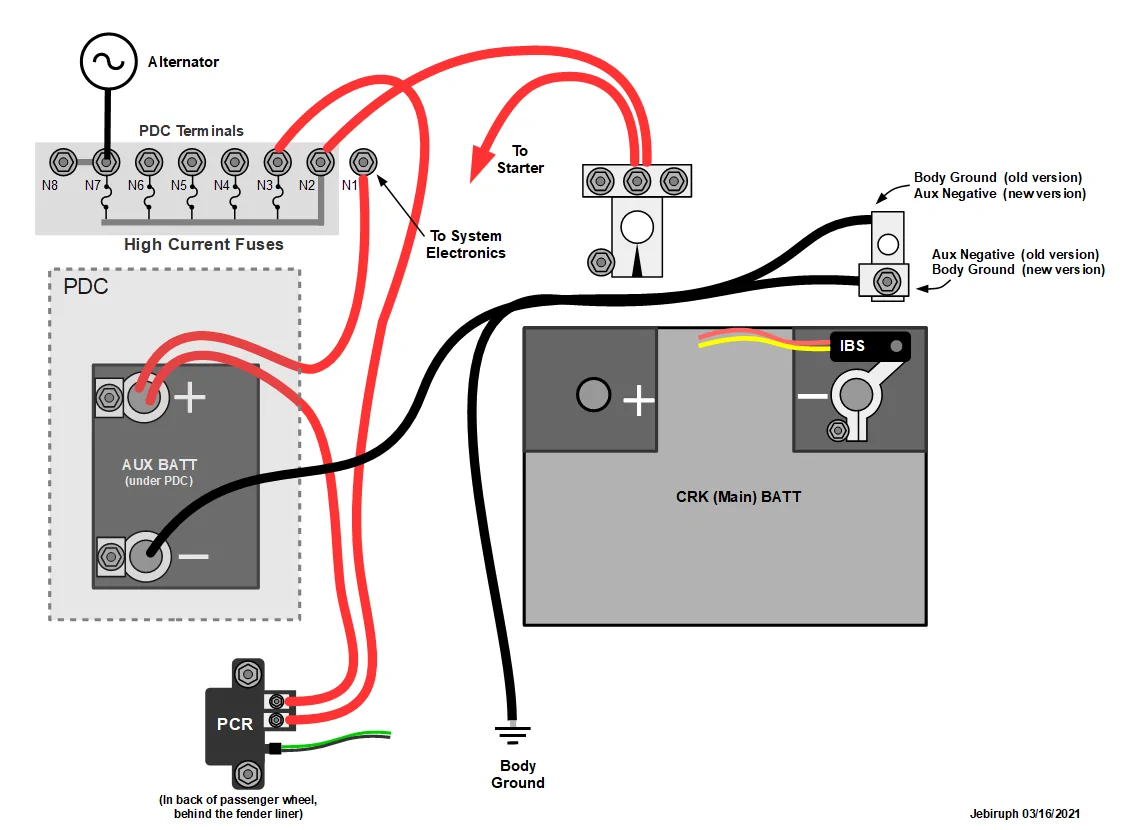

With your ground cable disconnected from the battery, measure the resistance of the cable to the body ground. It should be 0 ohms.
Also, the N4 terminal connects through a 150 A fuse just like the N3 terminal. The N4 terminal is typically unused and as a work around for a blown N3 fuse, you can move the wire from N3 to N4.
Which battery is the IBS connected to? Genesis guidance used to be to connect it to the 2nd battery and not the main battery.

I don't remember what the ohms were. It was not 0 ohms. The IBS was connected to the second battery. To aid in troubleshooting, I have removed the Genesis system. While examining this wiring diagram, could the PCR be shorted? I would think a fuse would be blown.

Move the IBS to the main battery along with the factory ground cables. Your wiring should match the diagram. If and when you re-install the Genesis system, leave the IBS on the main battery.
