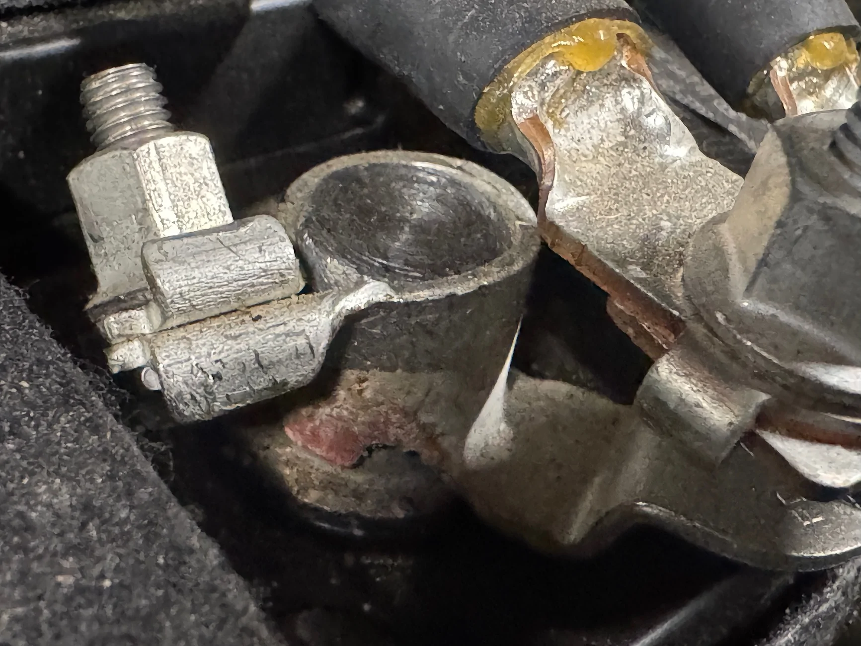

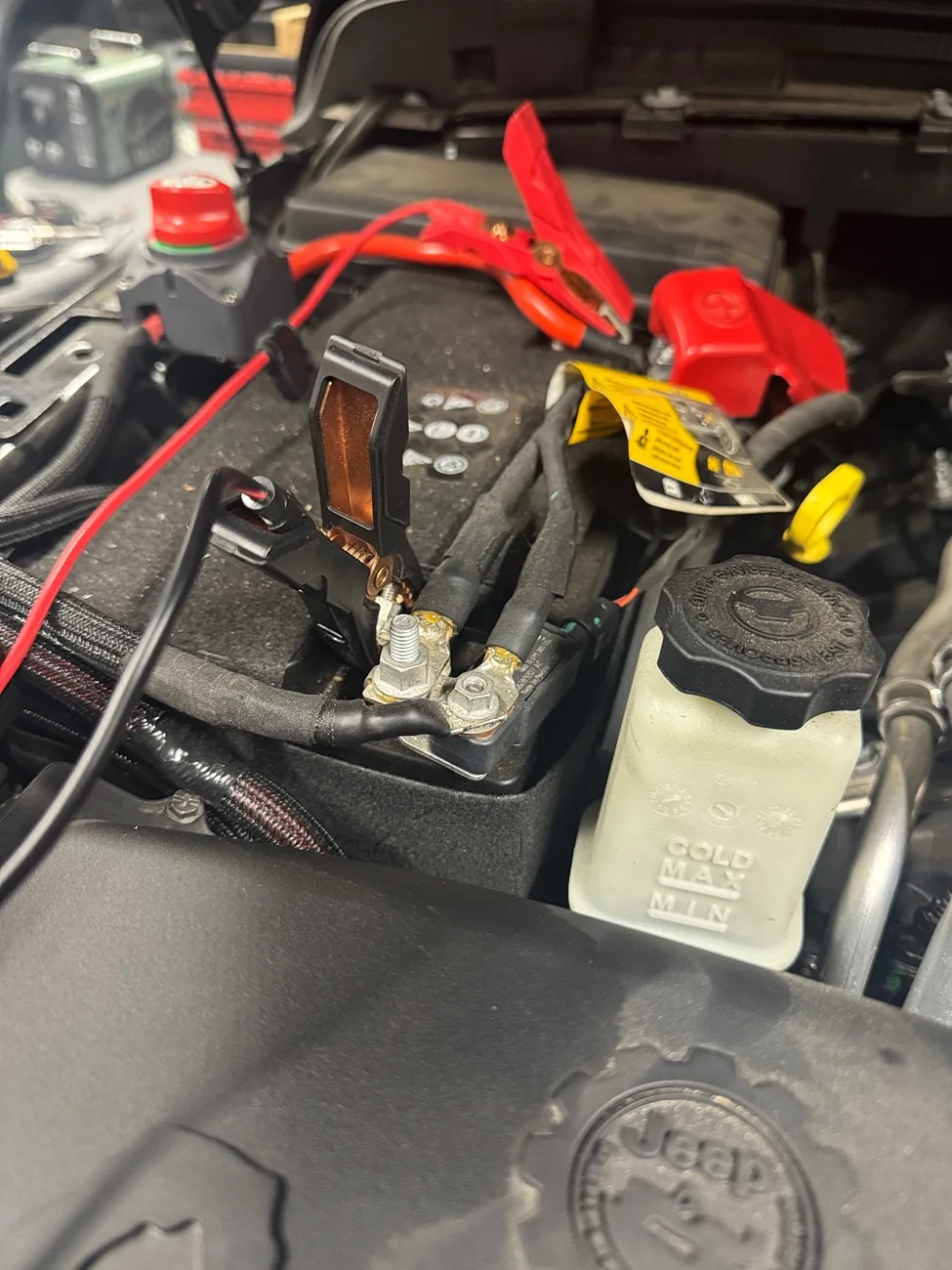

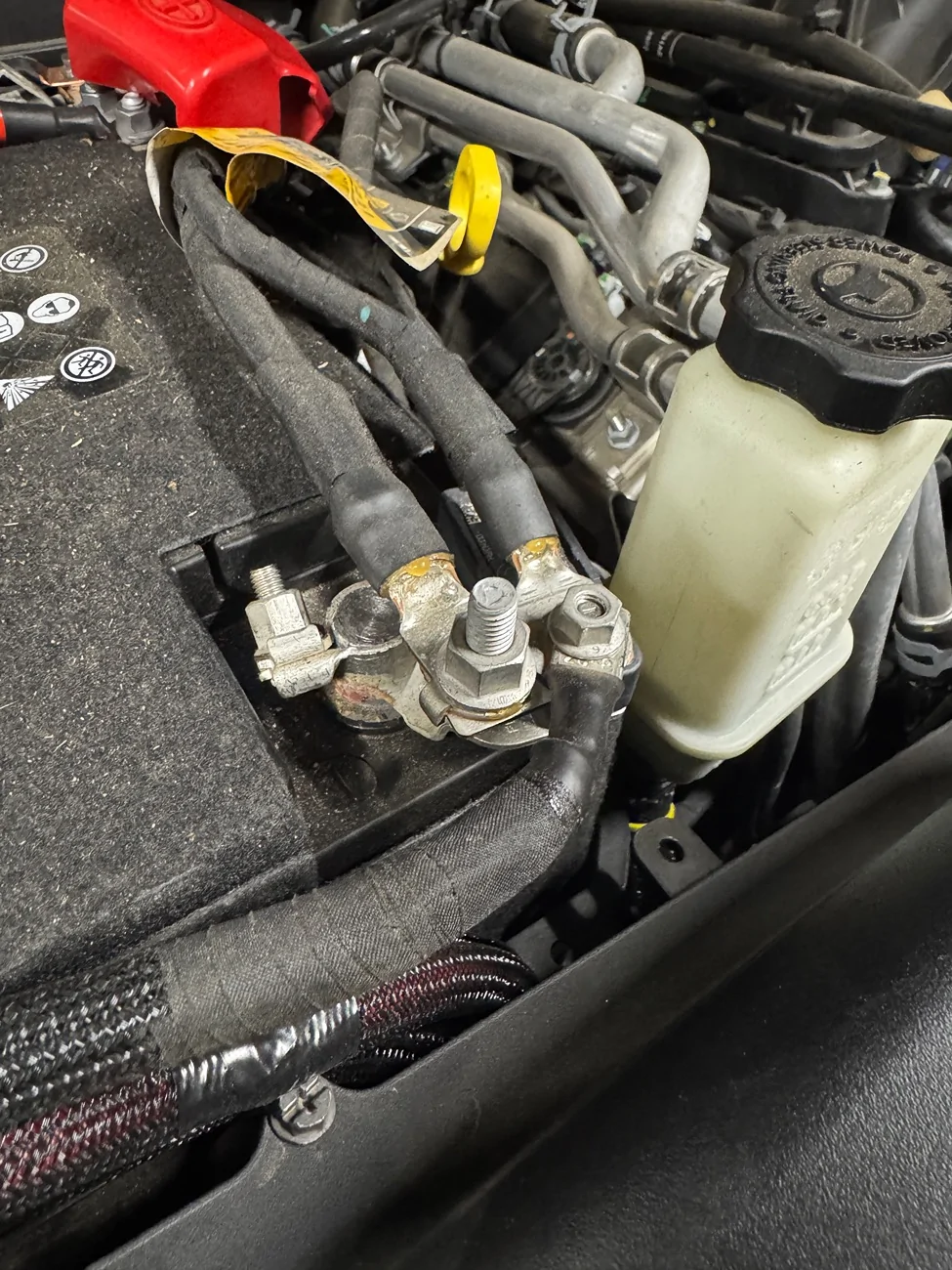

So my 23 Mojave is garage kept and spends a lot of time on a Noco Genius 10. When hooking up the Noco yesterday I noticed the bracket (for lack of proper term) on the neg terminal seems to be changing color and chipping away. The terminals look clean so I’m not sure what’s happening.
maybe I’m hooking up noco wrong? Here are some pics any suggestions are much appreciated. I already reached out to Benny at All mopar to see if he could get me just that part.

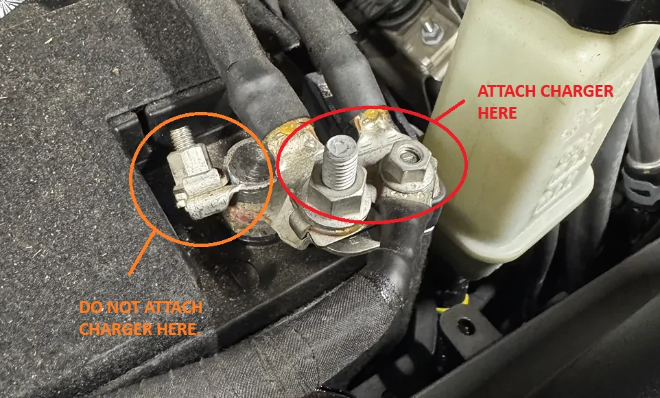

Yes, you are hooking up the charger wrong. On the negative side you need to attach the charger to the post at the top of the IBS and not directly to the negative terminal.
The IBS monitors what is happening to the battery as far as charging/discharging goes. If you connect the charger directly to the negative terminal it is called 'blind' charging since the IBS will not 'see' the charging of the battery.

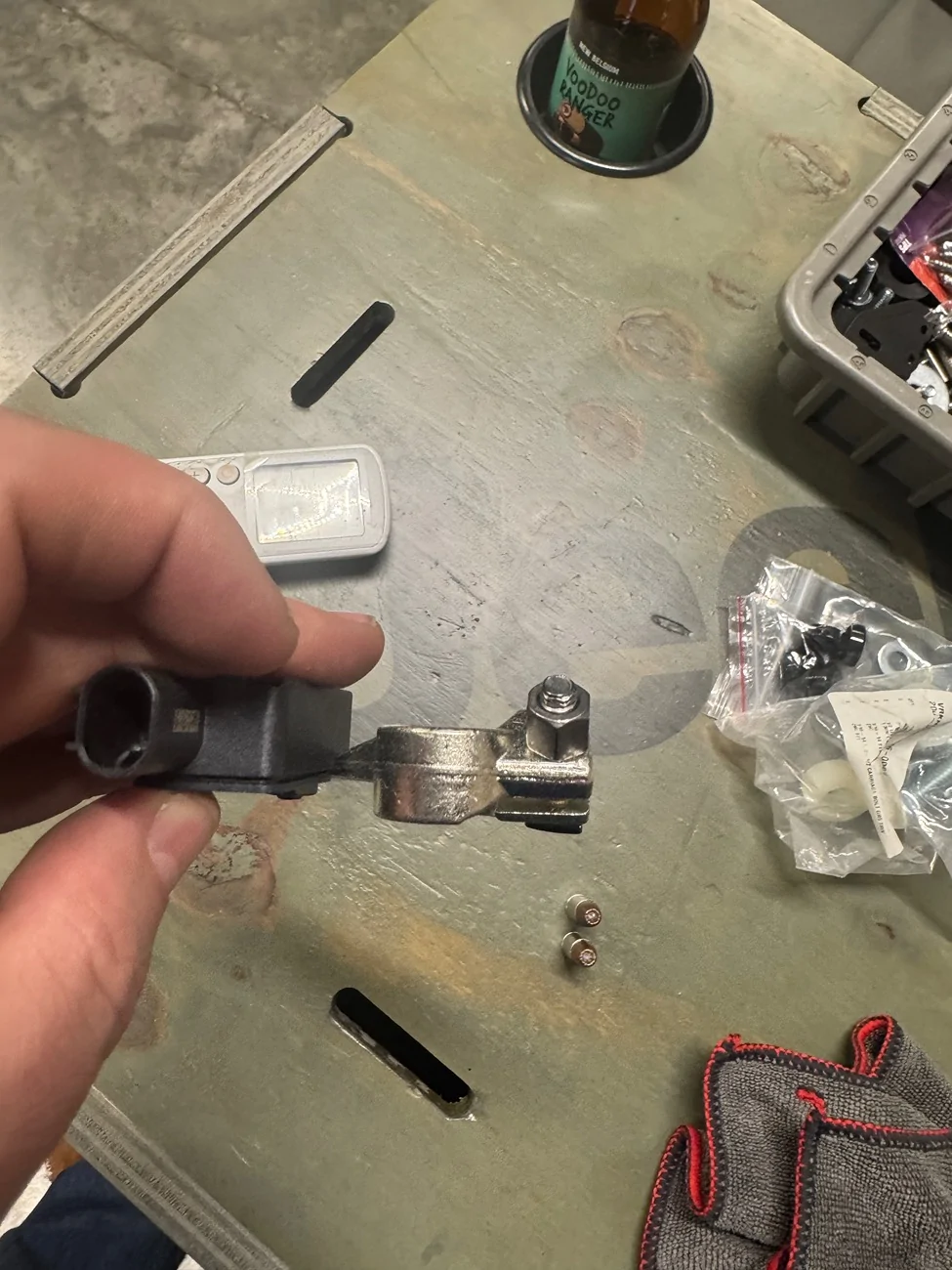

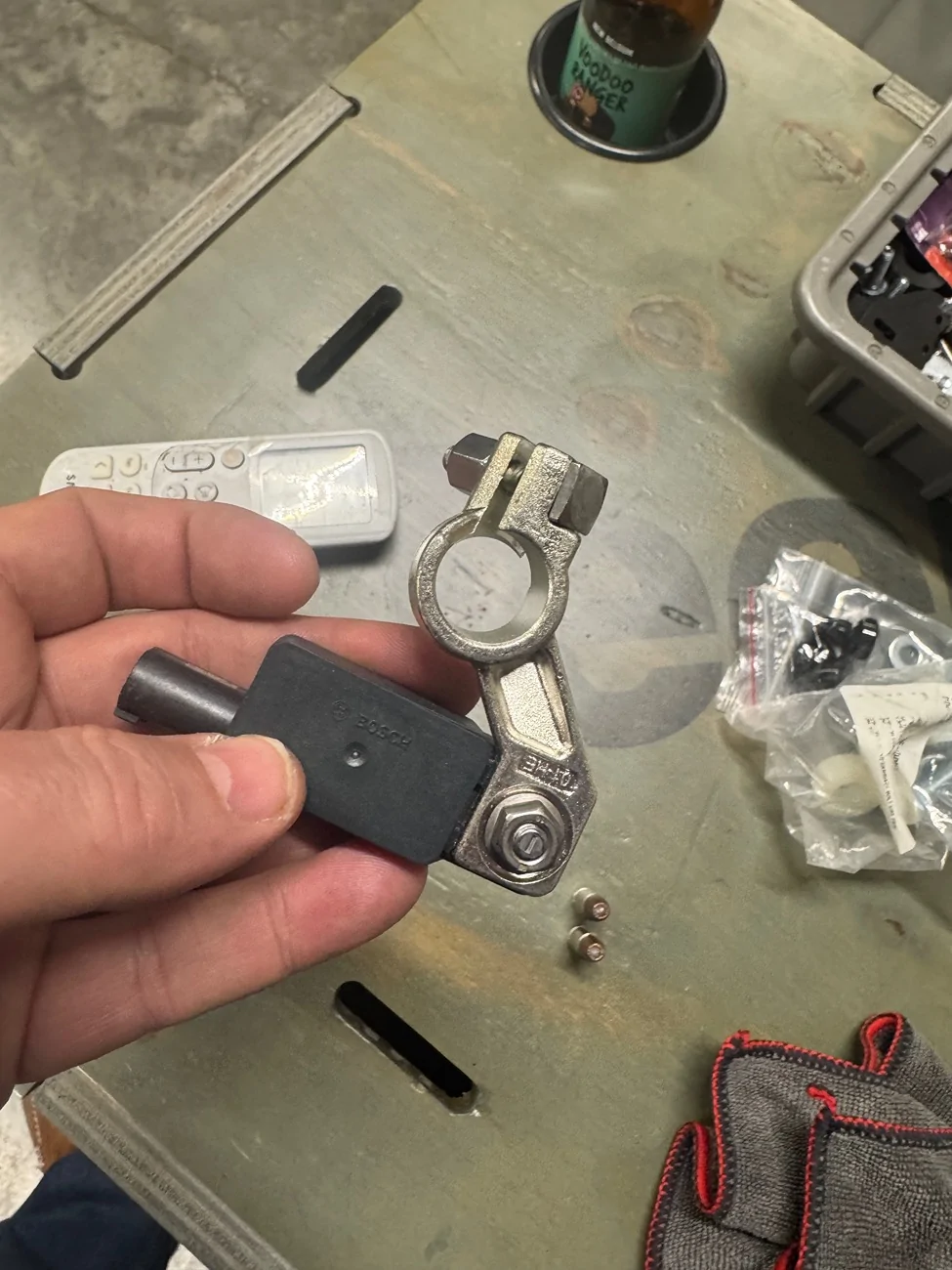

So I just received the new bracket and sensor, and it is definitely a beefier bracket, so now I’m thinking it wasn’t my mistaken charging style but maybe Jeep realized it needed to be more stout.
Thanks again for the help, here is a pic of the new part.
