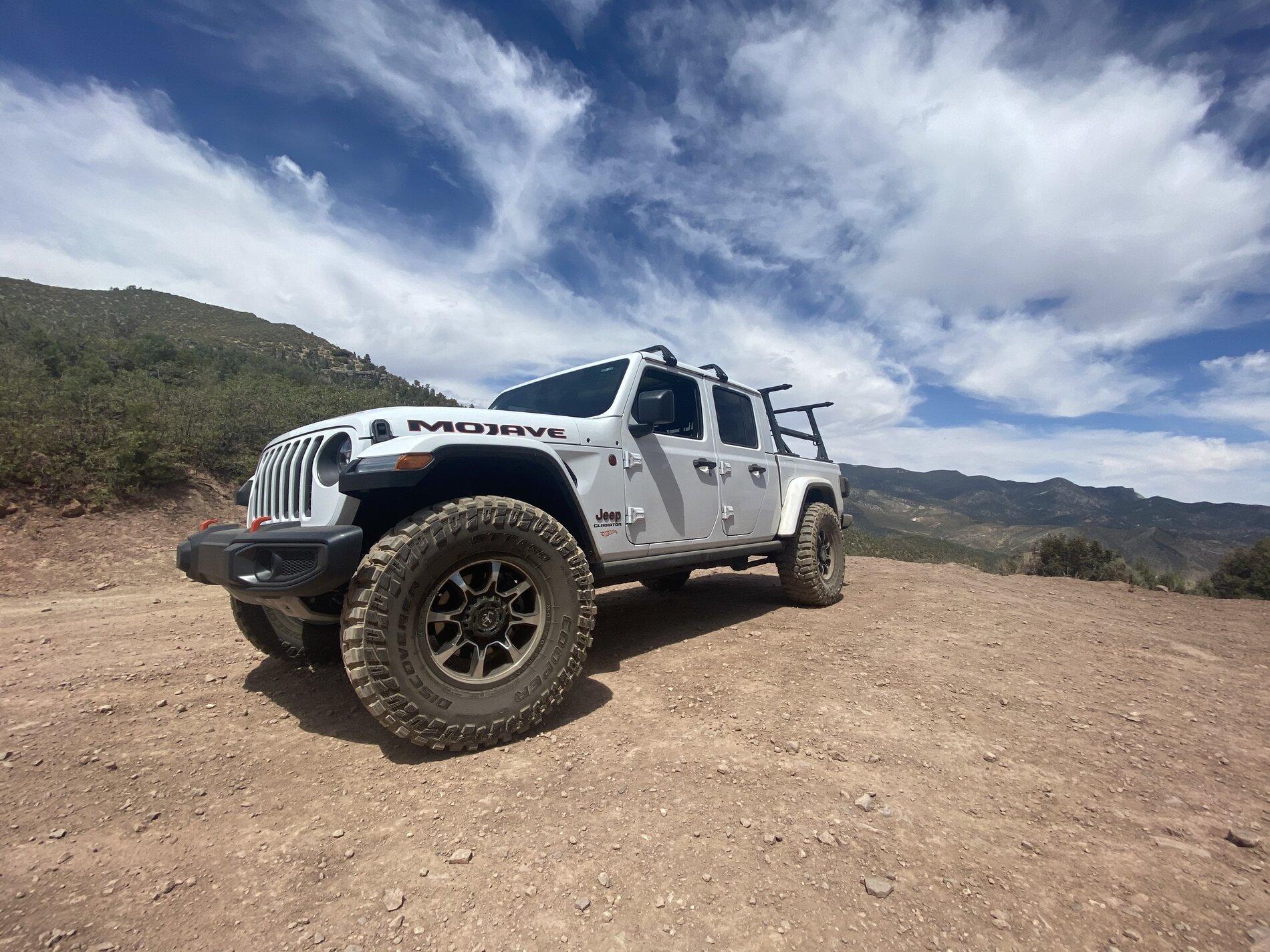

Got a buddy who called me tonight and said he got a really good deal on a set of wheels but they are +18 mm offset. They are an inch wider than the factory wheels so he’s worried about rubbing. He plans to stick with the original tires for now and he’s wondering if he’s gonna have a problem. Has anyone installed positive offset wheels and have pictures?
Motive Glock wheel, 18x9, +18 offset, no lift no rubbing?
