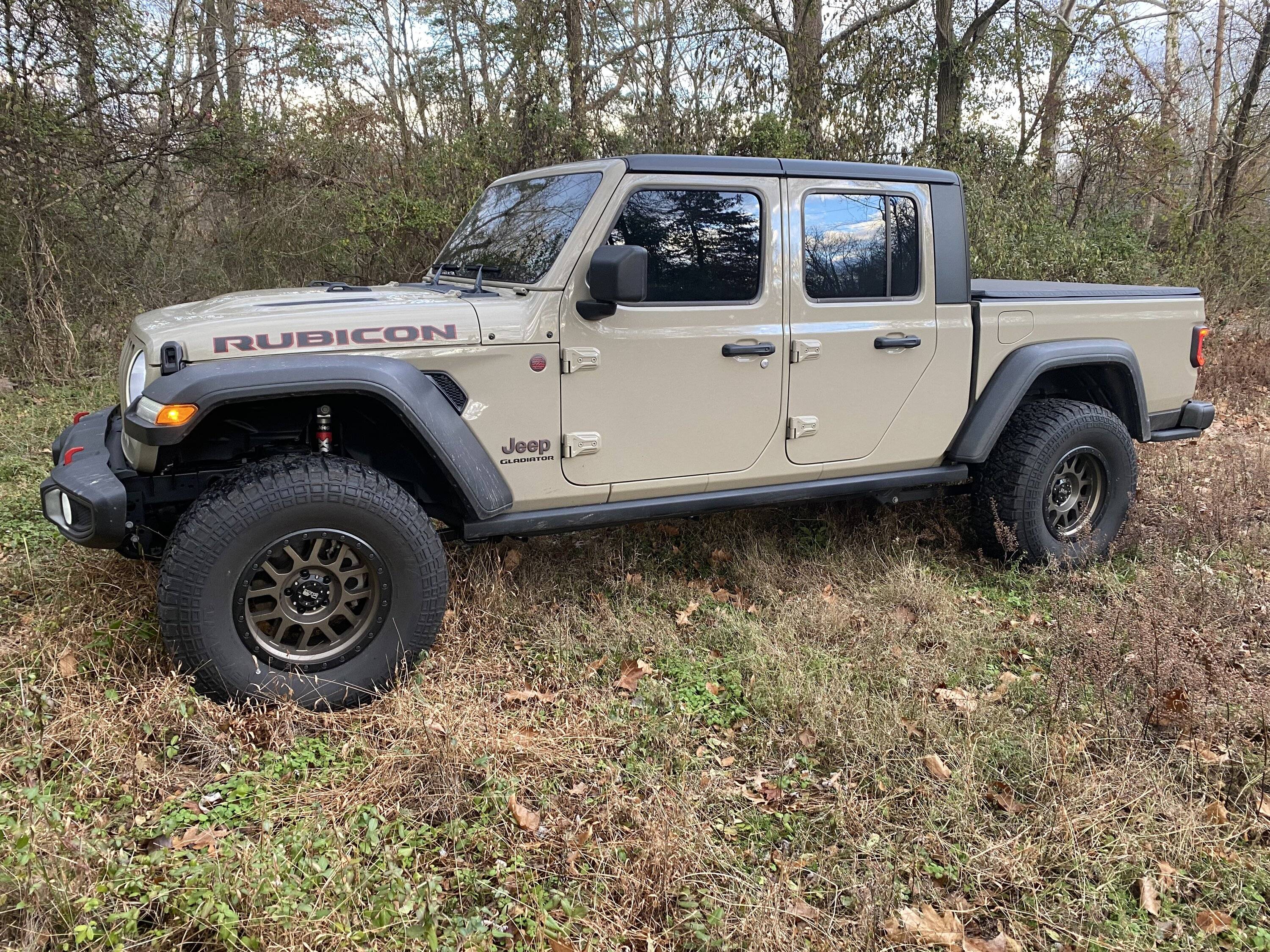

I put the teraflex 1.5” front and a daystar .75” rear. I’m runing 35s
Jeep Gladiator 2" Leveling Kit -- stick with OEM or go 3rd party aftermarket? 931FB805-EABC-4E52-B733-2C976616D7F5
This was my first lift and I truly loved the stance. Good set up
