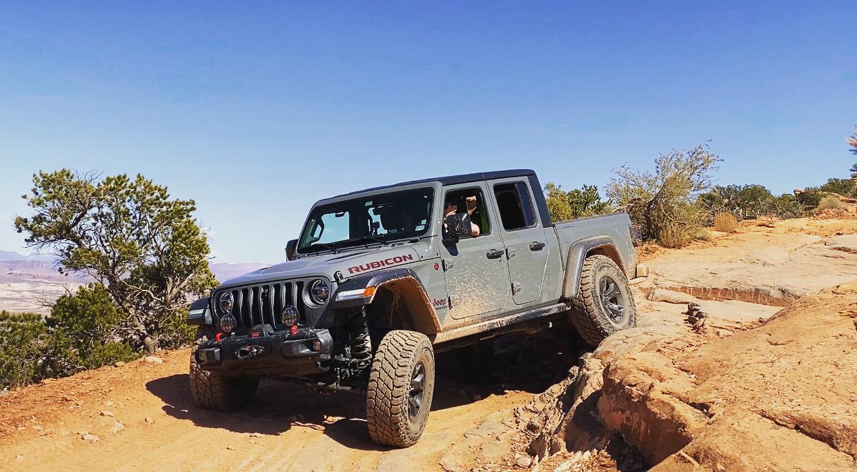

Well said. Didn’t hold me back running with many Wranglers in Moab on Hells Revenge, Poison Spider, or Metal Masher.
