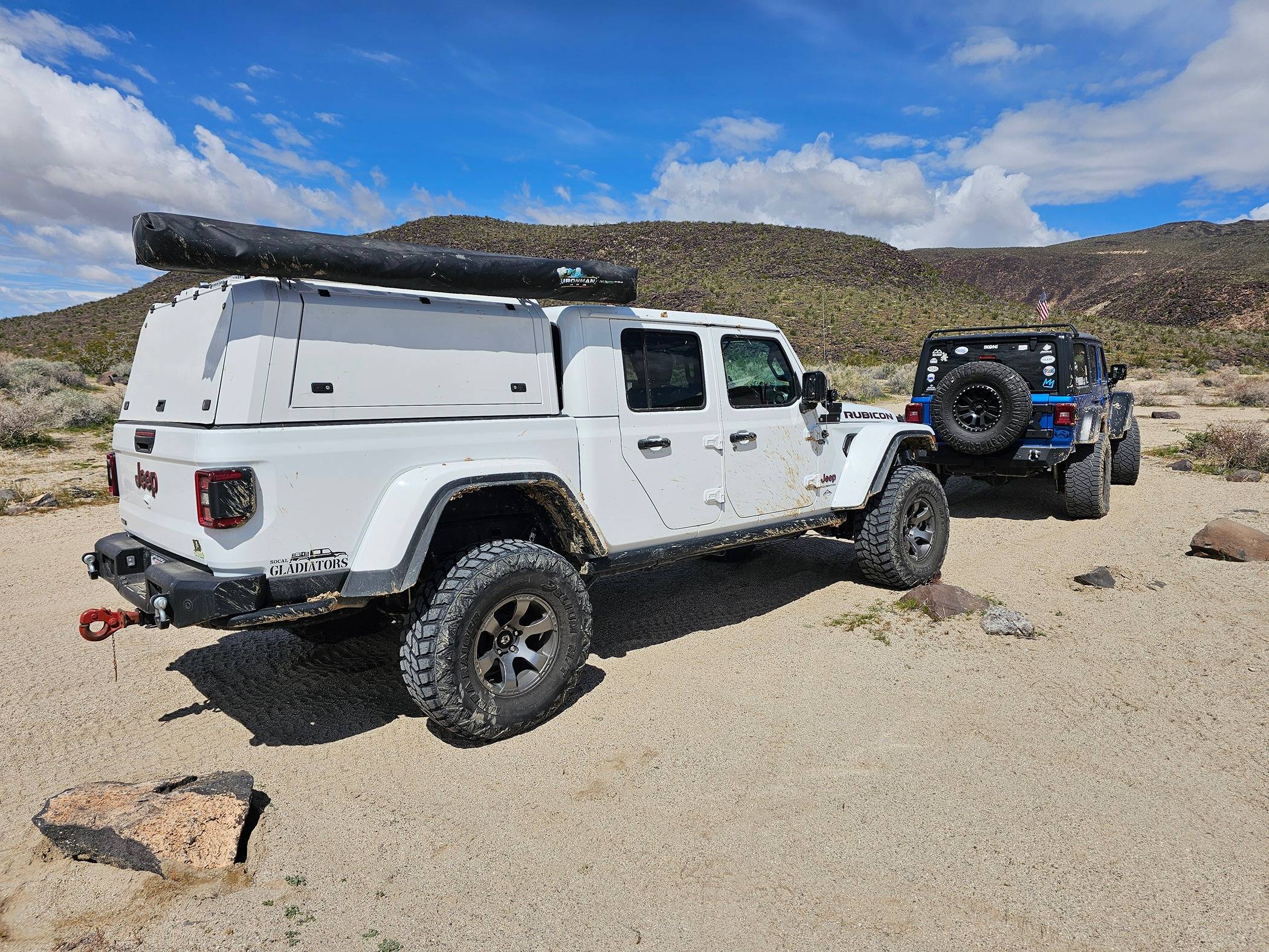

Rusty's 4".... love it, rides great, reasonable price, quality parts and I get 36" to the bottom of the 37" tires
ZERO COMPLAINTS

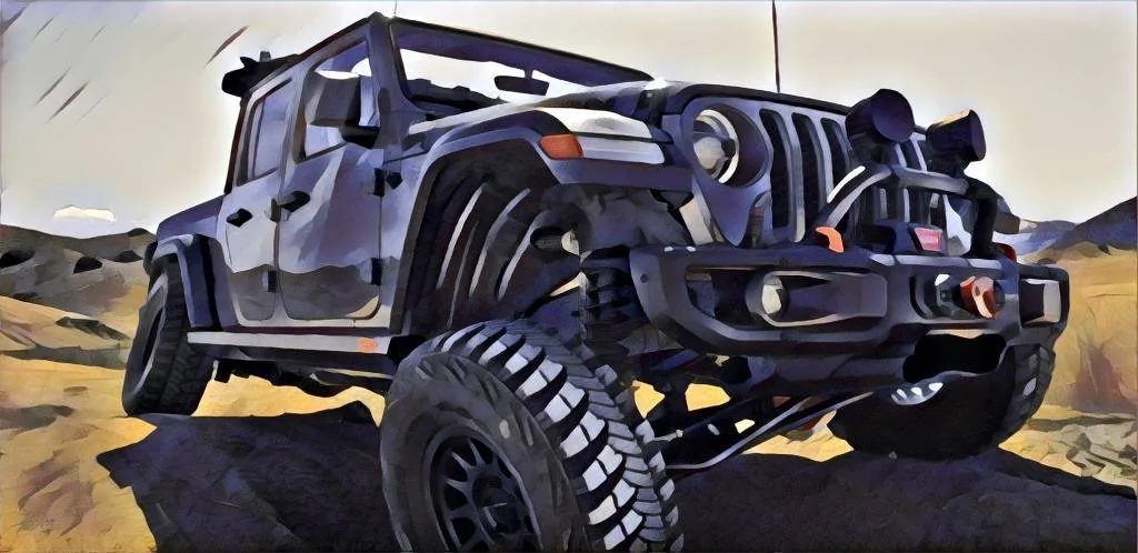

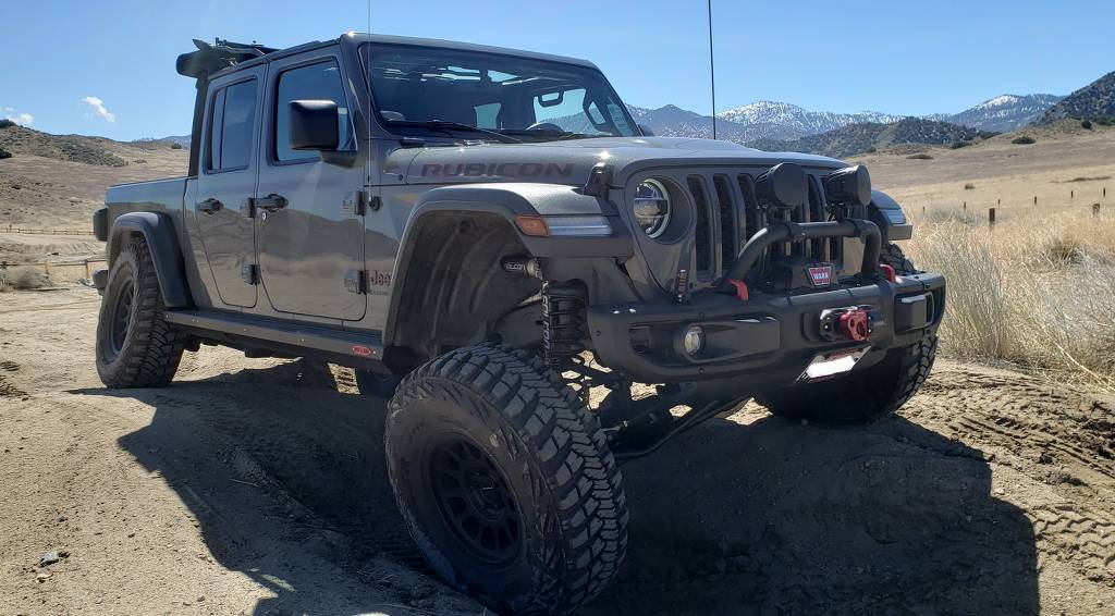

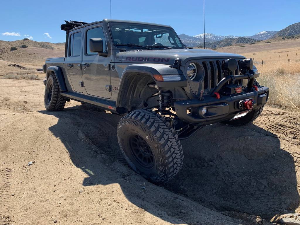

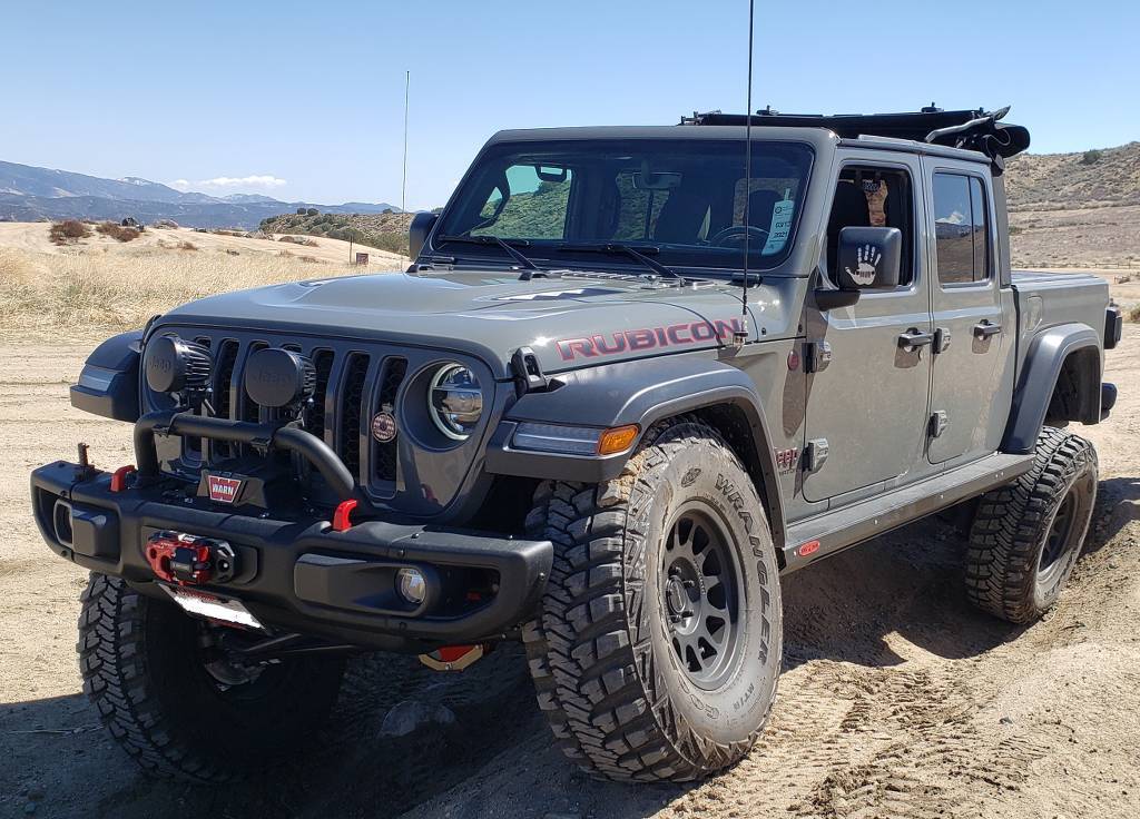

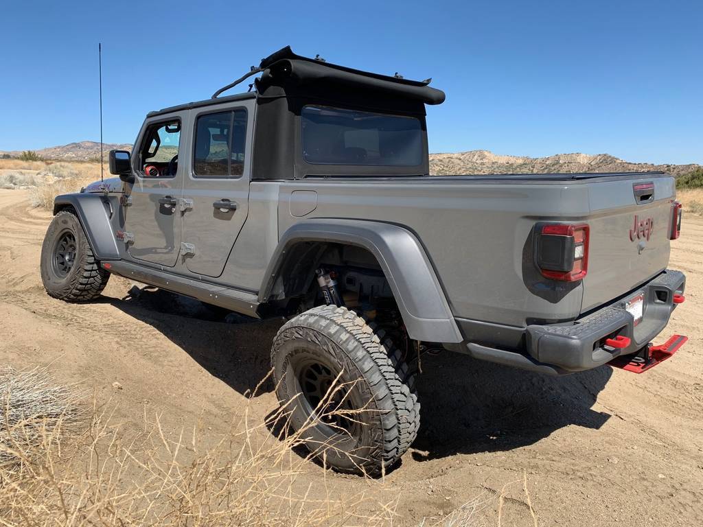

I am also in So. Cal. I went with the Clayton 3.5" Overland Plus kit, and have 45K miles on the kit. I have done all the Big Bear badge of honor trails multiple toimes and the Rubicon trail. Absolutely no maint. on the control arm joints and no squeeking. I think it is a great kit, and I am glad I did not go with Johnny joints. Note: I also bought the Rock Jock rear drive shaft carrier bearing spacer, and after bending many rear sway bar links on boulders, I installed the Rock Jock anti rock rear sway bar. Also, I also replaced the front drive shaft with an Adams 1310 because of Clayton's recommendation for the 3.5" kit. I recommend all for So Cal rock crawling. For rock crawling, I think you need to go with their 3.5 inch kit. No lower. I would also get skids for all the control arm attachment points, rear shock skids, and diff skids.. Here are some articulation pics.

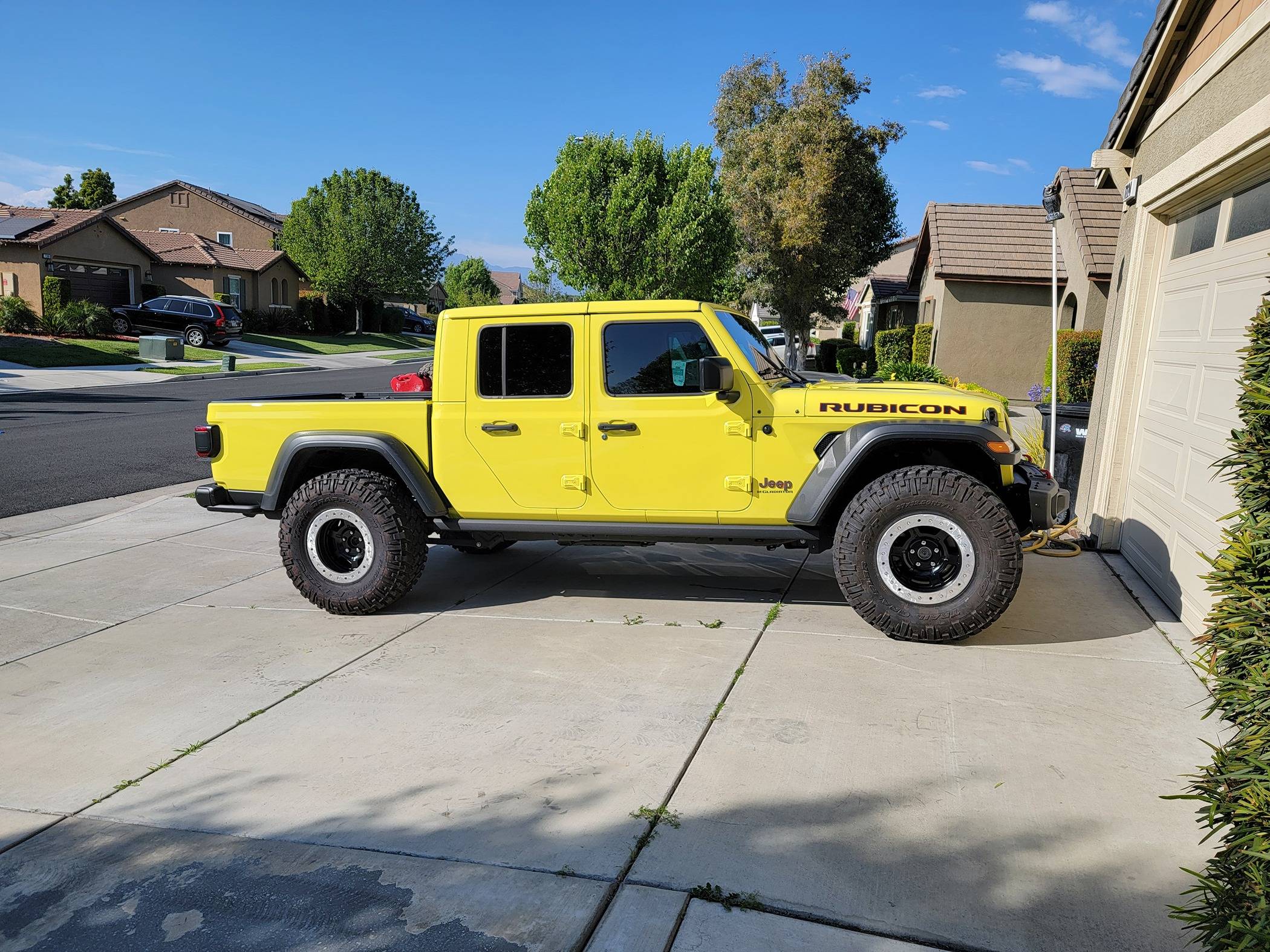

Those pictures show your tires are pretty much stuffed in the fenders... Are they 37 inch tires or bigger?? Based on the pictures If they are 37s I would expect anything less than the 3.5" lift would have me rubbing my 37s.
You mention changing the front driveshaft, was that needed?? Is there risk of overextending the stock driveshaft?
Thanks,
Greg
hjdca
Oct 27, 2019
1,733
2,494
Southern California Mountains
Thanks,
Greg

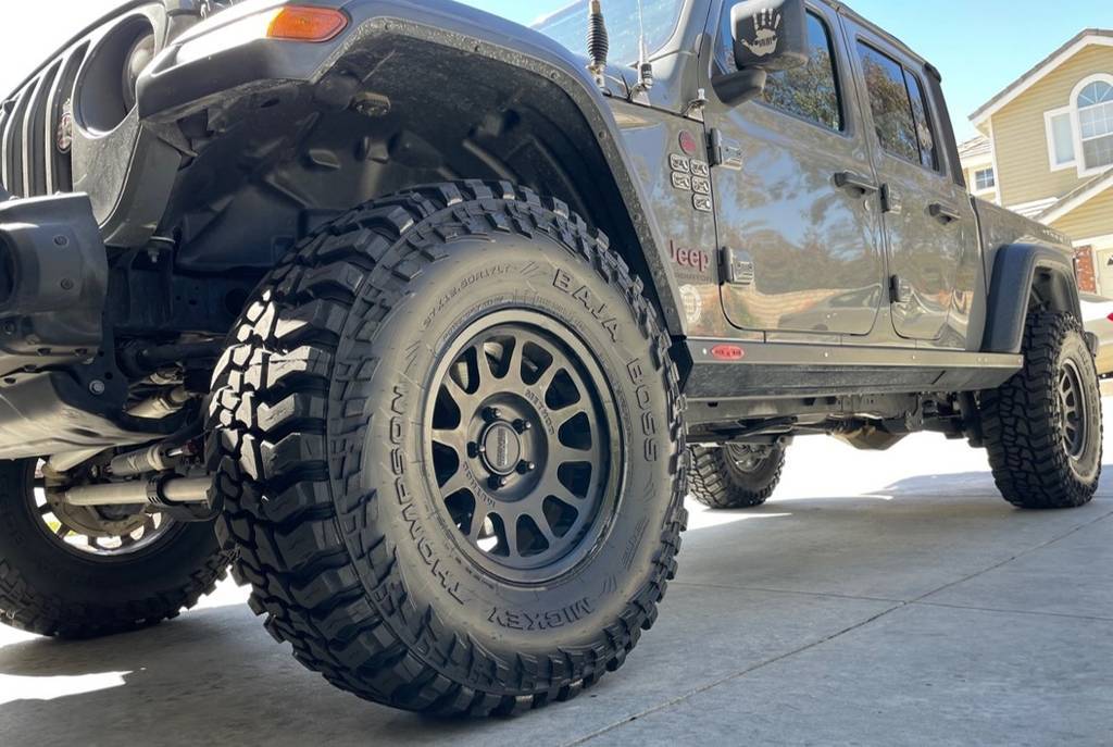

Yes, those are 37" Goodyear Kevlars, and since that picture has been taken, I have put on 37" Yokohama Geolandars MTs, and now have 37" Mickey Thompson Baja Boss M/Ts. I can recommend the Yokohamas, and the Mickey Thompsons -- stay away from the Goodyears. I have Rubicon Fenders, so, they have more clearance, but, I have never had a clearance issue with all those tires. No, personally, I would not go lower than a 3.5 inch lift. The Gladiator easily manages that lift. After all these years, the Clayton springs have not sagged, so, this really speaks well for the lift kit. Here is a more recent picture with the Mickey Thompsons.
Changing the front drive shaft is recommended on the 3.5 inch lift. Lot's of guys do not do it. I did make the switch... The stock driveshaft is thick - I think the issue is that, because of the angle, there can be an interference issue on the transfer case side of the driveshaft.... You can maybe get around it by pointing the pinion angle up - using your adjustable control arms, but, positive caster is gained by pointing the pinion angle down. So, it is a trade off. Good positive caster gives you better tracking and the steering wheel automatically going back to "zero" better after a turn. Try for 6.3 to 7 for Caster. Note: I am running approx. 6.9, and I really like that setting. For you, Probably closer to 6.3 or less for you to keep your pinion angle better for your driveshaft... If you get wobble, or bad tracking (ie. tires grabbing grooves on the fwy), then, you should know that more posive caster (pointing the pinion down more will help you. Only turn the control arms "half a turn " at a time and test. Of course the driveshaft interference at the transfer case is easy to test... Just use your jacks and set the front at full droop, and turn your drive shaft by hand to see how it works.

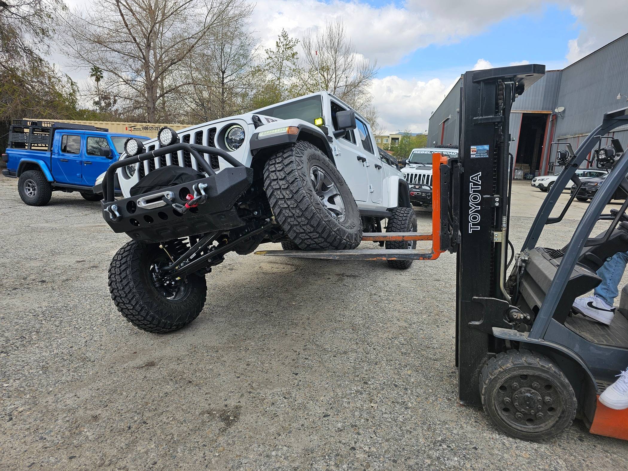

Here is mine sporting 37s and NO LIFT... only rubs a little...:LOL:
