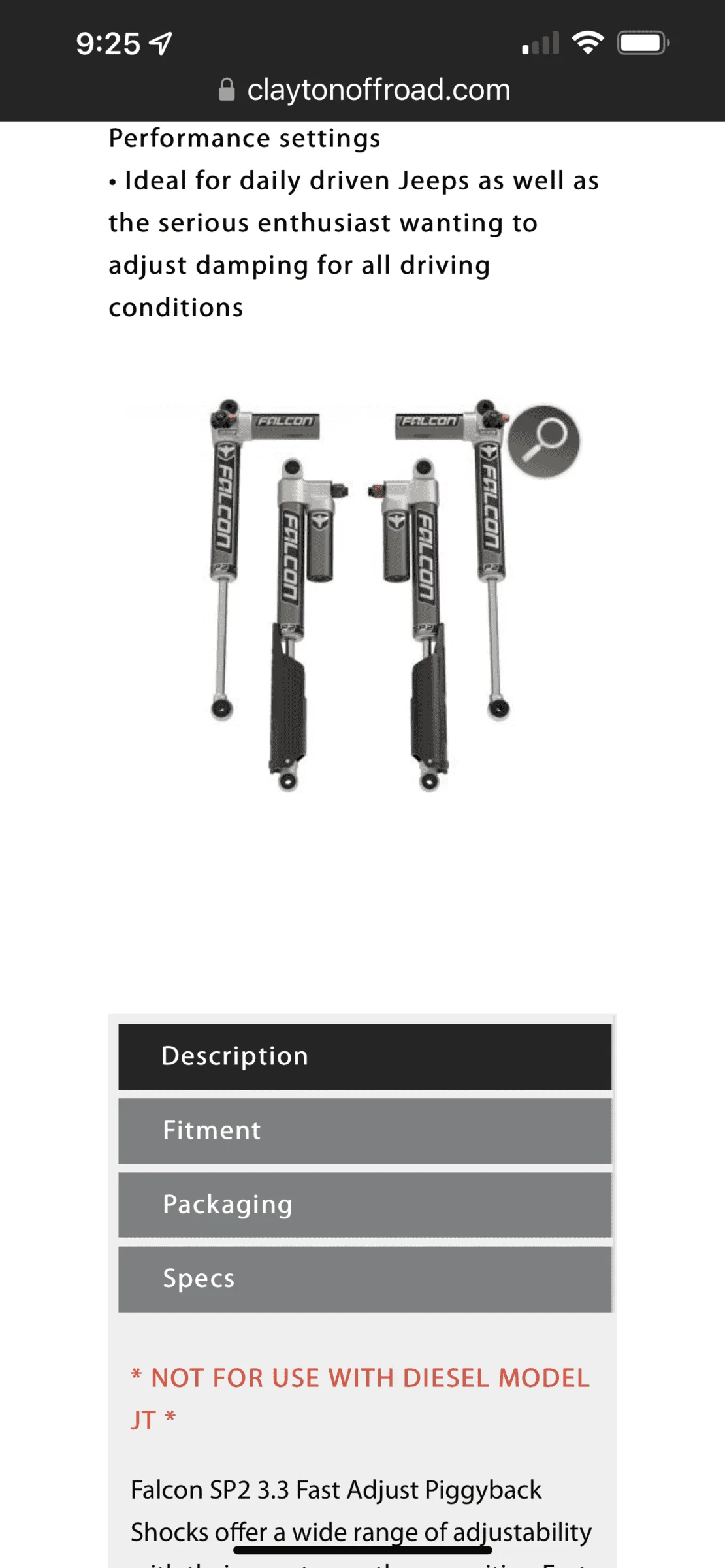

I was thinking about this lift and was really wanted the adjustable falcons, but they seem to be not recommended.
So what adjustable shock are being ran with this kit?
Jeep Gladiator Clayton off road Diesel 3.5 premium lift ?? E211515D-1443-448E-B200-A12272BDA1AB
11,503
30,683
They don't fit. Think it's because of the aux battery location. The right front shock reservoir and the aux battery are in the same location from what I have read.

They make a diesel specific version
eeTwidget
Mar 21, 2022
70
63
USA
2022 Gladiator Rubicon Diesel
For the lift, not for the shock.
No, for the shocks too. The lift kit will have ecodiesel specific springs and falcon makes ecodiesel specific shocks. The shock has a shorter res
