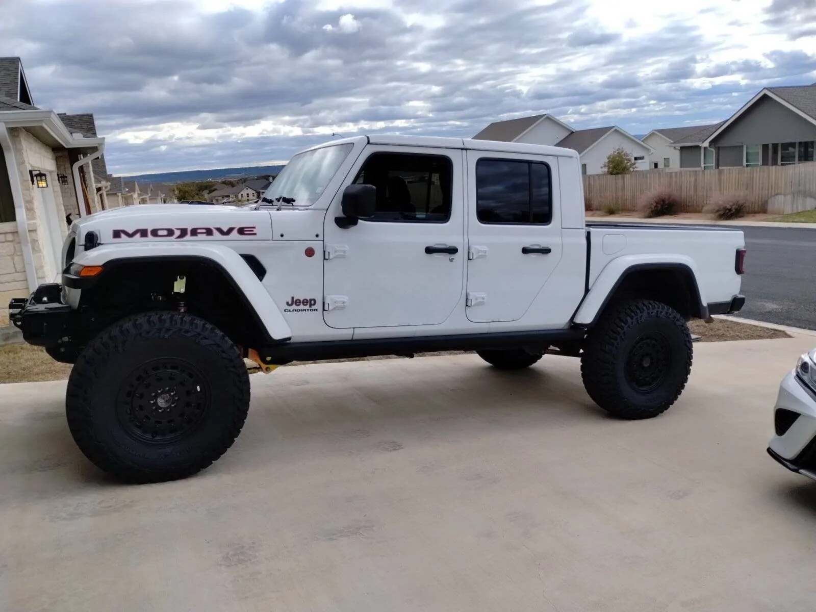

Keep in mind, your final "lift height" will also depend on what accoutrements you add on later, if any. Heavy bumpers, winches, belly armor, etc. For example, I have steel front and rear bumpers and a Warn winch. MC 3.5" gave me 4" of lift.
Photo for reference...
Jeep Gladiator 3.5” or 4.5” lift for off-road 2918016600793201062
