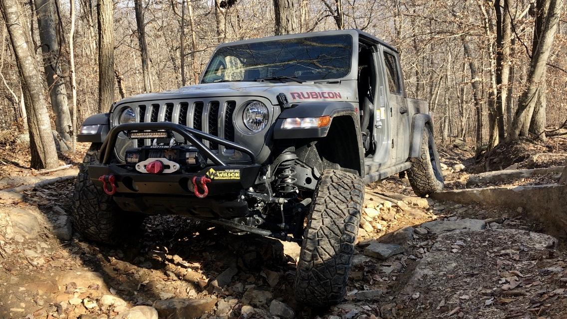

A JK front bumper can be installed on a JT/JL by simply enlarging 2 of the 8 mounting holes. I did it- It’s easy.
Awesome - I mean not just the answer - but the pic, too. Damn, too much fun!
We just don't have anything like that around here. All clay, mud, rivers, farm ground, no places to play. If you go off road here you will be greeted by a shotgun blast as the farmer or owner chases you off.
