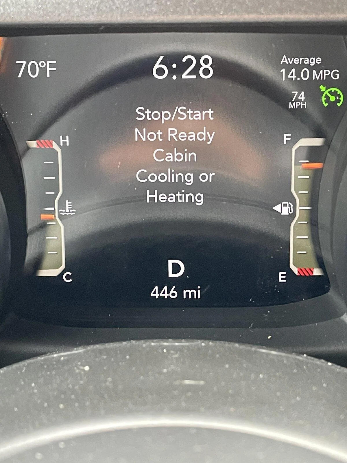

Mine has worked only once since I’ve gotten it almost a month ago. My cluster shows the message about cabin heating or cooling. My AC is not set to LO either. Messed around with brake pedal pressure as well. I’m not mad because I don’t love (or hate the ESS).
And mine tells me if it's not working because of battery charging, cabin temperature, or engine temperature, etc.
If you have the AC set to 68 and it's not yet down to 68 and the AC system isn't to the point it could maintain temp with the engine off, it won't shut down. When mine does on a hot day after about 40 seconds or so it starts again.

How about if not using AC? We had a couple mornings in the 50’s or afternoons in the 60’s where I didn’t have AC/anything on. Still have same message.

Was it actually OFF, disabled, or just not set?
Mine is the exact same.
2500+ miles, and not once has it kicked in.
Maybe some old school engineers at Jeep got tired of the ESS and made changes in the software so that it virtually never kicks in...lol
That guy would be a hero in my book!

I've had mine in the last 2 months start occasionally giving me the start/stop error light and a quick message pops up then goes away. When I scroll to the page it just says something like "service the start stop system" it has yet to say why it isn't working. I hit the button to turn it off immediately after starting the engine so I don't care that it has been finnicky, still weird though.

If I was you I'd take it to the dealer to have the battery(s) checked - the fact it's seeing an issue could one day leave you with a dead battery.
You can always keep turning it off that way or later get a device - but I do suggest getting it looked at. My wife's Grand Cherokee got to the point both batteries needed to be replaced.

Have a 21 gladiator and a 19 wrangler both with stop start . Just had to have the battery for the stop start replaced on wrangler . If it goes bad the battery doesn’t charge therefore stop start doesn’t work . Dealer fixed it no problem .
