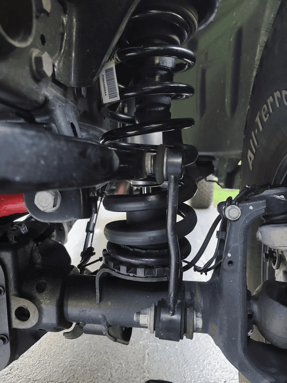

Look at these pics. The first one is having the WRONG isolator installed on the driver's side. Look how close the spring is to the spring perch in the front:
Jeep Gladiator MOPAR Lift $2k Now? 1665013504162

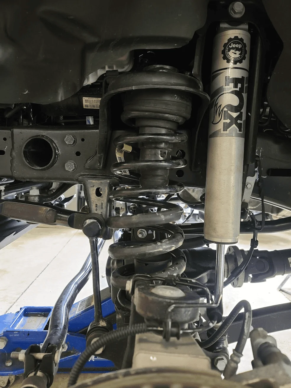

What you can't see, is the the spring is bowing forward because of this... but here it is:
Jeep Gladiator MOPAR Lift $2k Now? 1665013551142

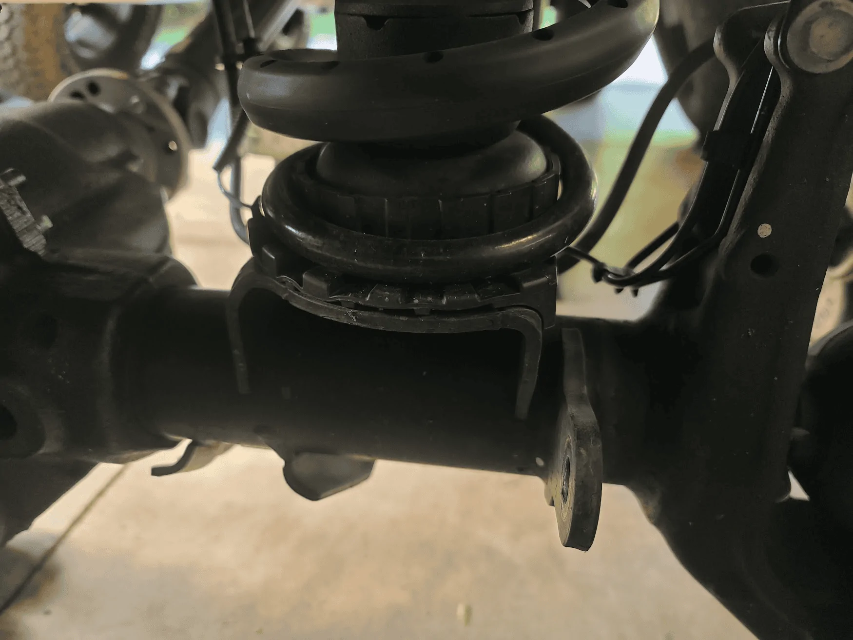

I have no idea how I drove it this long and didn't notice... a real head-smacker. Anyway, THIS is the correct isolator:
Jeep Gladiator MOPAR Lift $2k Now? 1665013632984
I didn't take a sideways pic of the bow, but it's 100% straight now. Notice the extra spacing between the coil and the perch now. It's maybe 1/2" but makes all the difference.
Anyway... pro tip for anyone installing the kit!

Yeah, each side is supposed to bow outward. I think that's what it says in the instruction sheet. At least you found out before it made a difference.
