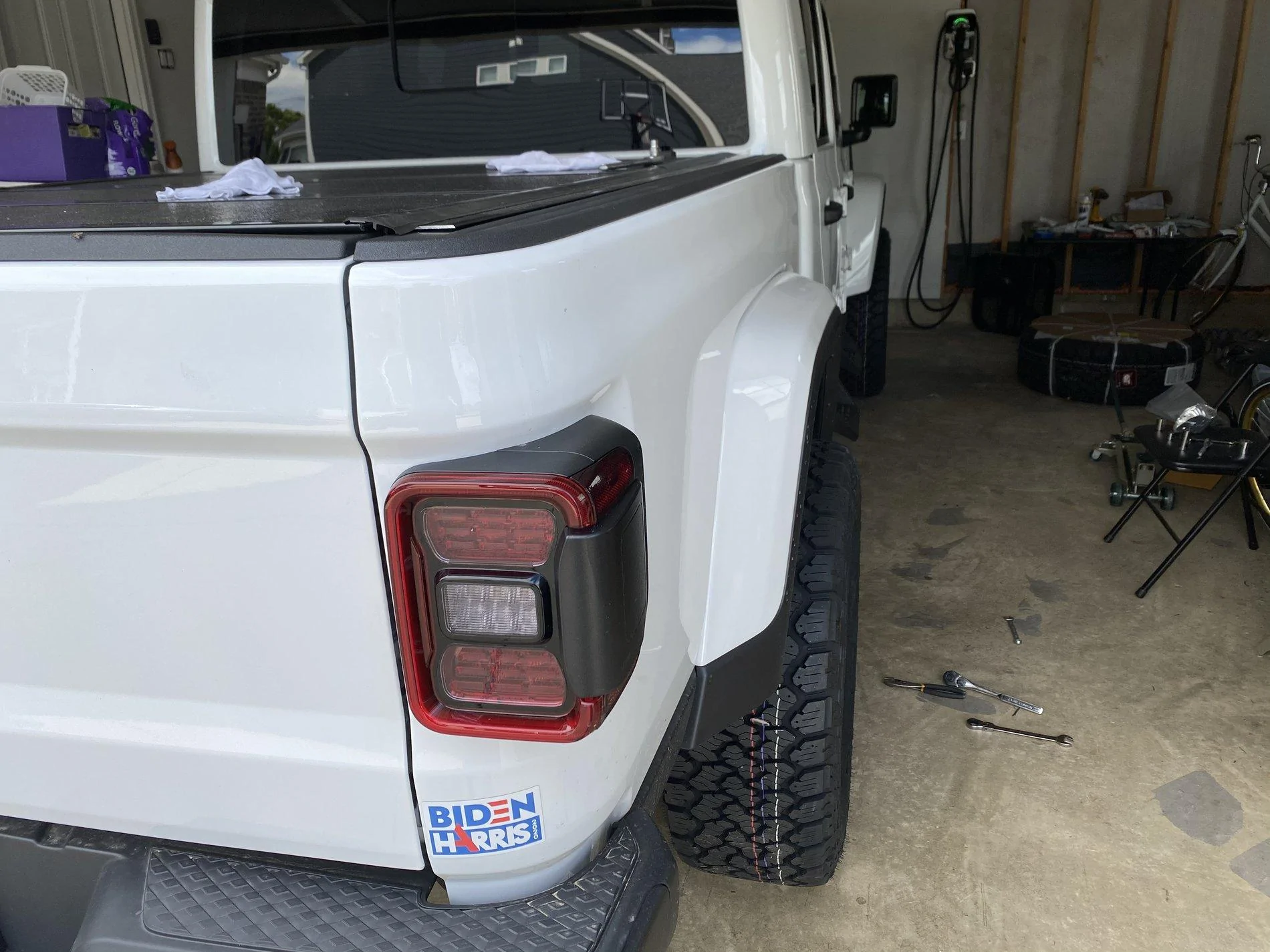

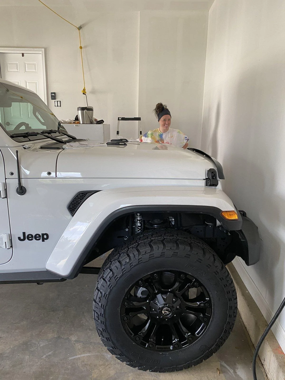

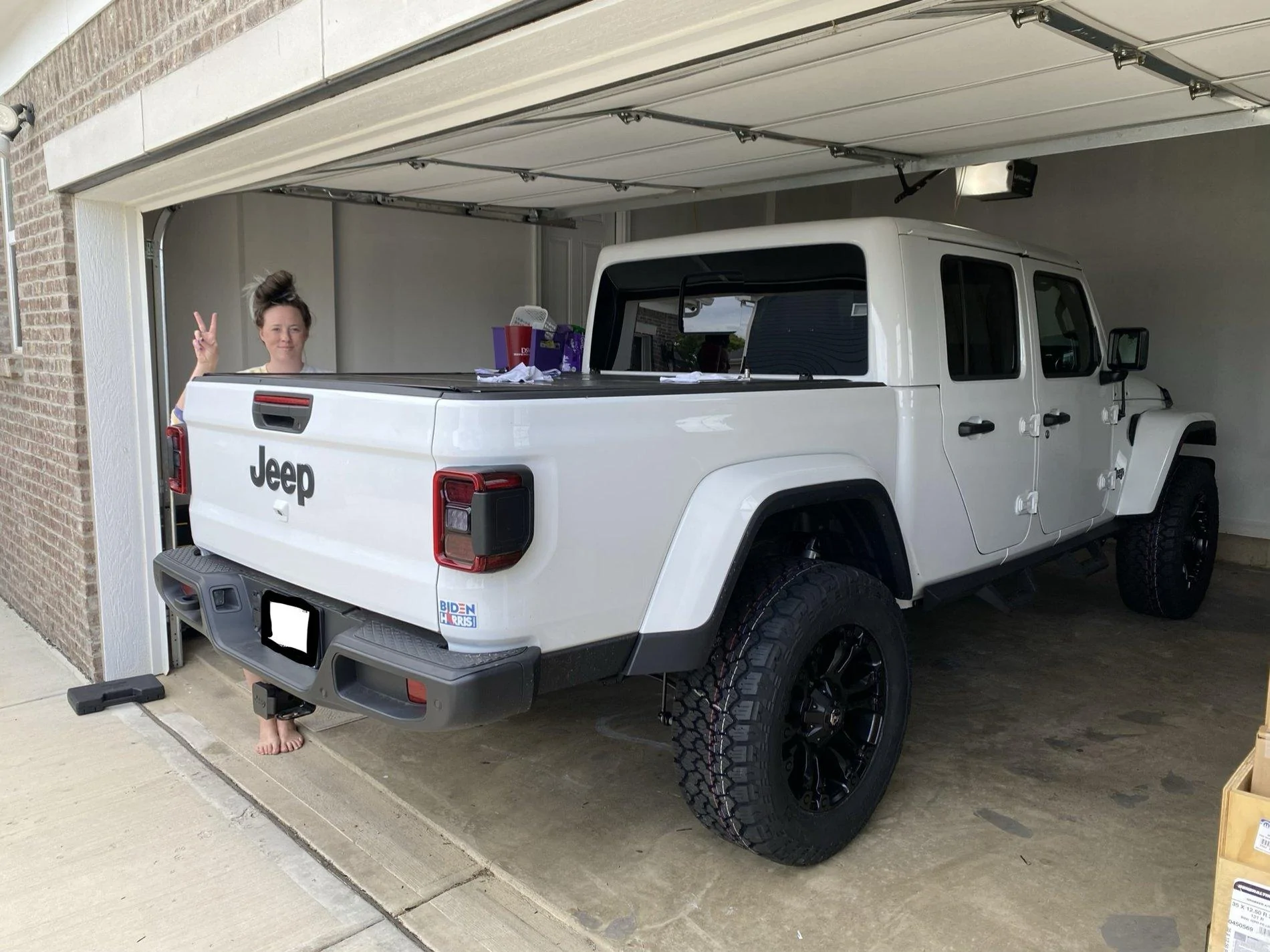

Wheels/ tires and suspension lift installed. Now sits at 77” tall with hard top on:
Last picture you can see the tires stick out a little less than 2” past the stock fenders. That is exactly what I was going for (whew!) Also, the wheels are +22mm offset so hopefully minimizing any undue stress on the axles.

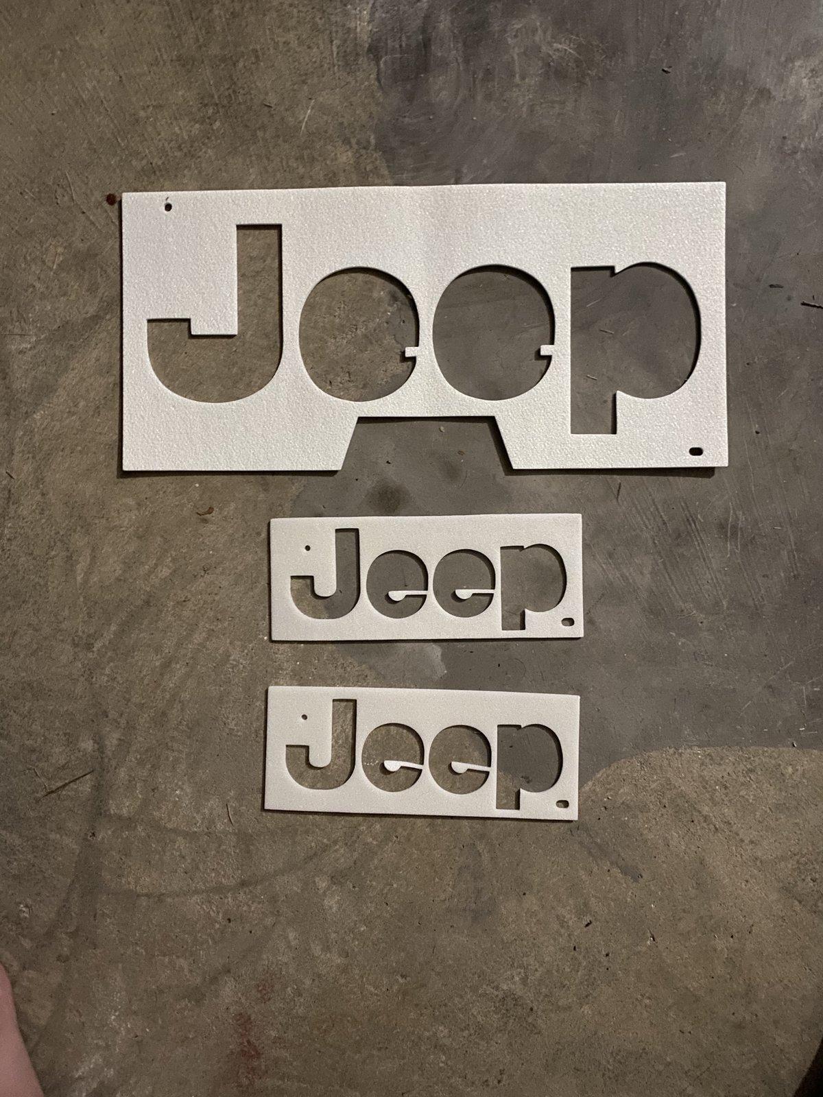

Not hard at all. Use a hair dryer (recommend NOT using a heat gun as they can get things WAY too hot and you may blister your paint if you are not paying attention) and fishing line. Start at one corner and pull the fishing line down and diagonally behind the badge while applying heat. Take your time is the best tip I can give. You can rub off most of the adhesive residue with your fingers while it is still warm. After that, clean the remaining with goof off, then wash with dish soap and then rinse with water and dry off. Then apply your new badges. I also marked off reference points with blue painter’s tape to ensure I could apply the new badges straight and in the exact same location - usually after I removed the badges but before cleaning off all the adhesive residue. The badges come with foam that helps with alignment (see pic) - I just put the tape around that and then lined it up when applying new badges. Good luck!

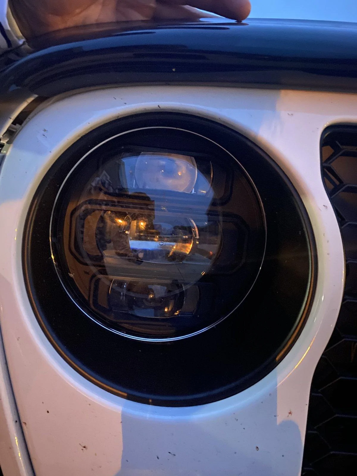

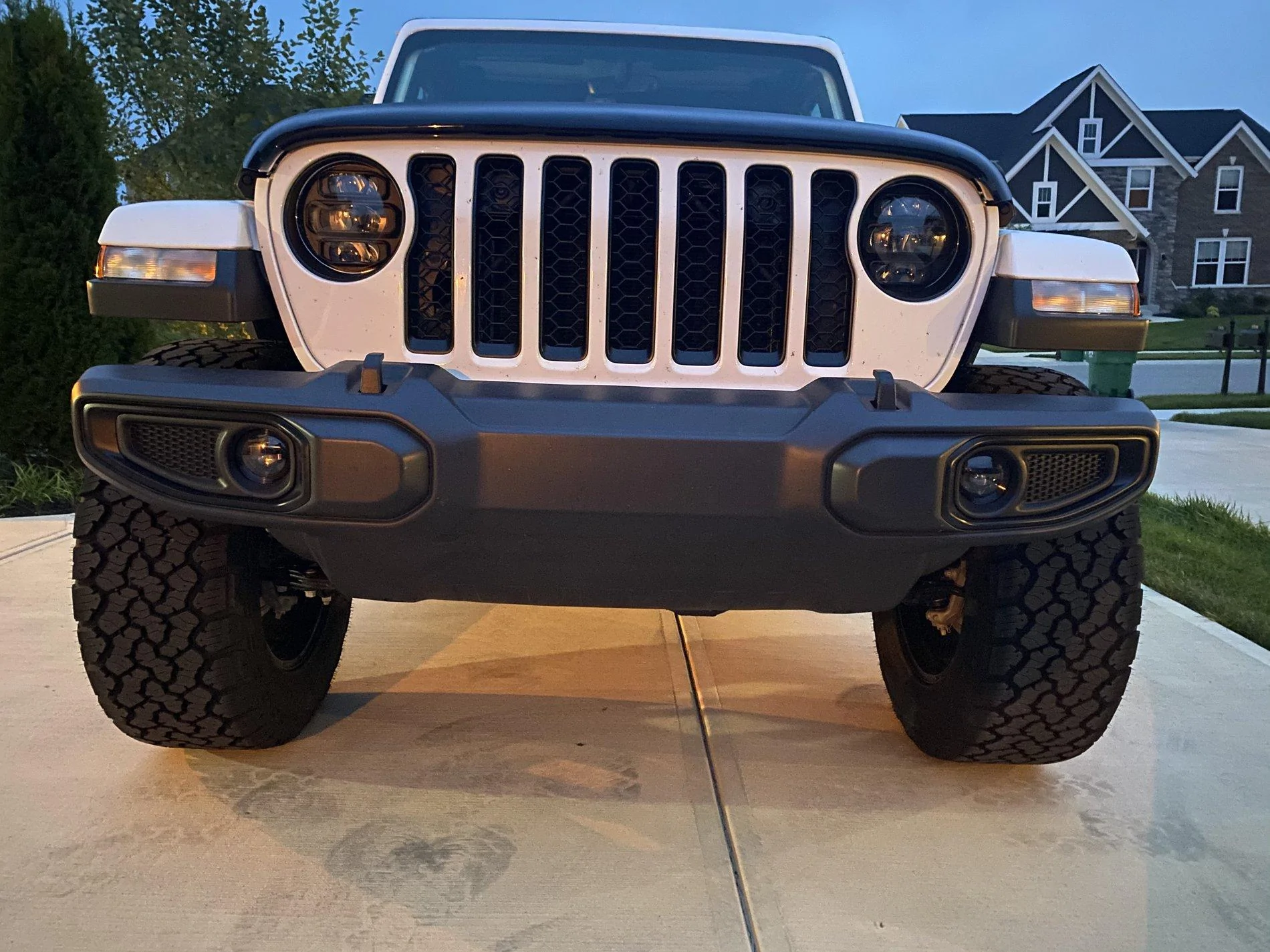

Anzo LED headlamps and Mishimoto LED fog lights, MOPAR black grille insert kit and black bumper appliqués... @Metalcloak front bumper and skid plate as well as quake smoked sequential LED DRL/ turn signals coming soon!
Jeep Gladiator 2020 Gladiator Overland 3.6L 12545FE3-55FB-4BC1-9ED3-C28801C5B41A
Jeep Gladiator 2020 Gladiator Overland 3.6L 195605E1-EBC4-43FD-A449-554B3145A987
Headlamps initially flickered but Superchips Flashcal took care of that. Also pictured Weathertech bug deflector but I will be replacing this with AVS Aeroskin II with the new hood.

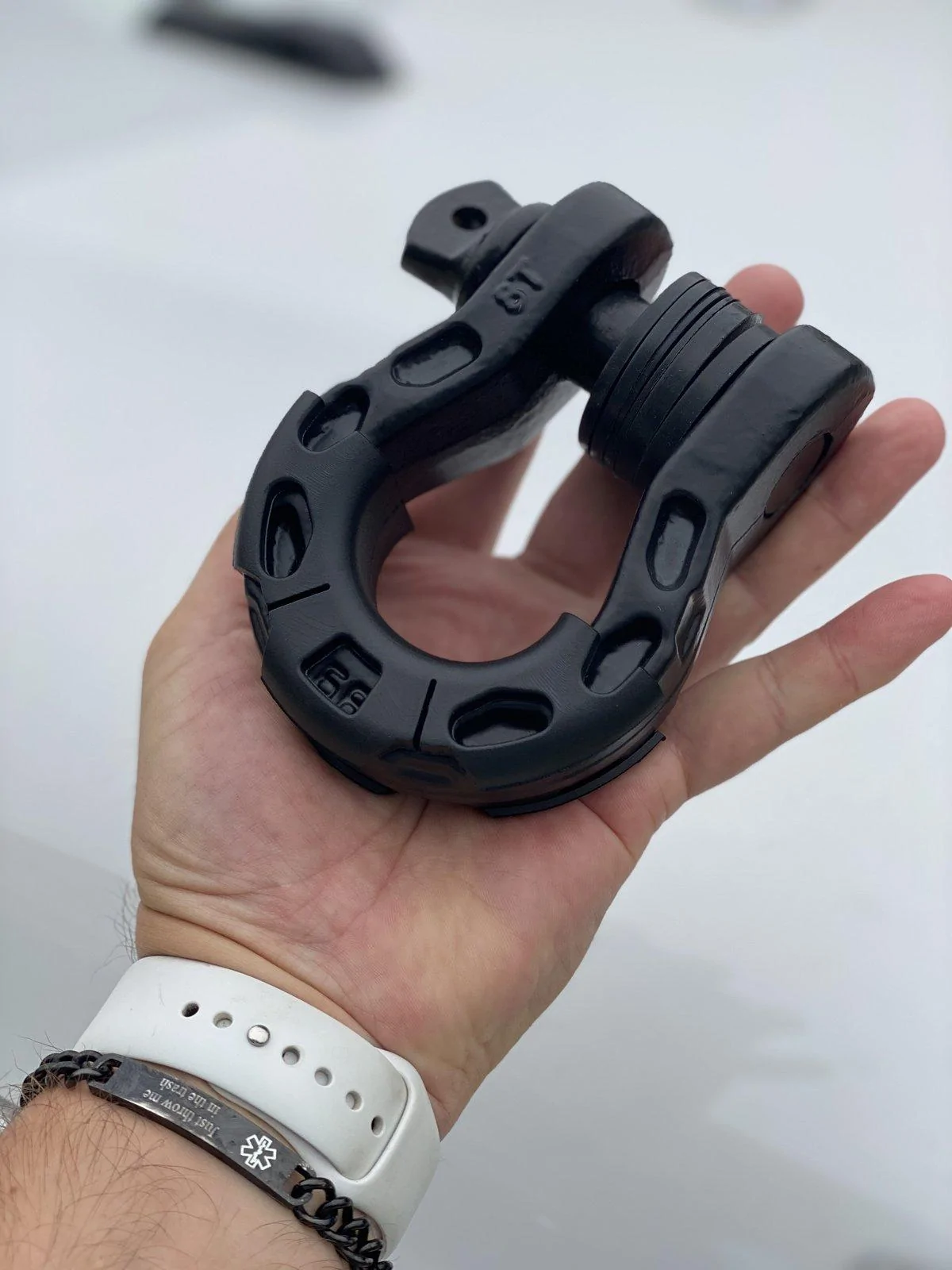

I bought some GearAmerica Mega Shackles and isolators during the Labor Day sale to put on the @Metalcloak bumper once it arrives and I have to say... these are the most solid, well-finished D-rings I have ever seen. I feel like they could charge way more for these beefy bastards

Don't give them any ideas!
(and LOL at your medi-alert braclet engraving!)
