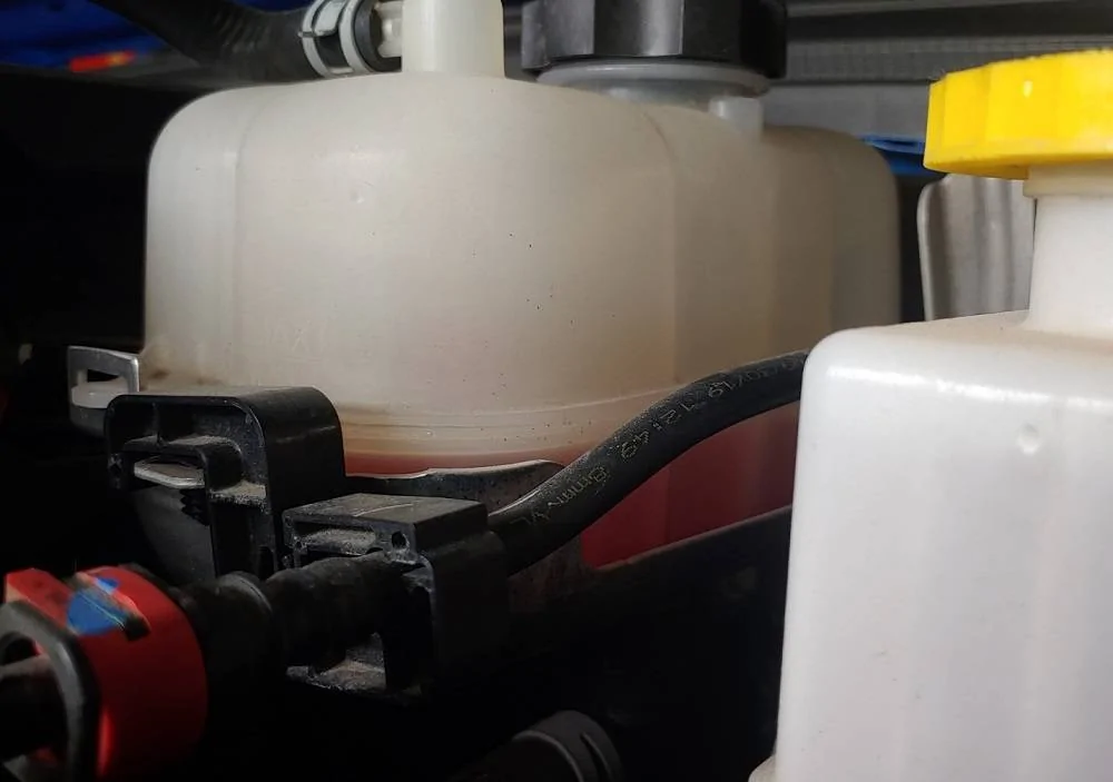

What's the coolant level in the reservoir on the firewall?
Jeep Gladiator 2020 Overland with a few issues - need some advice coolant-level
Is it possible the misfire is due to coolant getting into #1 ?
Is the coolant TRULY low and is it truly over-heating or is the temp sensor bad?

Well. 3K down. Still overheating. New cam on cylinder 1 for the misfiring and a recommendation for a second engine tear down 'to see' if that fixed the engine eating the radiator fluid. Traded it for a RAM. Got 30K. I miss it already, but it was getting too expensive. Happy Jeeping all.
