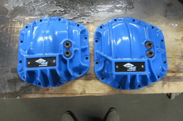

No matter which diff covers you get. You can reuse the oem diff cover gaskets.
I have the Dana Adventak covers in blue.
