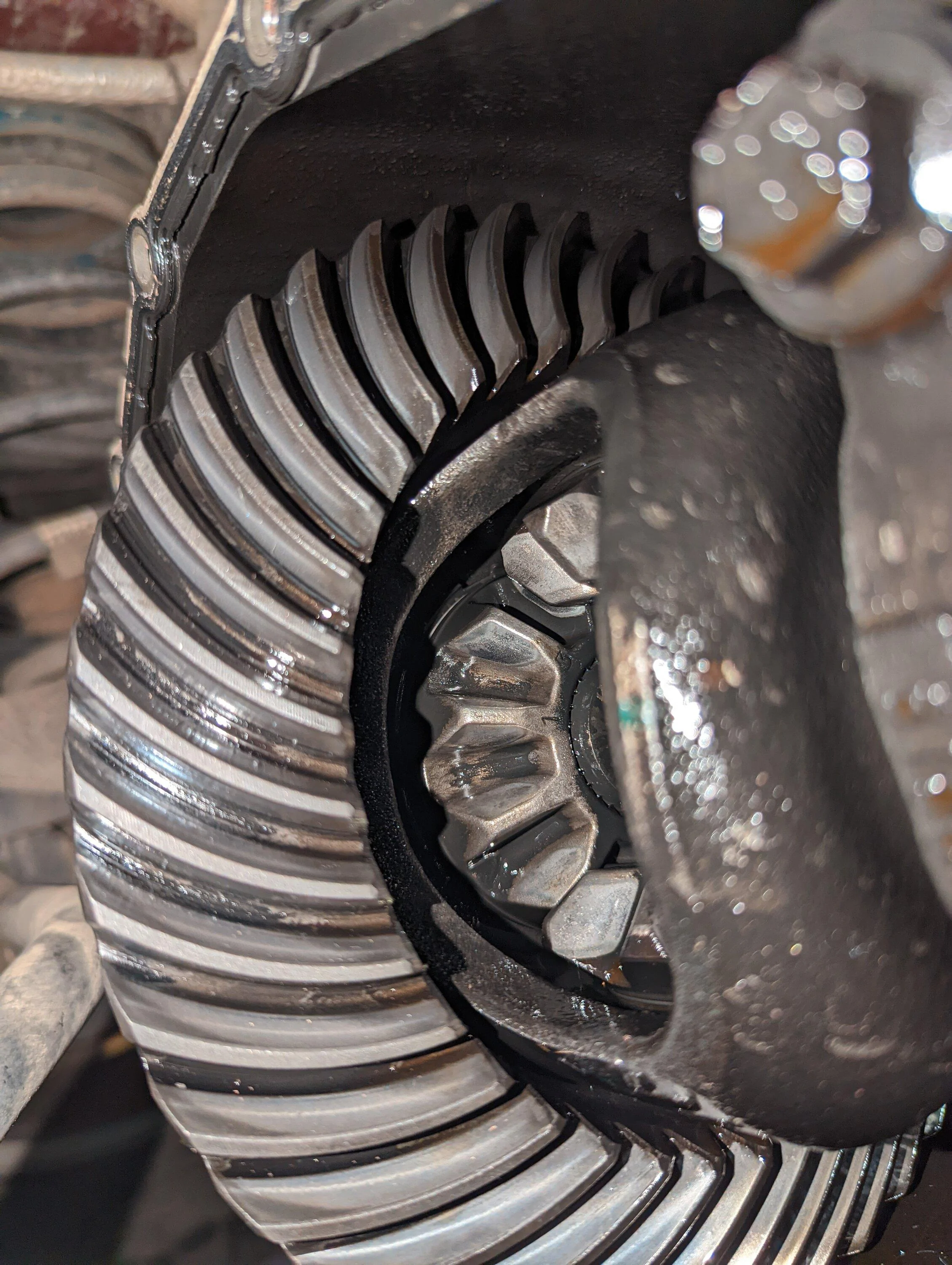

Hey crew. Have a '20 Overland that is having rear end noises/issues at only 75k. Anyone had similar issues or thoughts on a resolution??
Started with a light hum and turned to more of a gear-to-gear sound last week. No clunks or clanks, is there whether in 2 or 4wd, in or out of gear, cornering makes no difference, and gets louder with vehicle speed. One local shop took a ride and then jacked it up to isolate it to the rear and suspected the pinion bearings were going. Not a major off-roader but has been up a hill or two, has never been molested for gearing, and stock everything. Manual 6 speed with 3:73s from factory.
Not real happy to hear with only 75k on it and on top of that I can't get a call back from my usual service writer or even the service department as a whole. I popped the diff cover yesterday to see for myself and all looks good, other than the few shards I found on the drain plug. No play in any of the gears/bearings that I could find without being jacked up.
From all I am seeing this isn't a typical issue for these so really curious what's going on and if Jeep will be of any assistance going forward.
Looks like in that first pic the pinion has been eating the differential case? If thats is so, something is oviously moving in there.
Hard to tell from that angle you took the pic though.

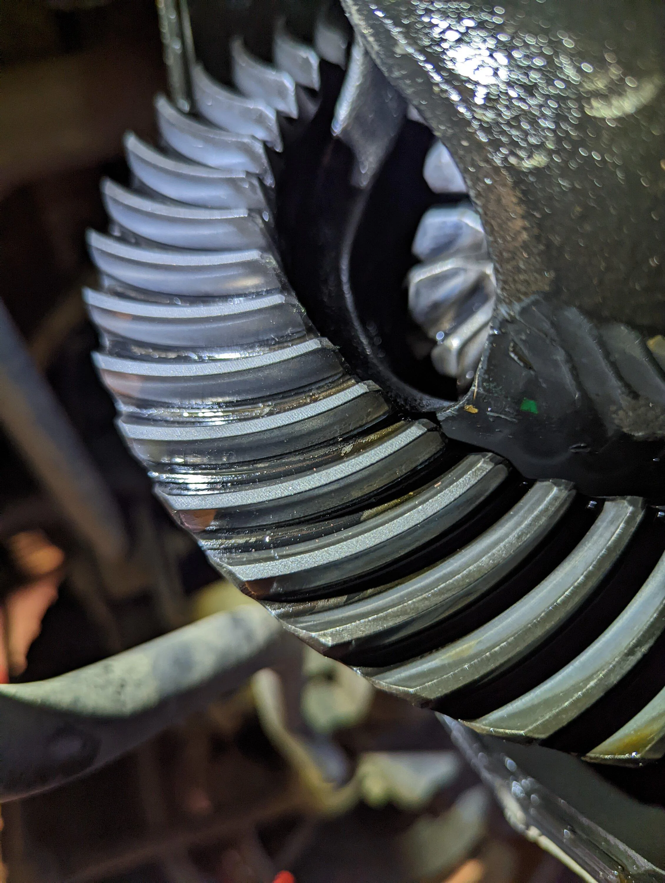

First of all, sadly, my issue still is not resolved. Long story short I still have a noise from about 50-60 mph.
I took it to another shop that I have used many times before for axle and driveline issues to have them pull things apart and inspect everything. They have done work for me a few times in the past. All they do are axles and drivelines. Also, they mainly deal in Yukon gears because as they said, they are the best out there in aftermarket gears.
The tech working on things drove it initially and said he definitely hears the noise and that it really should not be there. He and the owner did clarify that even if you get them perfectly set up, a deeper ratio may still make some noise. He said that they have about an 80% success rate in getting quiet operation out of Yukons.
After driving it, they pulled the rear end apart and after testing and inspection, said the gears had been perfectly set up and the pattern, backlash and pinion depth all looked great and in spec. But one of the first comments he made to me after pulling everything apart to inspect and finding out these were Yukon gears was, "That's not a Yukon gear". He said that recently over the last year or so he has seen where someone will order a Yukon gear set, but what comes in the box won't be a Yukon gear as he knows it. Basically they source a gear from somewhere else, but it really isn't a Yukon manufactured gear. But it seems to be happening a little more common these days with other manufacturers as well, as the supply chains have really been pinched. After doing countless gear changes over the years, he can really tell by looking at things if it is as described, especially when it comes to Yukon.
So my gears are running perfectly fine and wearing normally, yet they are a bit noisy from 50-60mph. At this point I have not had the truck for so long due to being in and out of shops that I am just going to have to deal with the noise for a while longer as I have a few trips/moves that I need to use it for.
