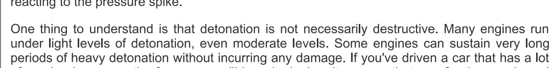

This is from a GM engineer - and I 100% agree as I've driven performance cars for decades, and have built the engines for same ->

I guess, I post this again from a GM engineer who is responsible for the Northstar engine -
Jeep Gladiator 2021 3.6 MT Detonation 1661349740843
