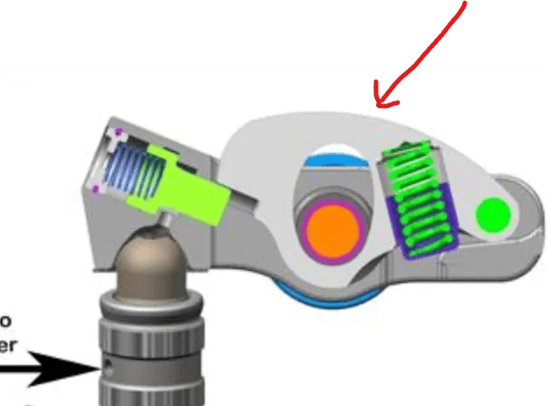

Here's the part that runs on the cam being talked about in that video's first several minutes -
Jeep Gladiator Interesting 3.6 Tear Down. 1704057588096
Worse than a roller - it's a rubbing part more like the lifters in a cam-in-block egine........ but the same result, yeah, if there's metal wear even only to the point it can be barely seen or measured, it will show up in oil samples.
