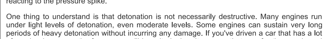

Why can't people accept that it's not a killer, especially "occasionally".
The dealer is going to refer you to the book and say "ignore it, it's normal"
99% don't give any ping, but the few that may - and I say may as it's not been decided that ALL are true detonation, it's not something to lose sleep over.
I guess, I post this again from a GM engineer who is responsible for the Northstar engine -
Absolutely temperature IS a factor! Cool engines do not detonate. Only hot engines (fully warmed up, and I don't mean "coolant temperature" I mean the entire engine) warmed or above normal.
If it's not reach normal operating temperature and been there for a while, it's not detonation.
......... has anyone given any thought to other factors? Crap oil that's not up to modern specs can cause a ping.
