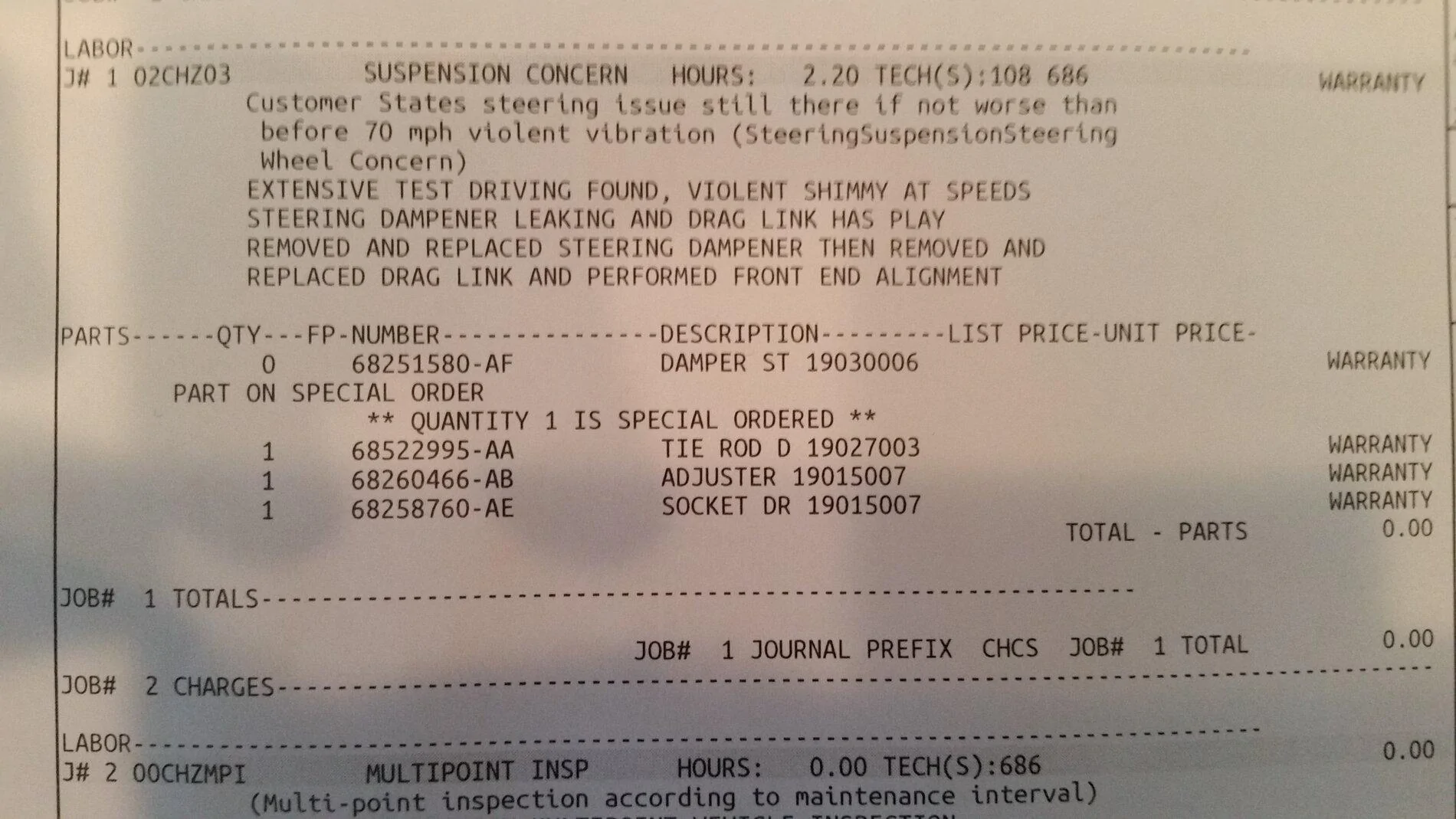

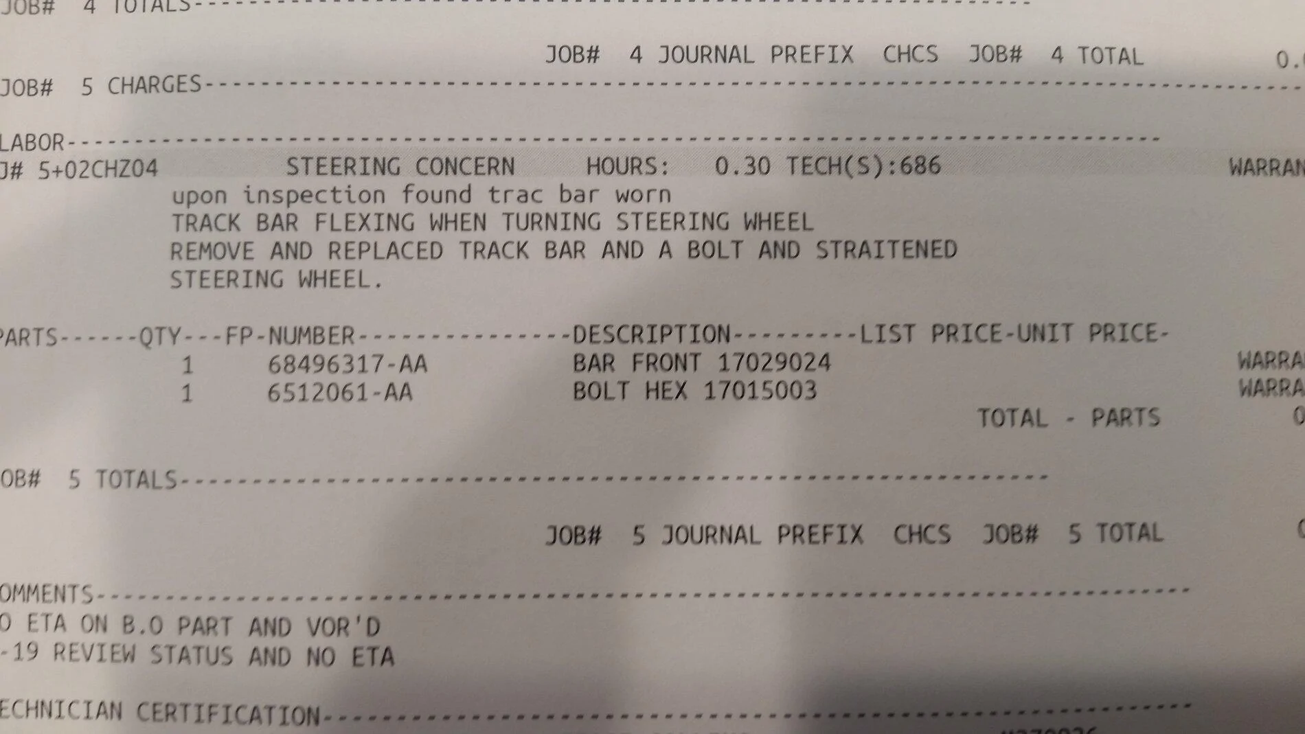

Are you able to provide a list of all the service updates that were performed? I am curious to see what they are currently doing relative to front end steering
This is what they did...
