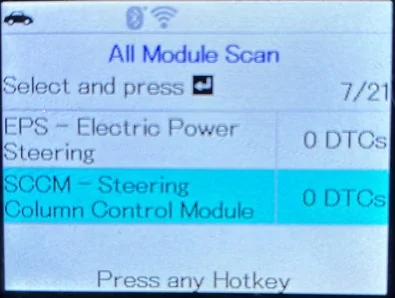

Yesterday I had a scary experience on the highway when my electric power steering (EPS) stopped working. The JT was completely up to temperature, had been cruising at about 70-73mph, and all of a sudden I felt a slight 'tug' at the steering wheel and noticed the power steering was no longer working. Now, immediately before the EPS shut off, I went WOT for about 2-3 seconds to avoid snow coming off the top of a semi trailer, then took my foot off the gas pedal, and a second or so after that is when I felt the 'tug'.
Initially I thought I had a tire blowout, but I immediately checked tire pressure and everything was OK. Then I checked voltage, which was also normal at 14.6-14.7V (which is in range for where the voltage has always been).
I can tell you that this vehicle is VERY difficult to steer without EPS, even on the highway with minimal steering inputs required. If one of my kids or my wife was driving, this could have ended very badly.
I was able to fight the steering to take an exit, and as soon as I slowed down to about 20mph to make a right turn into a parking area, the EPS started working again. I stopped and did a cursory under-hood check at idle, but noticed nothing unusual.
The rest of my trip was uneventful. Drove another 75 highway miles, shut off for about 30-40 minutes, then drove about 150 highway miles back home. I brought my son to school this morning, no issues.
I scanned for DTCs as soon as I got home yesterday and there were no codes at all. Here is the screen showing the steering modules:

I had that same issue in a '20, and it the dealer replaced the steering control module. Then it was under warranty. I found that once I got under a certain speed it would start working again.

Mine has done this exact thing a few times.
Always kicks back on under about 20mph. With 40s when it shuts off its scary.
To replicate;
Has to be wide open throttle
Stereo has to be up with subwoofer amp up etc
On the shift it cuts out and doesnt turn back on until you slow down for a few seconds below 20mph.
No error codes dealer cant figure it out.
I think its the starconnector.

The only time mine ever did anything similar is when it turned out that my main battery was failing. It’s been fine for a year now.

A couple of times it happened before I took it to the dealership. It's scary at 70mph and good thing I wasn't going into a turn. I didn't have any issues after it was fixed before I traded it in. It was an intermittent issue as well. That gladiator also would lose its speedometer display. Something was ost definitely lose under the dash. I could hit the driver side tweeter and I would come back on.

10x it has reduced as of late. Only when my subwoofers or stereo was all the way up now. Hasn’t done it in 10k miles.
11,790
31,485
A couple of other people have reported the same thing. One of the easier things to check for is the ground on the chassis for the power steering. Either paint or some corrosion could be causing an issue. .
