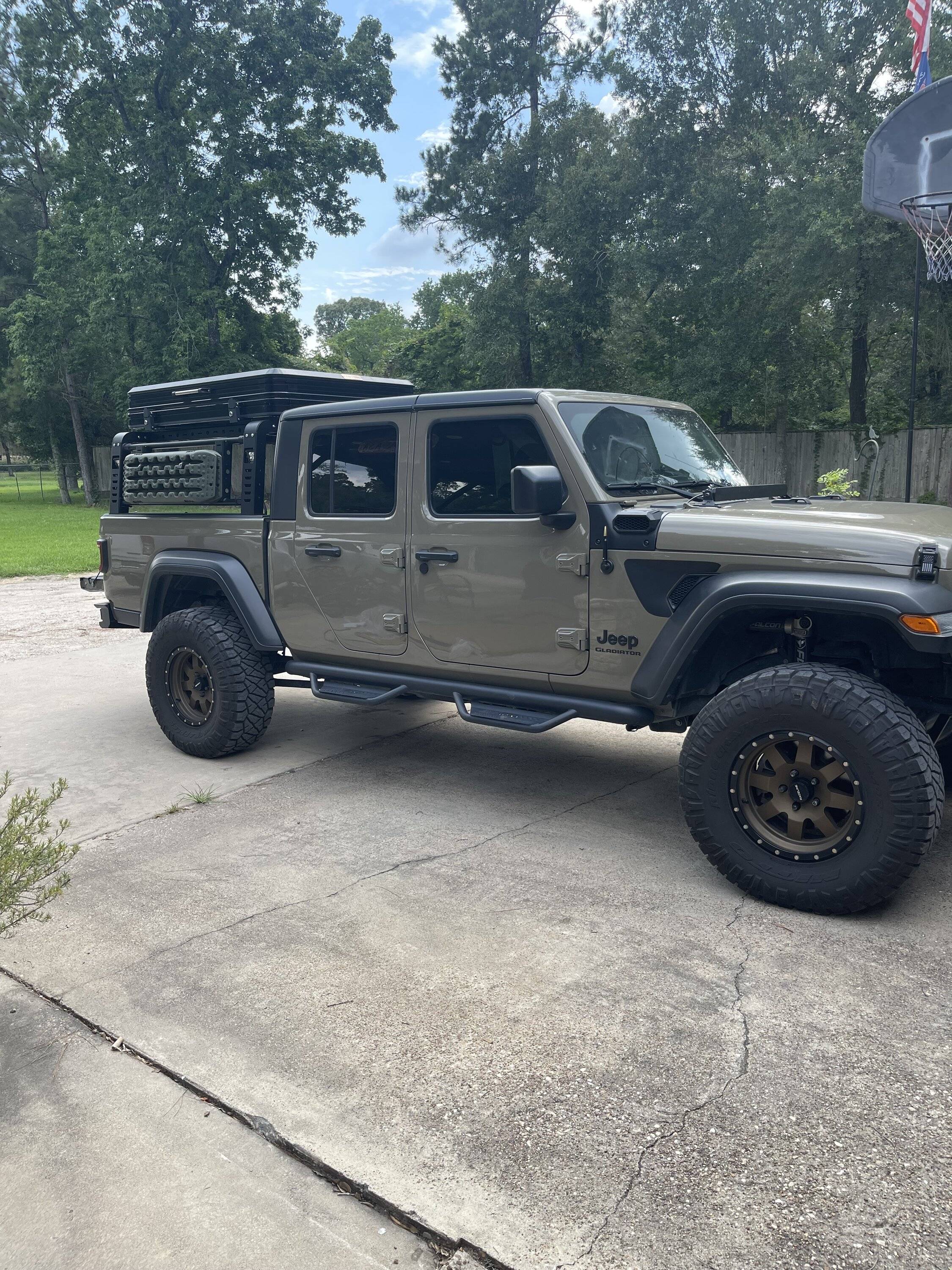

Oh I ran codes which showed none tried another switch:button. Checked fuses , checked grounds. Etc etc. I do most of my own shit and don’t like dealers but when it comes to computer and harness problems I’m kinda stuck ya know. My keep started off as a stock gladiator and has evolved at my own hands into a capable overlanding rig
