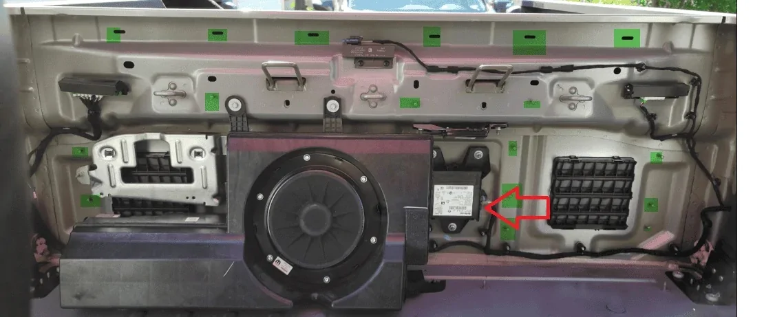

I would be focusing on the Radio Frequency Hub (RHF) on the inside back wall behind the rear drivers side passenger seat. Water leaking from a back window leak has been known to get into the RFH and cause starting problems.

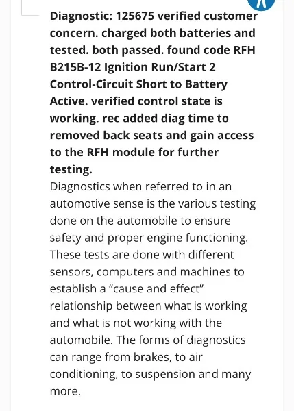

Here is an explanation of what they are doing. They gave this to him today.
ignition circuit... behind back seat... why do new cars have to suck so much?
