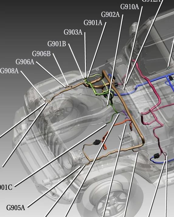

I checked the grounds near the battery and the one over near the driver's side footwell. Is there a dedicated power steering pump ground?
The power steering pump is grounded at G908A, located at the right front of the engine compartment.
Jeep Gladiator Power Steering Shut Off On Highway grounds
That ground is a PITA to get to with the air box installed. I was able to get a box end wrench down in there and tighten it up a little. It wasn't loose, but it certainly wasn't fully tightened.
