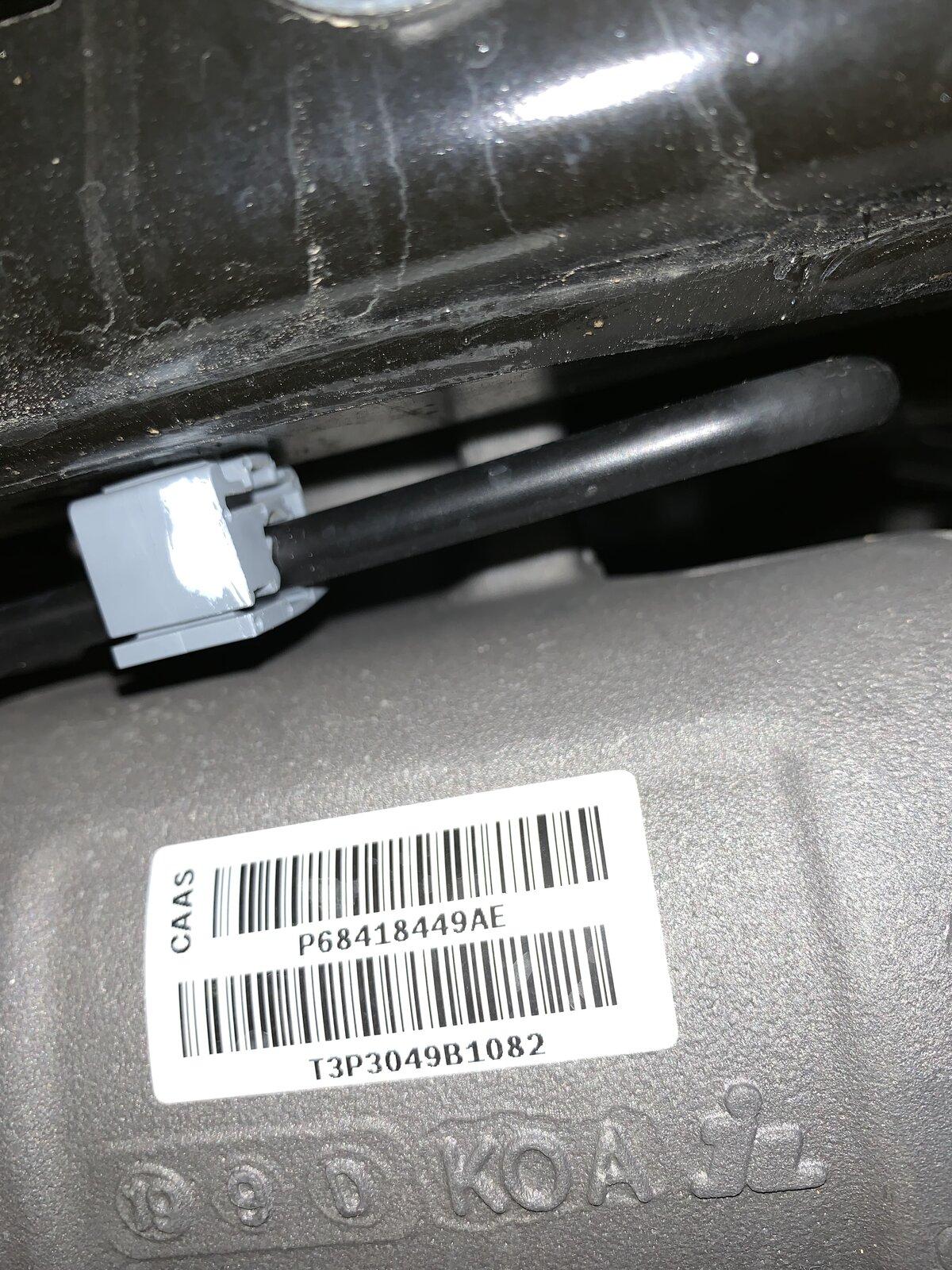

I am attaching a picture of my 2020 Rubicon aluminum steering box/gear, part # 68418449AE. It was replaced with a black steel box, part # 68507569AA. This was done back in October 2020.
Our JT now drives like our JK Unlimited did. It really is a night and day difference from the original aluminum box. Also, I attached a write up about how the power steering system now works. It is controlled by software. I keep thinking that the "wandering and darting" we experienced originally might have been due to software causing the electric motor steering pump to over compensate in some way. Or to be too slow to respond to inputs since it only works when you are steering.

Did you replace just the front ones? Also...those that ordered a steering dampener which one did you get? What do you guys think of this set up?
https://www.quadratec.com/p/rough-country/n3-dual-steering-stabilizer-jeep-wrangler-jl-87304
Seems wicked cheap...like 1/2 price of the fox single set-up.
I did, but only because mine got dented up. I went with the fox, but there wasn’t that much of a difference. I’m still on the aluminum steering box, drives perfect.
