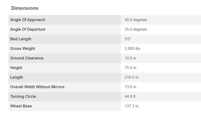

I have been told that my 2021 Willys JT comes with the same suspension system as the Rubicon just with different shocks. Other than the difference in stock tire diameters, they have, for the most part, the same ride height.
Is this true?

I’ve seen that as well. I thought maybe it was a 2020. Any idea how the springs are different? My impression was that the Willy’s springs were the same height, but not the same rates.

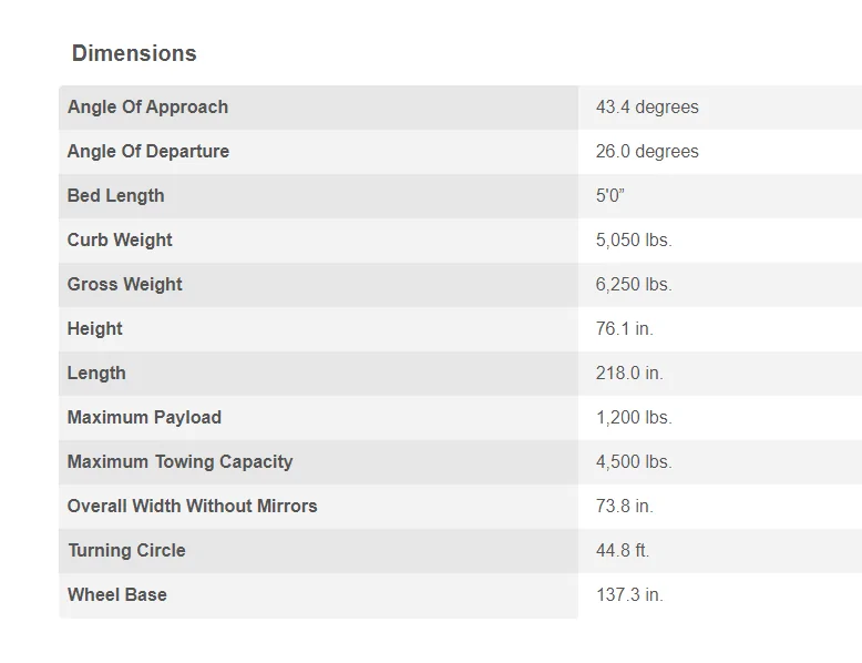

That chart from edmunds shows a 4,500lb towing capacity for the rubicon. It’s 7,000. I’d look for specs from Jeep. For the rest.
Regarding the suspension, I’m under the impression that the Willy’s and Rubicon get the same shocks, but not the same springs.
It's accurate at 4500 towing capacity on the Rubi, but they're basing it on the Manual. Edmunds actually has no drop down options for an auto Rubicon. Makes no sense.
