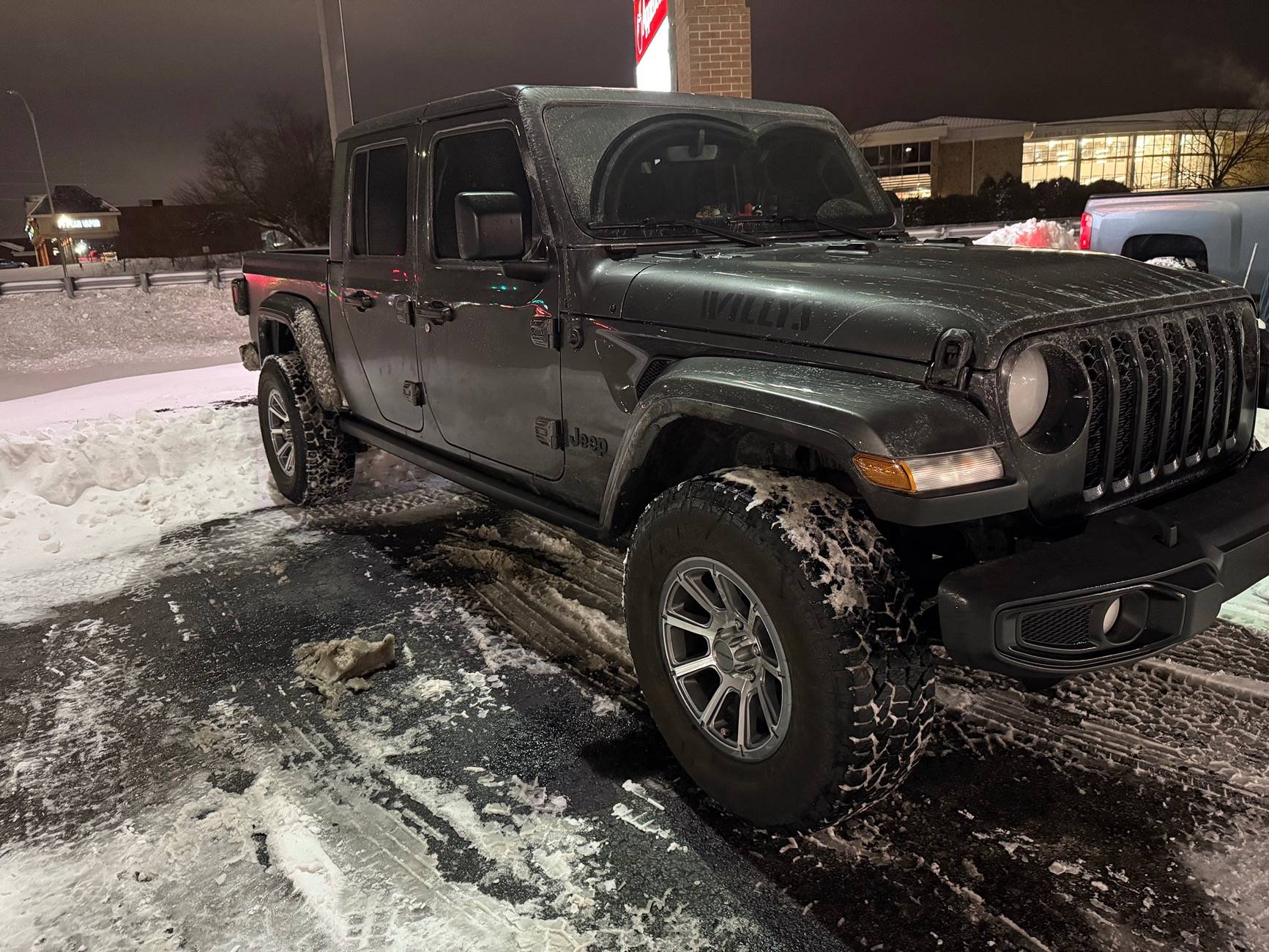

Bought a 2022 Willy’s and threw on 285/70r17 tires. I’m not rubbing, but just seams low in front end. Far as I can tell everything but wheels and tires are stock. I had a 21 two door and it set fairly high for stock. So the ? Is does this look right for a Willy’s front ride height?

Willy has a fairly pronounced rake
Looks normal. But a full profile pic would be better.
Rubi and Mojave sit nose high.

Most stock JTs run about an inch lower in the front; they make leveling kits to correct it if you choose to

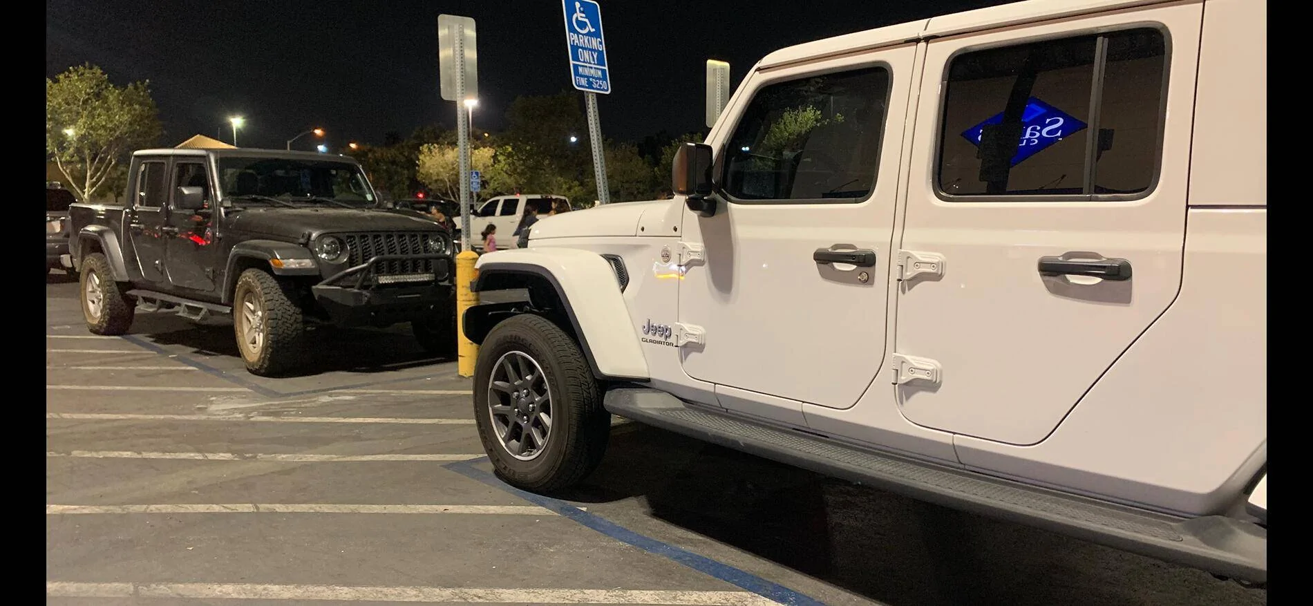

Pretty much your Willys on 33s with factory rake vs my overland on 32s with 2.5” spacer in the front. That’s about what you can expect. If you go too nose high in the front you can add some Daystar 3/4” spacers in the rear to fix that problem.

It’s all an illusion. What makes the non Rubicon/Mojave look low in the front are the fenders that are about 2 inches lower in the front. Put Rubicon front fenders on your Willys and it will look level.

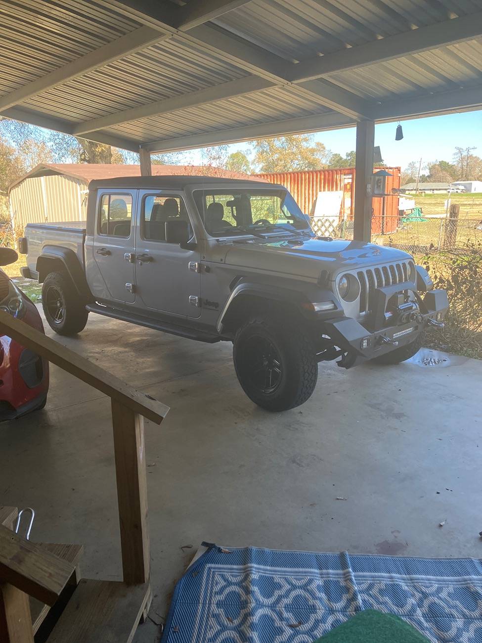

I have a sport add winch and steel bumper didn’t like the sag add a 1 1/2 inch spacer lift
That's a fair statement
