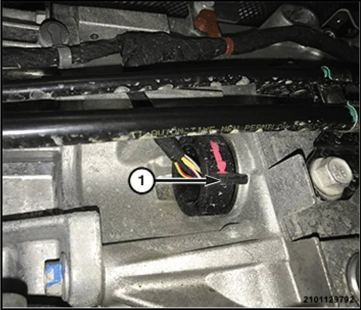

I am going to use a bit of logical deduction thinking. Since you did not have problems until after you washed it, I am going to assume water got pushed into some electrical connections.
As to your gear selector solenoid codes, I would look at the connector going into the transmission and take it off, blow it out both sides and a spray of electrical contact cleaner for good measure and reassemble. Attached is picture of the connector on the transmission, it is a counter clockwise off style.
I have also attached the transmission wiring diagram for reference. The Transmission Control Module is what is inside the actual transmission and what the electrical connector I previously mention hooks up to. The Electric Shift Module shown is your physical gear selector in the the cab.

Thanks,
I will take a look at the solenoid fix you suggested.

i tried to reseat the connector on the transmission...its hasnt helped.

Hi guys,
Update...
1. I reseated the pcm board connectors (gpec2) sprayjng them with wd40 and that seems to have stopped the recurring check engine error
2. Jeep called me after having the car for a few days to inform that the transmission is cactus and is to be replaced under warranty
