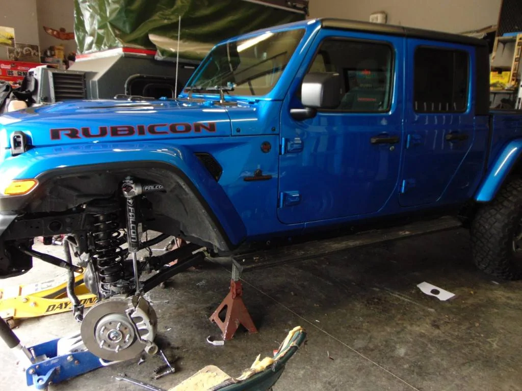

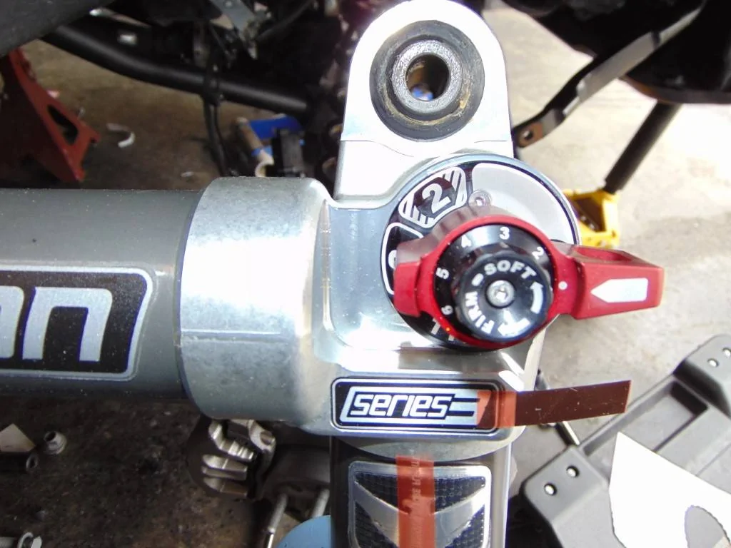

I don't have any scientific testing method in mind. I think I'll just fix things I see now, then take it out on a trail ride and see what works and what doesn't. I suspect this Clayton kit is going to be outstanding, especially with the Falcon shocks. Adam the half-owner of Clayton sent me both sets of rear springs. I installed the standard springs but may drop in the Heavier duty offerings. I was going to do a GF2 or even an Alu-Cab and that would require a bit more spring out back.

As far as the Clayton springs are concerned, the ones you are talking about look and feel heavier. I think they stand just a little taller as well. I think I recall Adam saying that if I installed those springs in an unladen truck it would be more like a 4"-4.5" lift and would ride rougher.

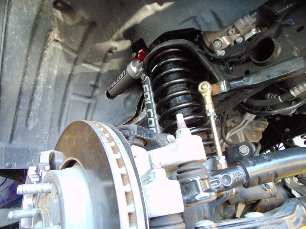

When I relax the rear axle like it was on a lift, the rear droops so far that the springs actually come out of their top pockets!
I am thinking I may have to do something about that...
I saw a comment or two where you mentioned talking to Adam - did you run this question by him? I would expect he'd have some good answer ... or he'd start working on one if he hears that it's a problem.

They are monitoring my posts and already have seen what I posted. I plan to follow up with a short call to trade ideas with them. Great people to deal with...
