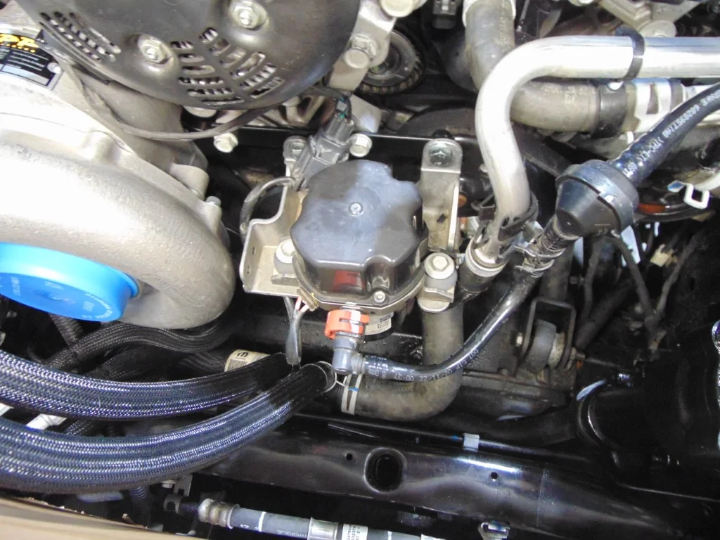

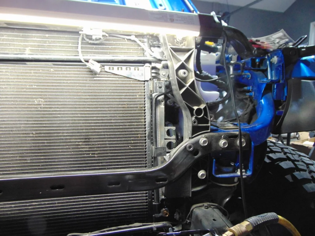

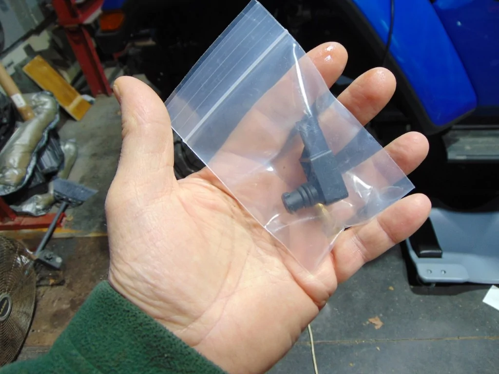

So, supercharger stuff: I removed the stock air density thig-ah-ma-gigger and tossed in the 2-bar Ripp-supplied piece.

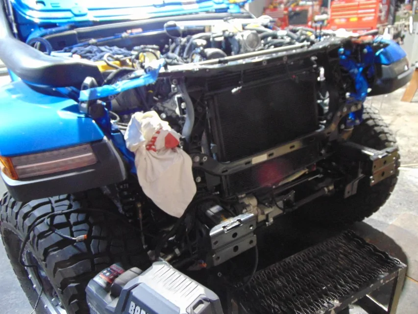

And F I N A L L Y I got to bolt in the actual Vortech supercharger unit...Yippee!!!
I know, crappy picture...

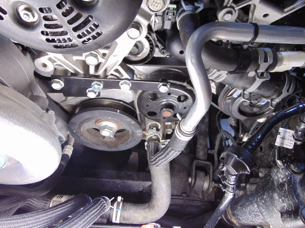

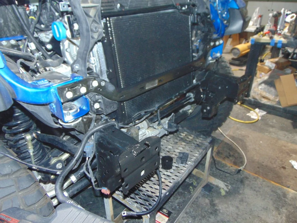

Routing that belt onto the supercharger pulleys (yes, two) was an act intended for Houdini, not a normal human. You can't see anything, so for all I know, I might have the belt routed around the dip stick!
Anyway, the supercharger bolts in very securely with four bolts. After the Houdini belt trick, I bolted in the air pump, which is positioned about 1.5" closer to the driver's side, thanks to that black Ripp bracket

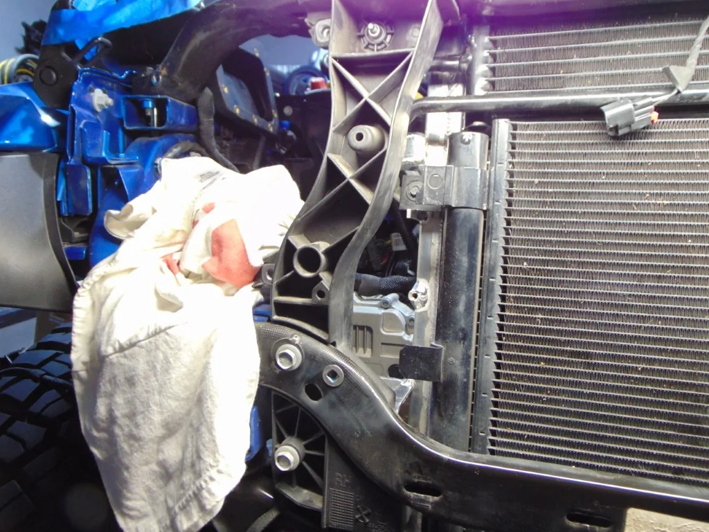

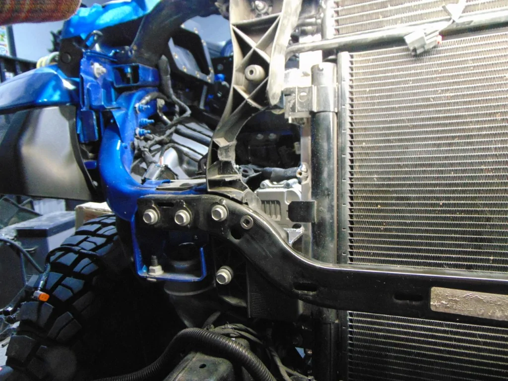

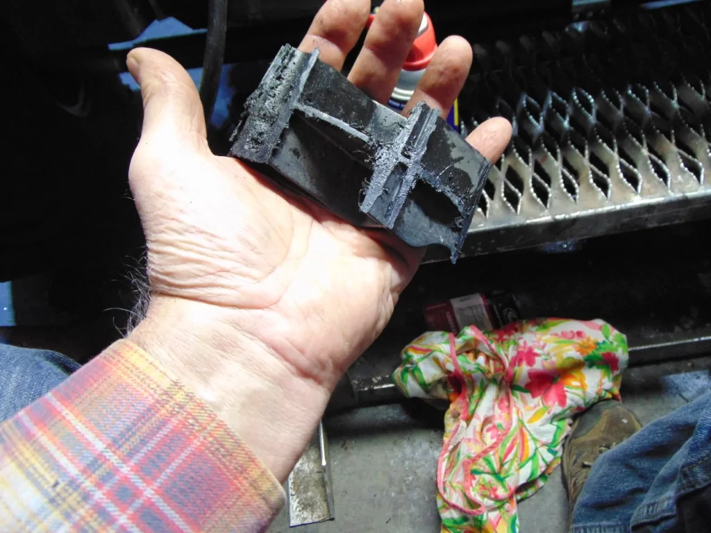

After that I did a couple of skin grafs to repair the damage to my hands and then reattached most of the things on the top of the motor.
Once that was done, I pulled out the air saw and got after the grill support which needed a couple of recesses carved out to fit the intercooler.

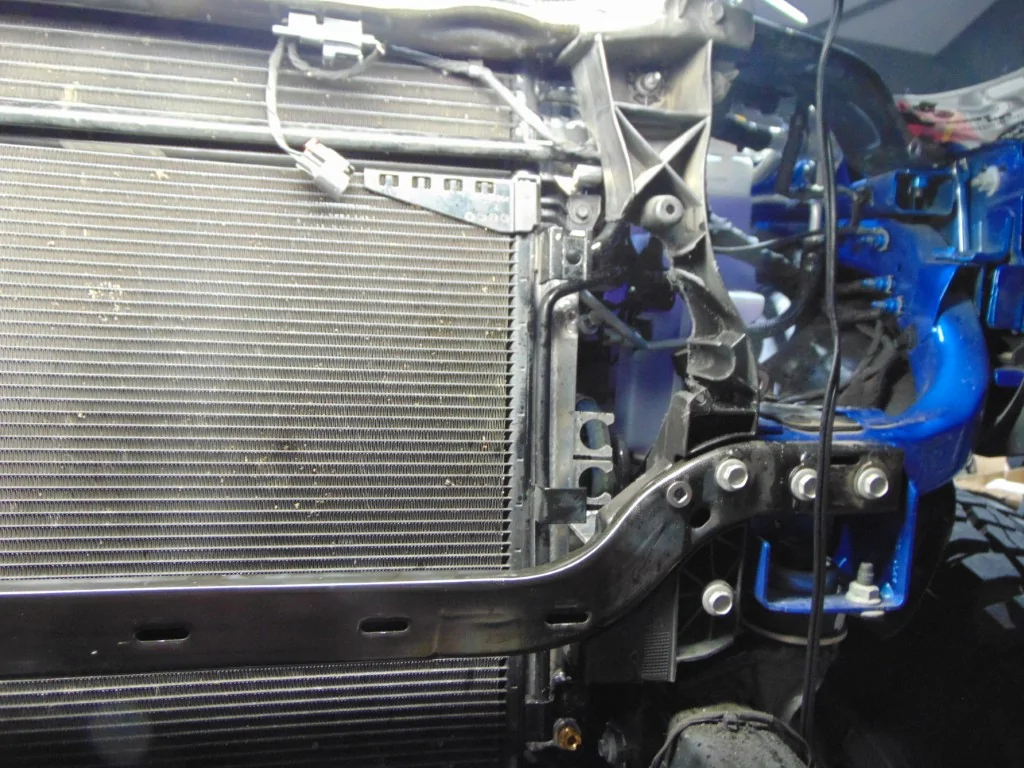

There really is not much material to remove

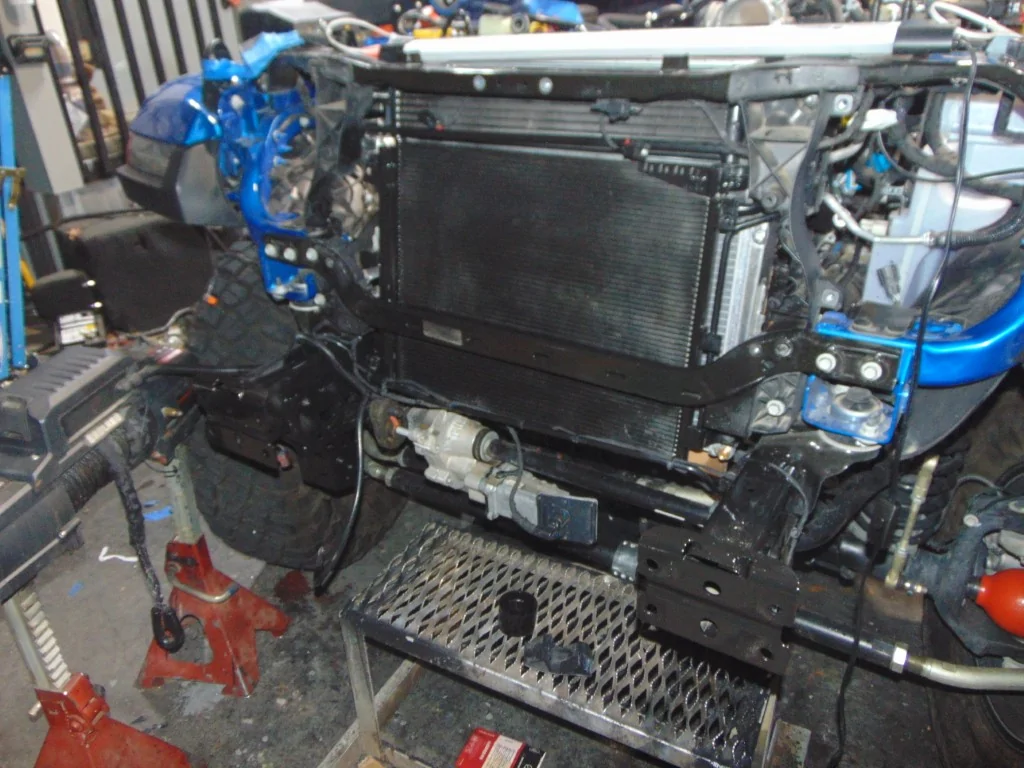

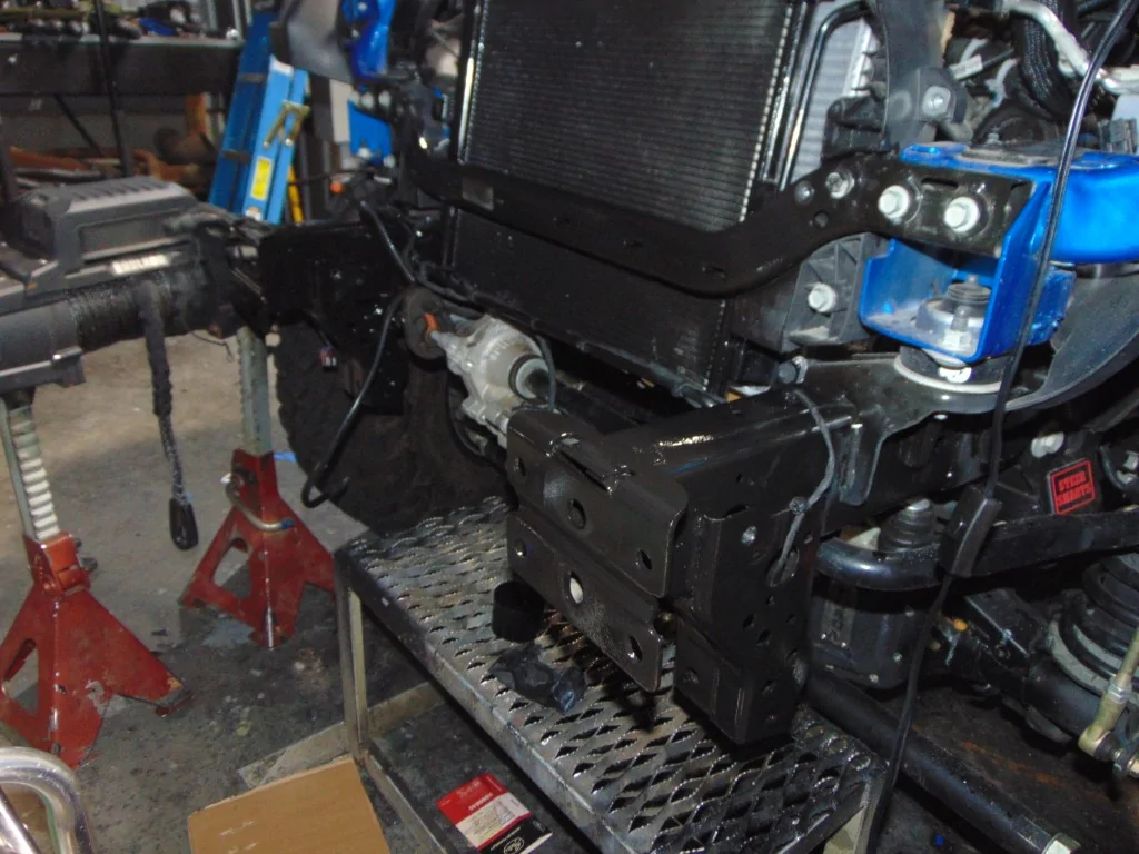

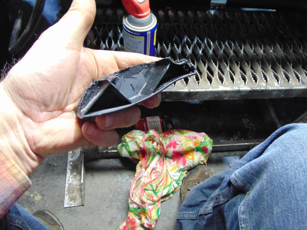

I dressed all that up with a file, taking care to round off all the corners.
Next, I cleaned the whole front end and applied a fresh coat of paint. That can dry overnight and be ready to accept the intercooler tomorrow.
