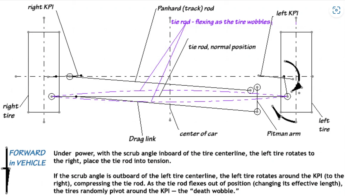

They are finding bandaids to resolve "death wobble" - not fixing things.
It's what a lot of Youtubers do - hey, I found THE solution! "Found" - like no one else in 60 years has ever thought of that............. and DW has existed long before "Wrangler" and "Gladiator" (in current incarnation)
Jeep Gladiator 2022 gladiator death wobble 1673983421950
This echoes every college text and HS paper I have, as well as other tech info. So they are countering decades of "conventional wisdom" and engineering.
From a book on this very topic -
The front wheels on most rear-drive road cars benefit from a touch of toe-in. It compensates for the road force that can induce a toe-out condition. Toe-in also eliminates lash in the various components, which enhances straight-line stability.
Gee, eliminates lash - that's what that outfit says toe-out does.
Toe in takes the slack out of the parts, makes the vehicle handle better around corners, and compensates for road forces trying to pry the tires outward.

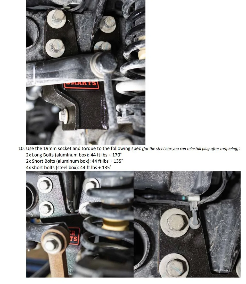

I don't recall the specific torque specs for the steering gear to frame bolts, but I had them at one time and did a check on my 2020 - and it was a torque plus degree spec and I got about 1/4 turn more out of mine using the FCA specs as the techs have access to.
I was just checking as I wanted to cover all bases before going back to the dealer about it.
As posted above this post - any deflection is bad and some have actually made videos of the flex when the steering wheel is turned and the truck is stationary - not even on large tires. Larger tires = more stress/pressure when turning so flex with stock tires leads to much more with bigger tires.
And I've found with weight on the front of my truck, I can make the PS pause - take a second to actually assist in turning.
Flexing steel leads to stress cracking - time to look into that part of it as a problem, even if it's not "the" cause of DW in your specific case - it ain't good and imagine how that steering gear is moving once DW starts..................
Yes I am installing a steer smarts sector shaft brace this weekend. I had actually found the steering box bolts a little loose a couple weeks ago and was hoping that was it. Had my wife turning the wheel because I could hear it. It was the steering box flexing off the frame then setting back down. Tightened them ( got maybe 1/4 turn ) on each bolt. The noise went away but that was all.

I agree, I have a heavy duty track bar, I’ve installed 2.5 ton steering as well. I knew from the start it wasn’t gonna ride like my 2019 Chevy trail boss. But it still amazes me how it does drive, ride and handle. It’s just that bump at around 35-40 mph that sends it into death wobble that’s getting me. I I don’t mean a little wobble. It will force me to come to a stop completely. It feels like I suddenly went from round tires to center blocks like right now and the whole front end feels like it’s gonna walk right out from under me. I’m not giving up on it though, I love my truck and it’s capabilities.
Definitely get that steering get bracketry and fastners fixed up.

This little bit of deflection caused one of the worst cases of DW I’ve ever seen
Oh yes that’s exactly what I am seeing in it, probably a slight bit more. Not slop, just the steering box in itself flexing on the frame. But on a side note, it got up to 60 here today. It was 49 when I left for work this morning. Never did it in any of the places it normally will at the speed it does it on my way to work or home ! I’m thinking the cold shrinking the metal in the gear box and bolts causes the deflection to be worse ! Definitely something to the cold effecting it as well.

Most likely the bolts and threads themselves. Bolts are stretched when properly installed and are not be reused
