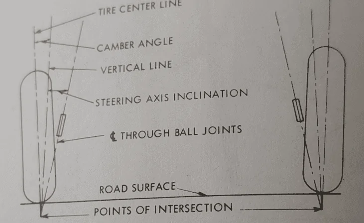

Good starting point.......... but there's a reason they use degrees in most cases these day. 1/8" toe in measured on a 32" tire will be a lot more when measured with a 35" tire and yet if you reduce the toe-in with that bigger tire, you may cause issues.
Bigger tire, wider tire, center of tire out farther than the line through the king pin, they want to force outward even more than stock.
Starting with 1/8" in is a great spot to start.
In any case, 0 ain't good unless you have weird circumstances that cause the tires to want to toe inward, and it happens depending on the changes made.
If you change tire diameter and nothing else, you shift the point of intersection to above the road. (as these have minimal camber, that line isn't as exaggerated as in this image)
Change wheels and you move the intersection below the road by moving the centerline of the tire outward.
