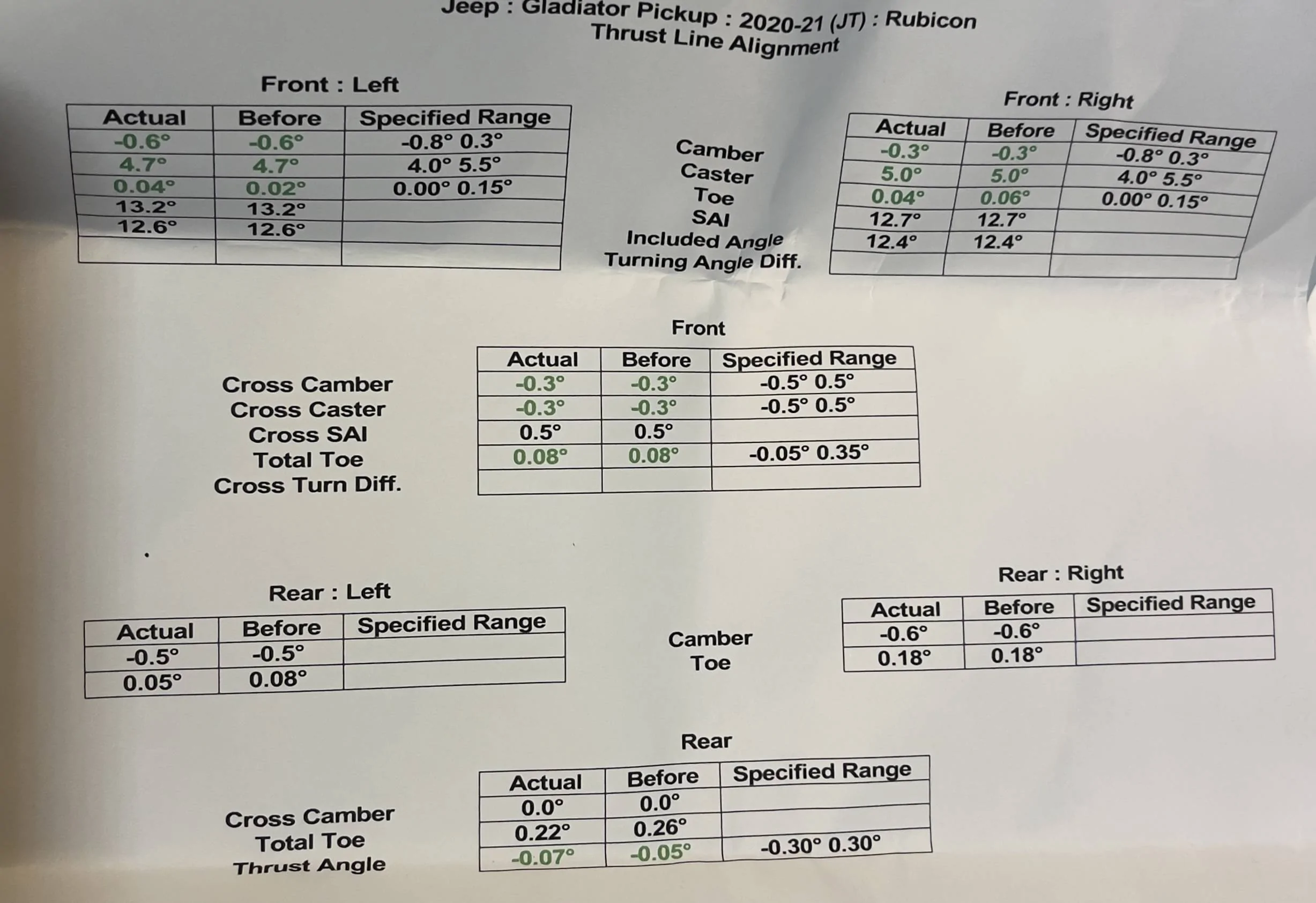

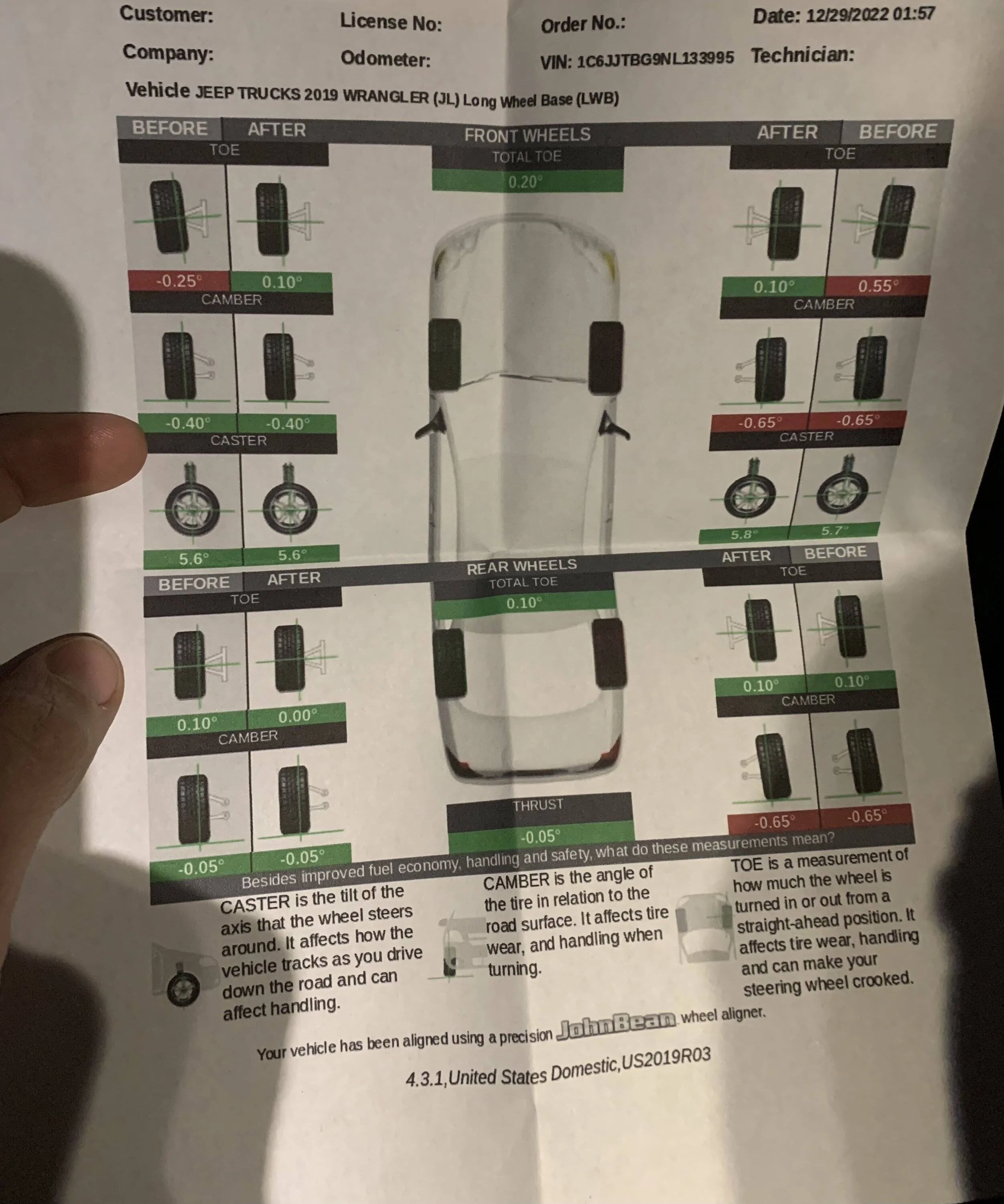

Here’s a photo my most recent alignment that got everything dialed in very well, hope it helps some.
My bet is either alignment, the track bar, or something weird with the wheels. Maybe the difference between my wheels at -25 and yours at that little bit more offset is the straw that broke the camels back. I’d say find a Jeep buddy and swap wheels, see if the problem replicates. Simple enough thing to try just to rule it out.
Let me know if I can answer any questions about my setup, I’m happy to help ya ??

Did the give you the cross measurements? I don’t see them on your Print-out like I do on mine.

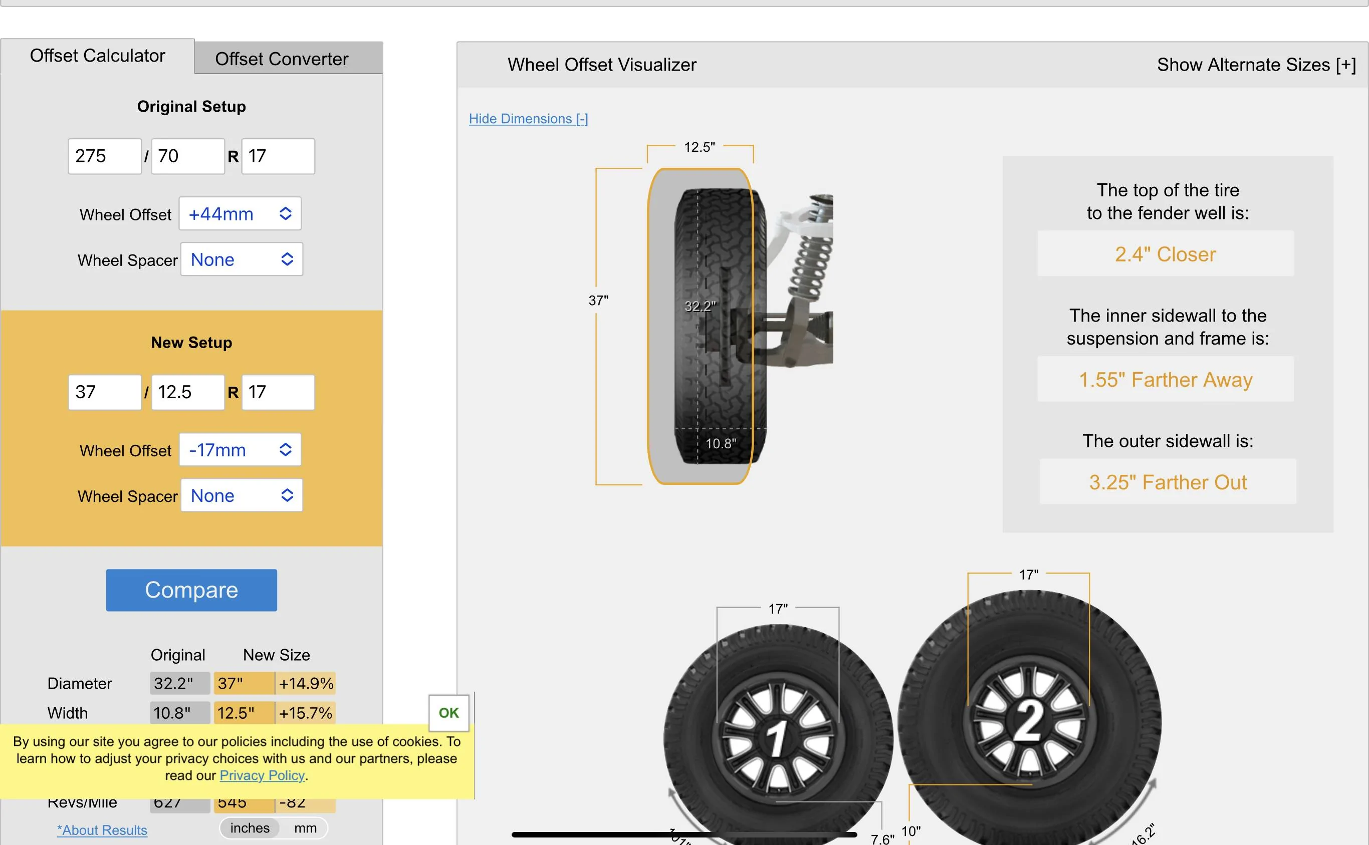

That's my theory. He was closer to DW then he realized. Then when the cold temps hit and rubber stiffened and metal contacted, he crossed the line.
I can't imagine putting that much off center out from the hubs. My Mojave comes with +37 on 7.5" rims and with the 2" AEV lift plus the 1.5" on the Mojave from factory, I could easily run 37's as is and probably 40's with zero offset.

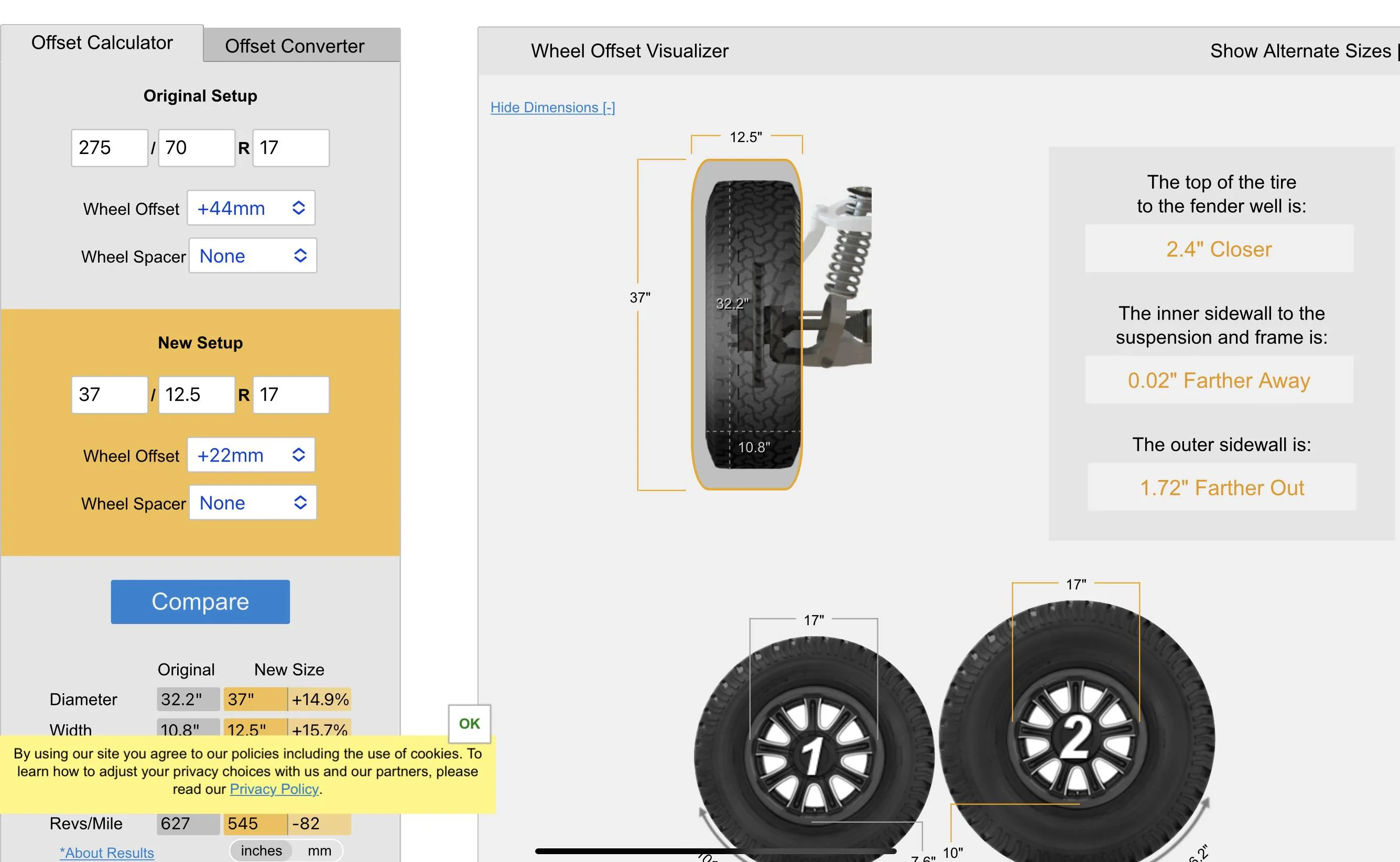

Yea this wheel offset calculator was my “go to” when purchasing wheels, because i wanted my new offset/tire width close to stock as possible. It looks like +22 will get OP closest to stock. -17 looks dangerous.
