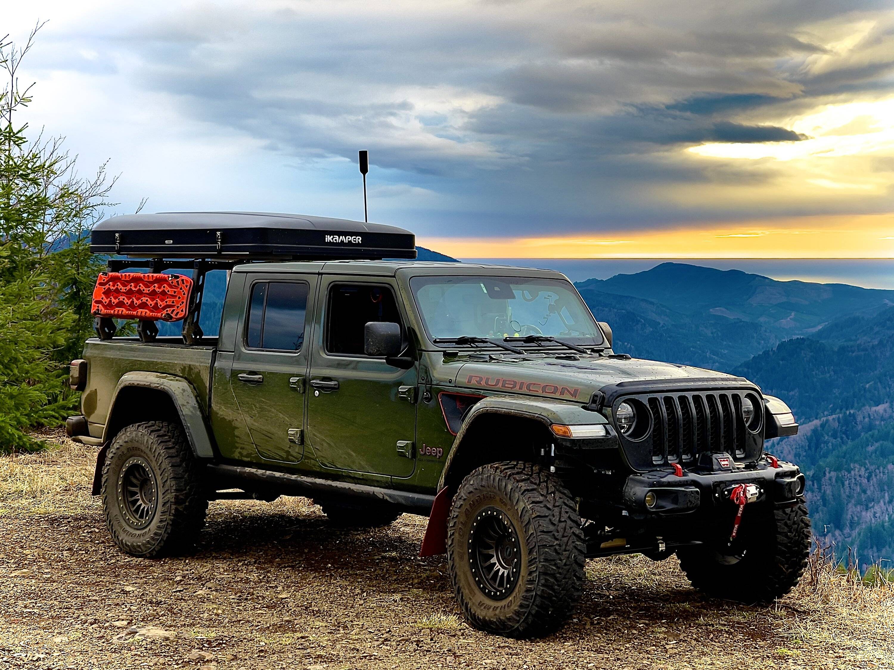

Well with my -25 offset l will happily test your theory. No way I’m changing these wheels, my rig is perfect the way it is. Drives 10x better than stock.

It works for your individual configuration and combination of parts and changes. Can't say it's ideal for any Jeep. It works for you and your preferences and the other stuff you've done.
People act like things don't work together and parts can be thrown in with no consideration to what is being impacted.
