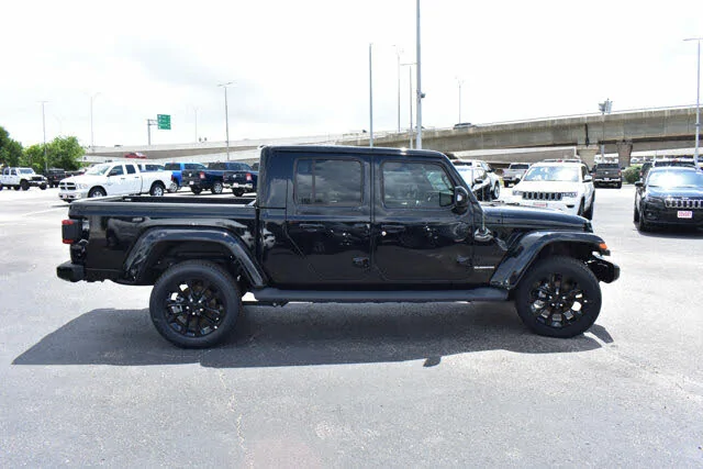

I just purchased a Rough country 2.5 leveling kit for my 2022 Jeep Gladiator high altitude. My question is will this leveling kit level my jeep or will this give my jeep a rake from the front. Has anyone here with High Altitude trim install a leveling or lift kit to their Gladiator High Altitude? I've attached a picture of my jeep while at the dealership before I bought three years go. It's still fully stock no mods. Hoping to have the 2.5 level kit installed this Tuesday.

With my experience with a 1.5" Teraflex level, I feel like it's gonna put you nose high with literally any amount of weight in the bed. Mine sits pretty much dead level right now, but I always have about 200 pounds in the bed of the truck (tools and what not). Worst case you can stick a small spacer in the rear if it does happen.
I did buy a spacer for the rear but it's also 2.5". Maybe I should have gotten something in the 1.5" instead. Do you think a 285/65R20 TKO2 in stock wheel will clear any potential rubbing points?

Did you end up putting a rear spacer?
Sorry, it took me awhile to respond. I was going to until all of the shops that I called for the installation wanted 500.00 to install the from spacers with alignment. I returned all of it to Rough Country. BTW Rough Country are great about their return policy. I might reorder but with the coil springs.
