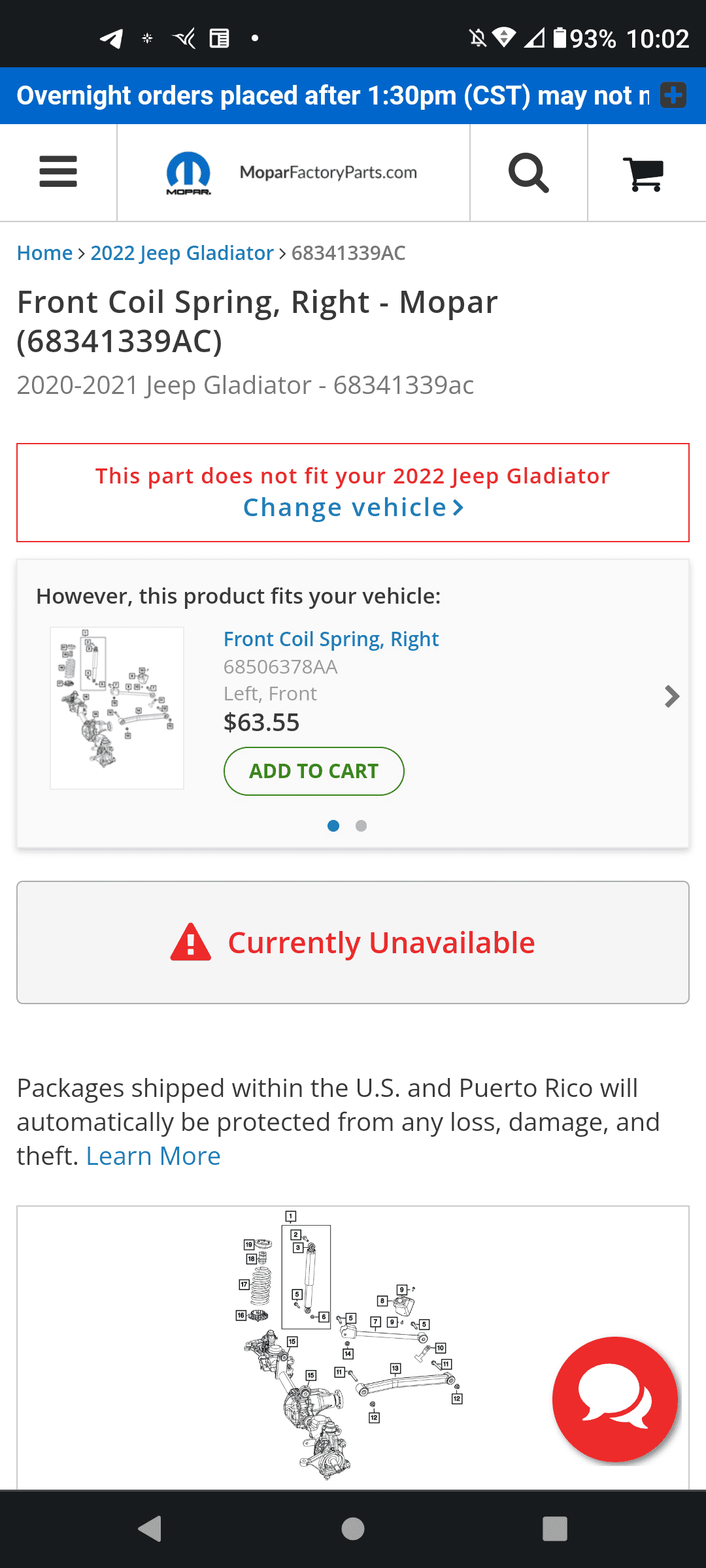

Just wondering why some websites say that the Teraflex 1155300 leveling kit fits my 22 gladiator high altitude and some say no. Like on Amazon it says this does not fit my gladiator. Just want to make sure before i order it. I just put on some 35's on the other day on my stock Gladiator and no rubbing but I still want to level it out .

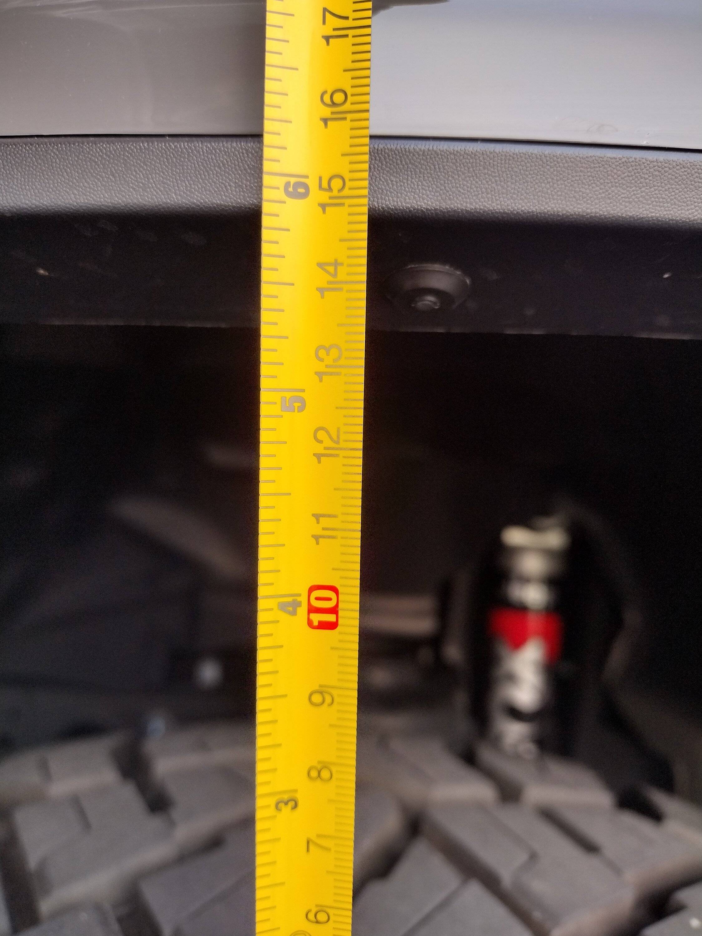

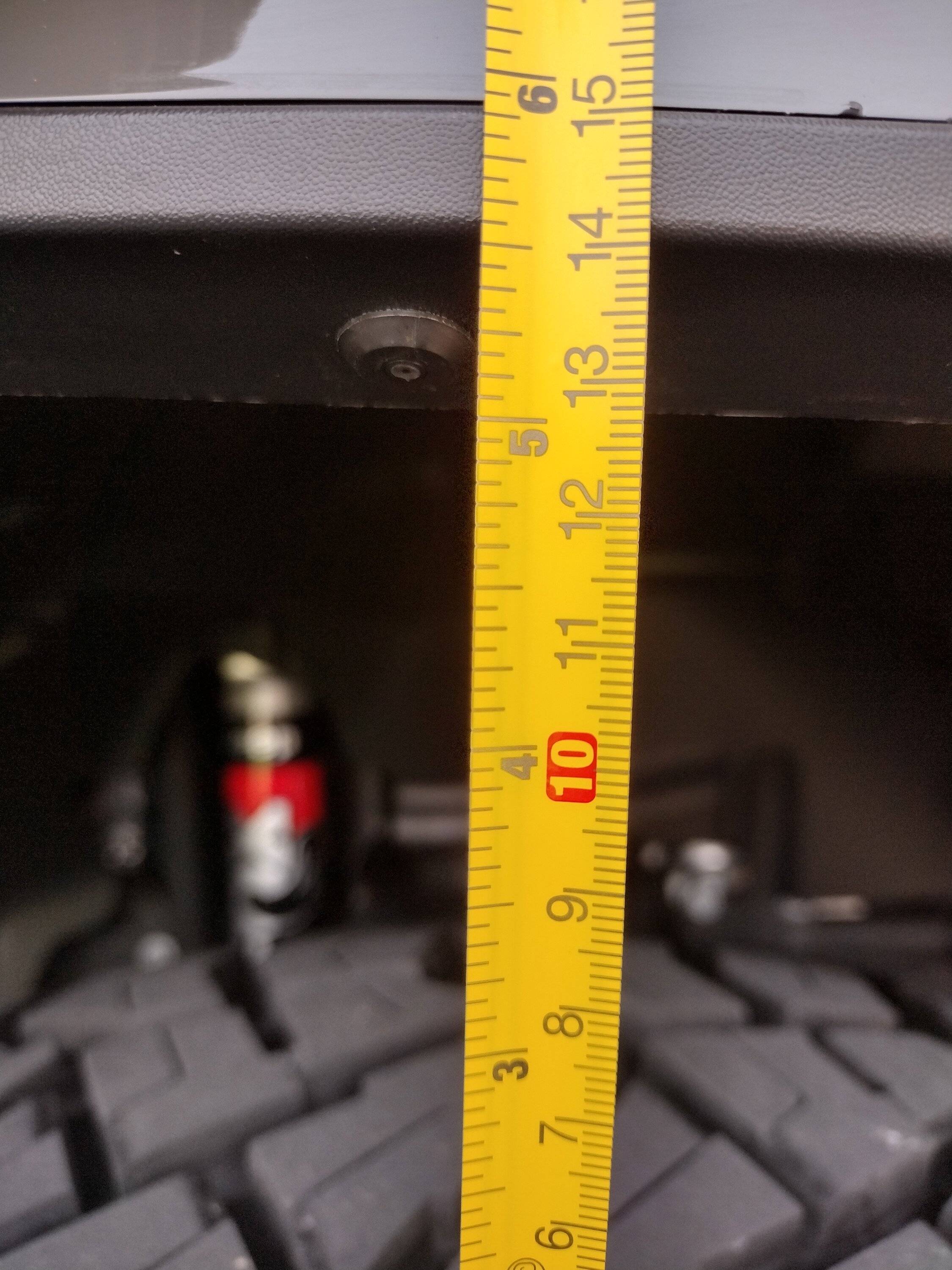

So we put some 21 Rubicon coil springs on today that i bought on marketplace and the guy said they would work but i think they are not the rite ones according to the mopar website. So i plan on taking them off and putting stock ones on with the Teraflex leveling kit. One side is higher than the other as u can see on these pictures. I Would like to know what your thoughts are?

With regard to one being higher than the other, I believe that Rubicon springs are side specific. The Passenger side is longer than the Driver side. Judging by what I can make out for the orientation of your pictures, it seems like you may have the sides swapped, given that the driver side is the high side.
Link to another thread here that discusses this side specificness:
https://www.jeepgladiatorforum.com/forum/threads/rubicon-spring-part-numbers.61316/
I run this kit on my 23 Rubicon and love it.

Thank u much but since the Mopar site said these springs are not a fit for my 22 high Altitude will i still be able to run them or shd i switch back to stock and use the Teraflex? Or shd i swap them to the rite side and see if that takes care of this issue?
I think if you've got the time, swap the sides and see where you stand. Further, are you running full Rubicon springs (front and rear)?

No just the front. I bought front springs and all 4 Fox shox for 150. Thnx

AH, okay, the level kit with just the front Rubicon springs may give you a little squat, but you could always just utilize the 1-inch puck instead of both the 1-inch and .5-inch pucks.

But am i suppose have them 20-21 Rubicon coil springs on there ? Mopar website said it doesn't fit my gladiator but they seemed to fit.
