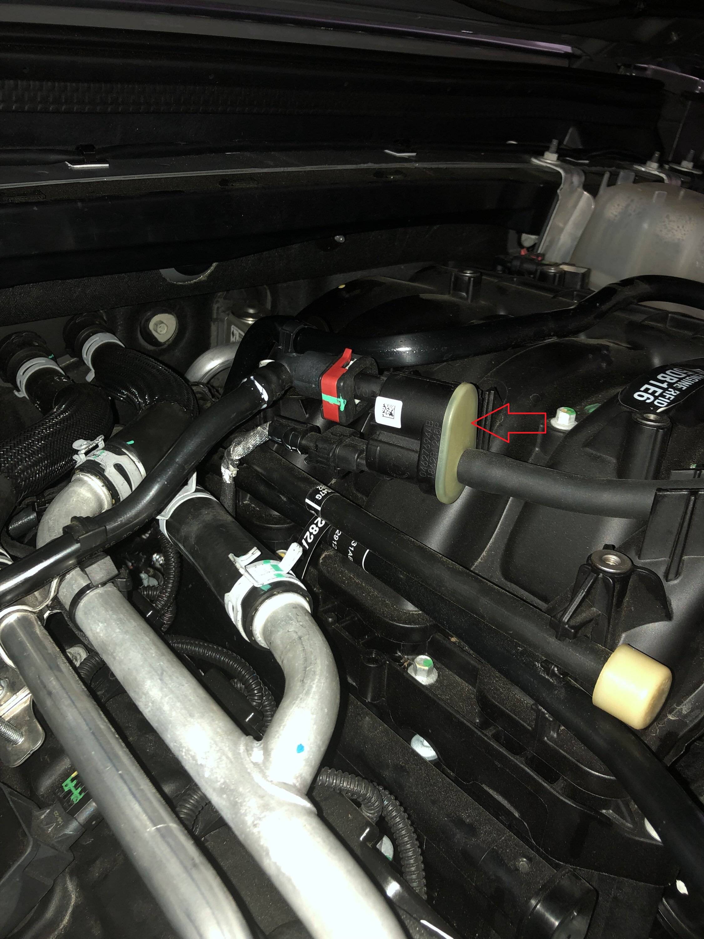

You could check the EVAP Purge Valve under the hood on the passenger side of the intake manifold to make sure everything is hooked up and full seat.
I will admit, not an expert on Emissions stuff. Beyond checking connections and if the code does not clear, may need dealer service and a smoke machine put on it to see where it is leaking. I have heard that sometime even new gas caps will still leak.
