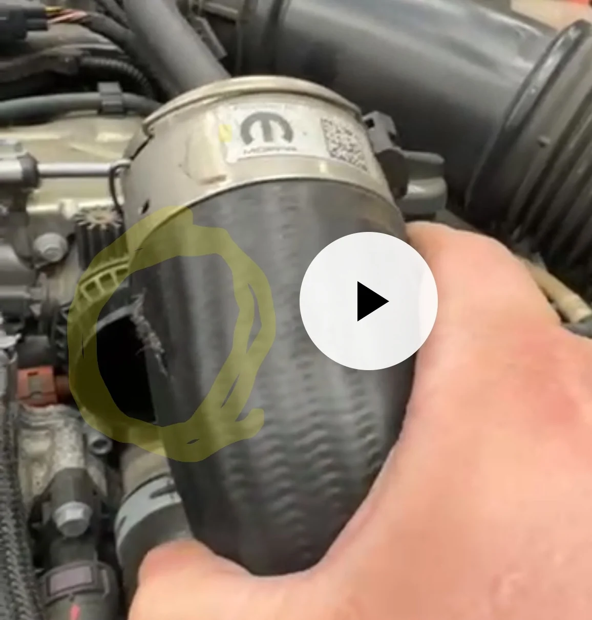

Well stealership found the issue. The Charge Air Tube that feeds the throttle body has about a 1 inch split in it just before the clamp at the throttle body. The rubber must have softened up and burst when I was racing a Raptor, because the code popped the very next day. That Raptor was shook, that a Banks tuned JTRD with canopy, awning, and RTT on 37s was giving him a run. Now, Im having the stealership verify it's warranty work.

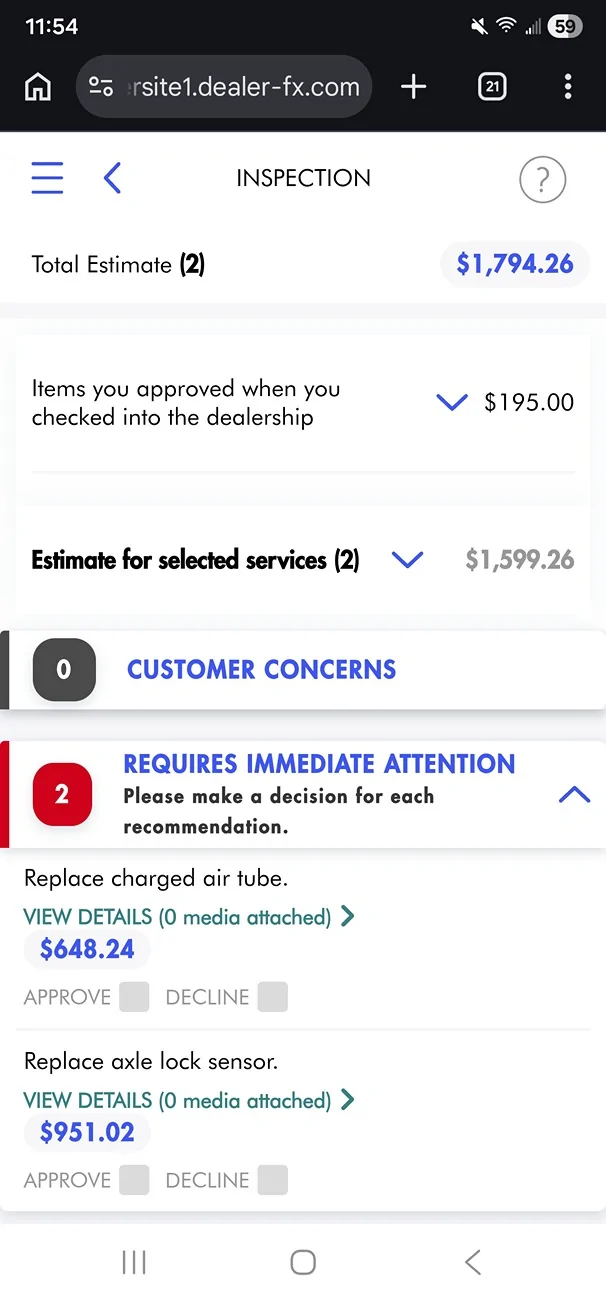

The axle sensor light has been on for a hot 🔥 minute, about 25k miles. I was going to buy the plug in bypass for it.
I tried to share the Dealerships diagnosis video, but the forum doesn't recognize mp4.

$951 to replace hat axle sensor!!!!!???? The sensor kit is less than $100, oil $50-60,and labor shouldn't be more than maybe 1.5-2 hours? Even at dealer prices $951 seems WAY HIGH?
They said sensor is covered under warranty. Charge tube is not. $648 parts and Labor.
