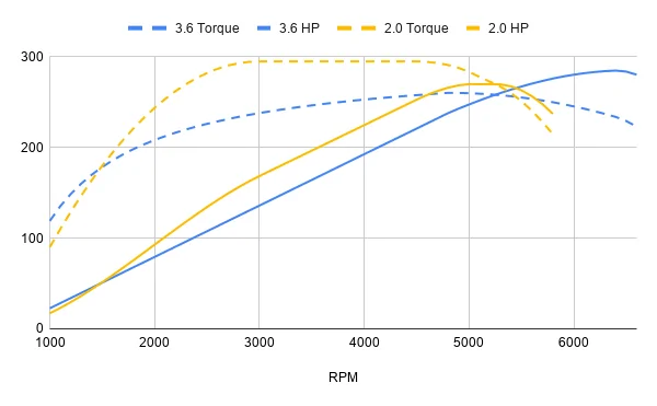

On paper and in measured action the 2.0 is a stronger motor than the 3.6 with a better torque curve (and more torque). It sounds like shit, and it takes more cooling (why it was not in the JT according to jeep), but unless HP and torque curves are being faked, its literally a slightly better 3.6 other than the turbo lag. That said there isnt a huge difference between the 2.0 and the 3.6, they're both pretty inadequate for a 6500lb truck.
There is 1 other plus to the 2.0 as well, it can easily be tuned to be over 300 hp and 350 torque with a flashcal and pcm swap.

There's a problem with ours, then, because I'm so used to driving my JTs as daily drivers I know exactly what they will or won't do, and know when I can make it or not. I assumed the Wrangler could do what I knew my JT would do from years of experience with 'em - and it left me shocked. I could hear it struggle, scream, and wind up really tight - or tried to, but the Jeep just didn't follow the engine sound. It was like I was being held back by something.
Both were times I tried because I KNEW my JT would have done it - and was left surprised by the JL.
We were in our trips to/from Florida so it was purely hybrid mode. There was no "electric mode" left after 2 tanks of gas and hundreds of miles showing <1% on the battery gauge.
So it was total hybrid mode, engine was already running and had been for hours. It just didn't do it.
The HP in your chart is barely different - could be the weight difference as the Wrangler 4xe is a heavy beast for sure. The JT isn't all that heavy without accessories. Maybe the extra HP of the 2.0 is taken by the extra weight of the 4xe's systems.
HP is the work actually done - propelling weight a given distance in a given time, there's not a lot of difference between the two.
During normal driving when both sources of power are working the JLU 4xe does have zip and gets up and goes. But on the highway, stomping it after long drives, it just didn't have it. Around town, slower speeds, getting up to speed, the 4xe wins. Going 60 and stomping it - it fell on its face.
