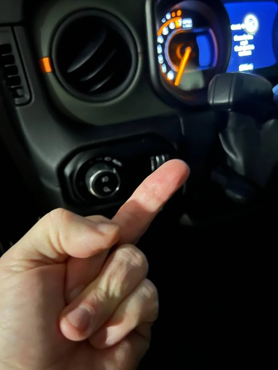

Interesting. In that second to last picture I was expecting to see the wire you need taped to the headlight switch wire. I wonder if they changed it or if it just taped back even further.
@NULL POINTER I used trim piece removal tools to pry off the trim pieces and switch.
I expected the same thing. I'll bet the wire is behind the panel. I don't have the grapes to go after it. I'll just keep stealing someone else's electricity.

Give taking the trim and light switch out to see if your wire is there. The Reddit poster had the wire. I didn't.
NULL POINTER
Carmine
Jan 3, 2024
301
437
Free state of Florida, NW of JAX
2024 JTRubiX Auto, 2019 VetteZ06 7spd Convertible
Loving Life
Okay, I should have filmed this but I need three hands to do this job (not sure where the other hand come from). But you can take off the light switch cover and take out the light switch. Then the JL/JT trim piece. Note that the pins are metal. To be honest, it scared the hell out of me prying them out. You'll need a thin pry tool for all three pieces. The trim piece coms off easily. The light switch cover and switch are another matter. The cover comes off easily but the clips inside make a horrible sound. I thought I was breaking something. There are four clips in the switch and very little room to pry. I suggest staring at the bottom right. It's the hardest to get loose. Pry it out and get a Tim pry tool under the clip, then the top right because the fit is tight and you'll have to move the switch down to get the top clip past the cover. It's easy and doable if you know that they're not the regular clips like on the rest of the trim.
When I got mine open... NO OUTLET WIRE! Ugh! I was under the impression that if you had a 115v outlet in the center console that you had an inverter and the wires were there.
I have been betrayed...
Jeep Gladiator 2024 Mojave X Add Bed 115v outlet 1739645040954-lc
Same here, no wire behind the headlamp switch to pull down to where the switch for the rear outlet goes. Nothing taped to the headlight switch wire. Mine is an April 2024 build, I guess they stopped including that wire and connector at some point before April 2024. it was fairly easy to get to the point you show, I just did it. Had I found the wire, I would have ordered the kit from @AllMoparParts.com . Sorry Benny. Glad I looked so I did not waste $243 + shipping. This would have been an easy mod if the wire and connector were there like on the @legacy_etu post

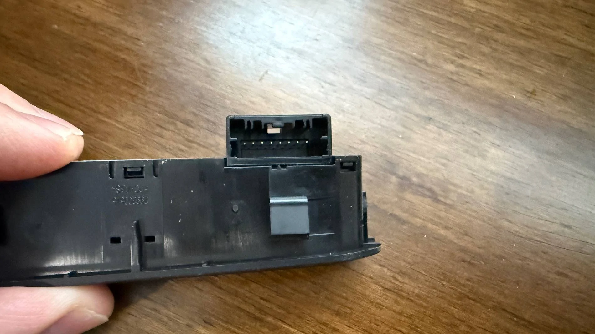

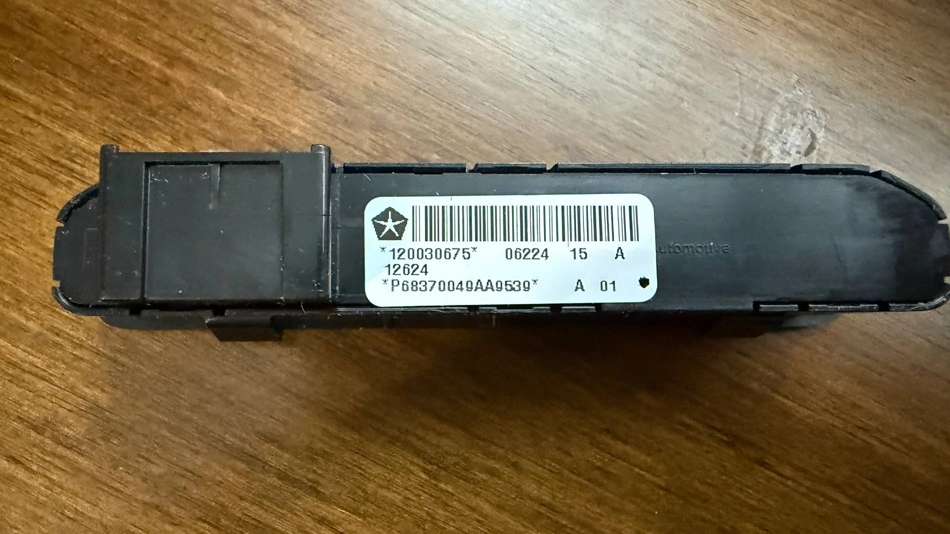

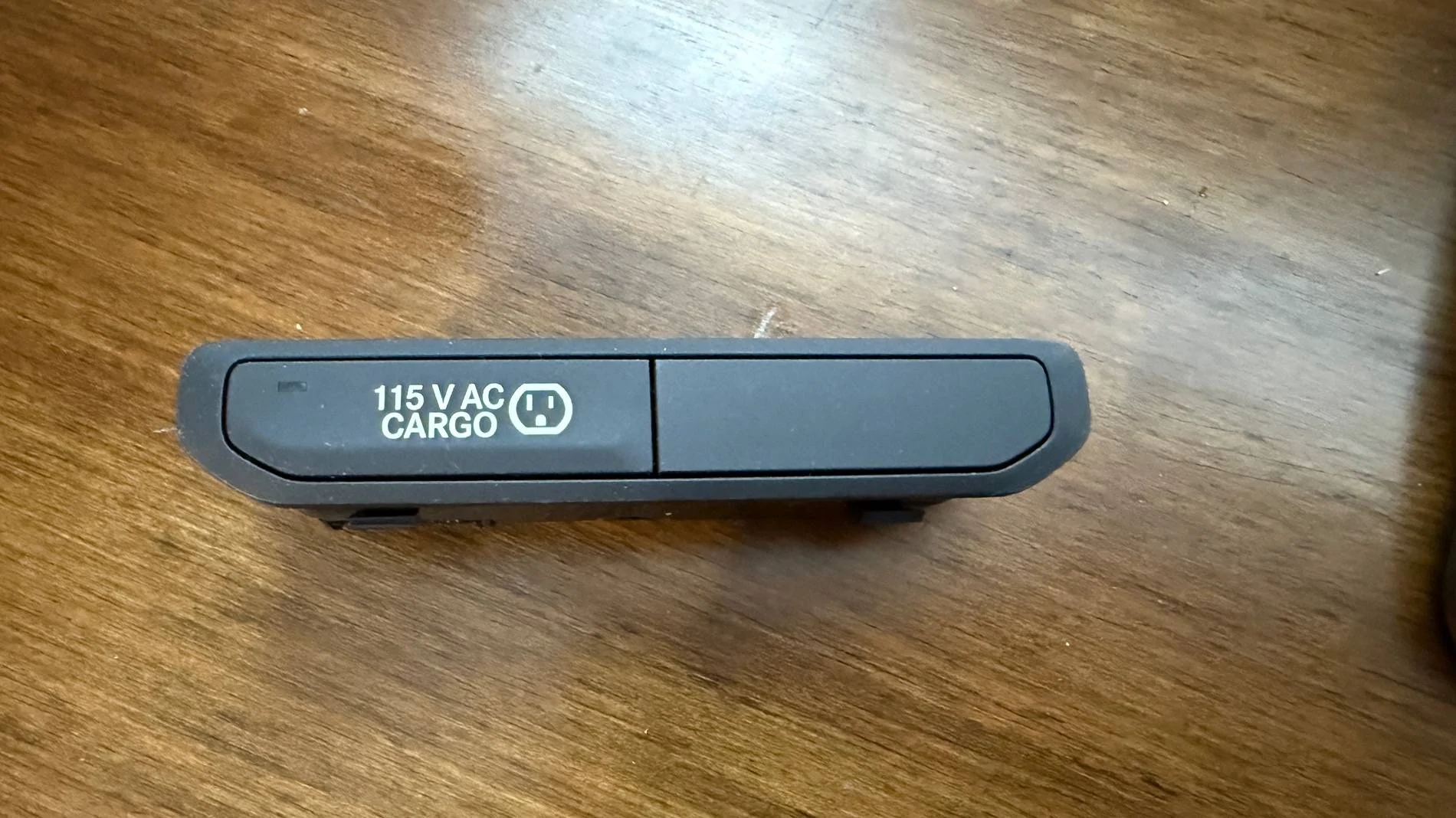

To be clear, "kit" may be a bit disingenuous. I got it from AllMoparParts but it is just a bunch of individual parts they order and package together:
6831-2754AC-001- This is the actual outlet in the bed with maybe an 8" whip that terminates to a 4-pin connector. I suspect this is the same across all years.
6861-6398AB-001- This is the bed harness and it has 3 other plugs on it in addition to the 4-pin for the outlet. Again, I'd suspect this is the same across all years.
The baggie of screws in nut-inserts or whatever you want to call them is in the glovebox and I'm not going outside for them. haha
6837-0049-AA-001- This is the switch. Visually it seems to be the same as the one shown in the videos but pics of this are below.
